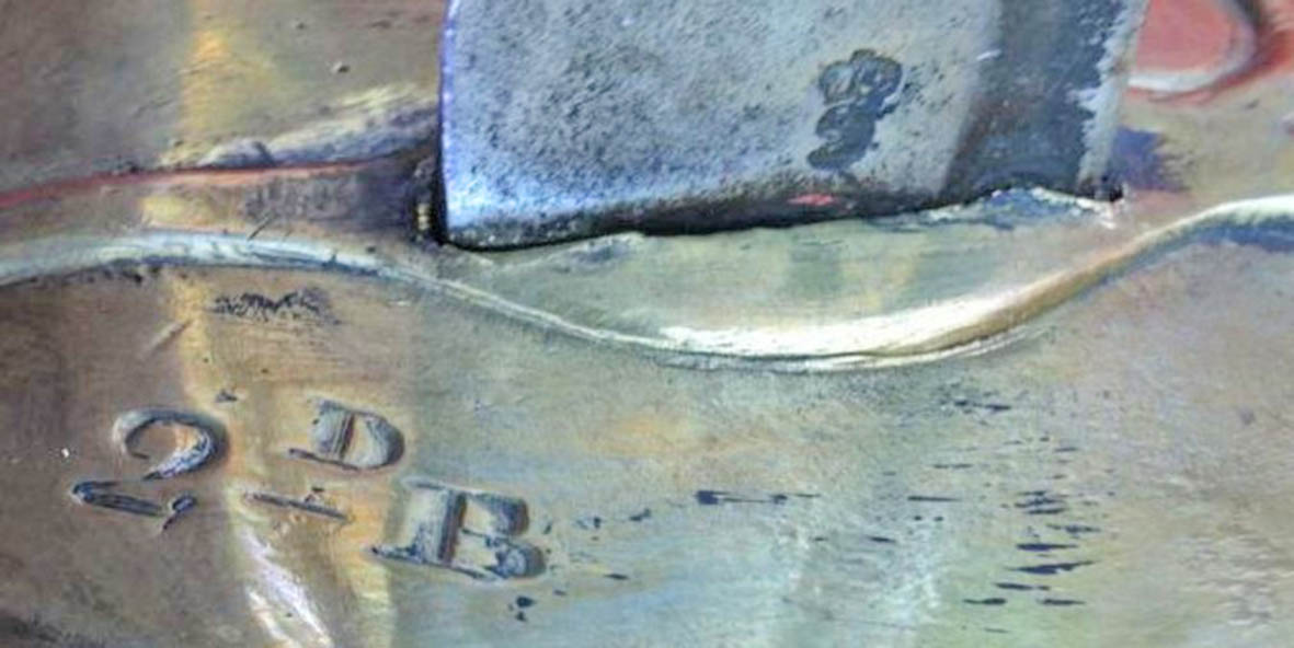

Default non sequeter
I've been told the crown and number 9 is an Ordnance inspector's proof mark; and that the hilt mark stands for 2nd battalion. Can anyone confirm this and possibly expand on this information. It is the hilt of what I believe to be an Oley of Shotley Bridge blade.

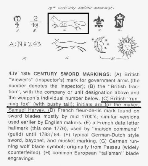

In a further leap~ I question the Colichimarde situation...and the swords imported but initially confiscated when Mohl got arrested. If they were from Solingen they would surely have been stamped...My question being when was a sword stamped? There were a lot of these 1400 apparently but no definite detail of what sort of blades...nevertheless they would have been stamped I suspect...Solingen ! In all the examples seen so far ... and as far as I can see... No Colichimarde examples exist out of Shotley Bridge because they never had a machine capable of such grinding. Although this may not have been the only reason for its demise as other swords were being used...particularly in the Military ...It may have been a factor and why specialists were dispersed either back to Germany or to other English factories like Birmingham.
Post 28 sets another conundrum here... How do swords stamped with the Solingen mark of the running wolf appear with SHOTLEY BRIDGE stamped down the fullers? Are these examples of blades fetched by Mohl already with the wolf stamp or did shotley swordmakers place these ...It may mean they used both fox and wolf... but it seems odd. It is in fact the case that the hilts were often wire adorned in what is described at;

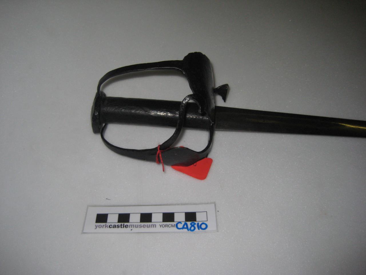

Here is a half basket... as I begin to examine Scottish Basket hilts and since The Crown and Crossed Swords owned by the Swordmakers sports two giant swords as their Hotel Sign under a Crown..
https://www.yorkmuseumstrust.org.uk/...RvcnkmRk49JTJB
Also below for library purposes sword blade marks.

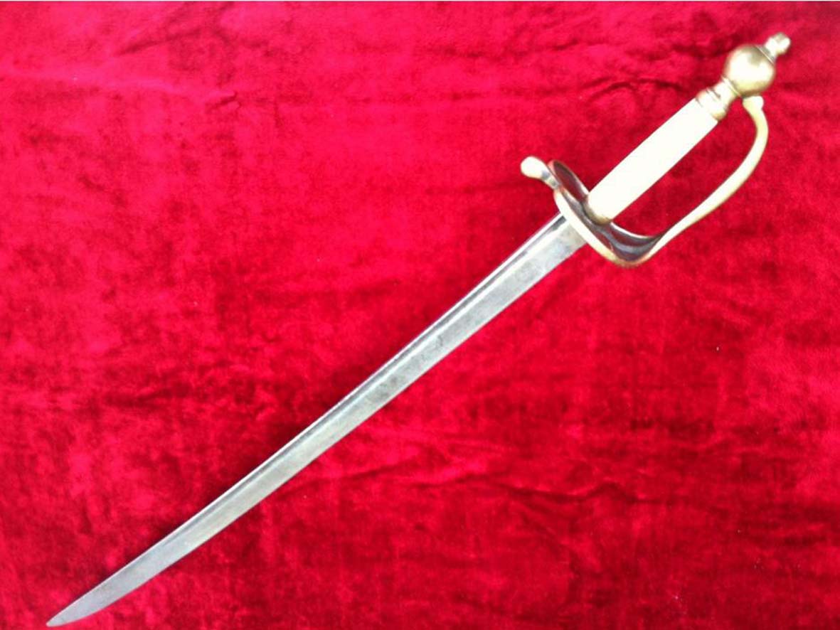

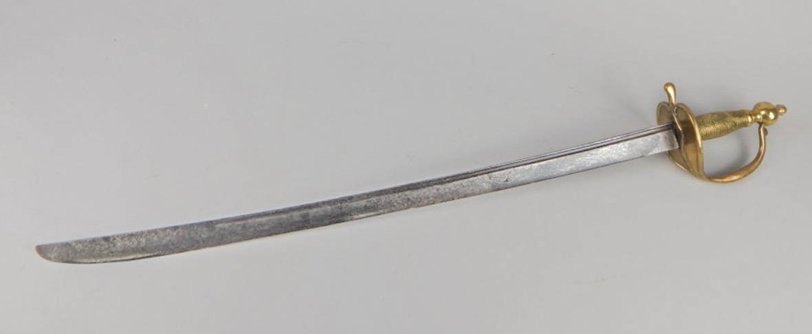

In a bid to tie Shotley Bridge to Scottish forms I need to prove more links and in doing so cite the trade link below where a Shotley Bridge sword is paired with a Scottish Scabbard. It was common practise to have the sword made at one place and the hilt and/or scabbard made at another. There is no picture.
A BRASS HILTED OFFICER'S SWORD, LATE 17TH/EARLY 18TH CENTURY with double edged blade retaining traces of a brief inscription within a short fuller and stamped with the running fox of Shotley Bridge on each side (pitted), brass hilt comprising double shell-guard engraved with the owner's name 'Sir H, Liddell Bt', knuckle-guard, an additional pair of scrolling bars joining the knuckle-guard to the shell front and back, and spherical pommel (button chipped, quilon removed), and wooden grip with later copper wire binding, in an associated brass-mounted lather scabbard, the locket inscribed 'R.S.' on the front and with the maker's name 'J. Hunter, South Bridge, Edinburgh' (worn) 80cm; 31 1/2in blade Sir Henry Liddell (before1660-1723) gained the title of 3rd Baronet Liddell and was M.P. for Durham City, 1688-98, and for Newcastle 1701-5, and 1706-10.

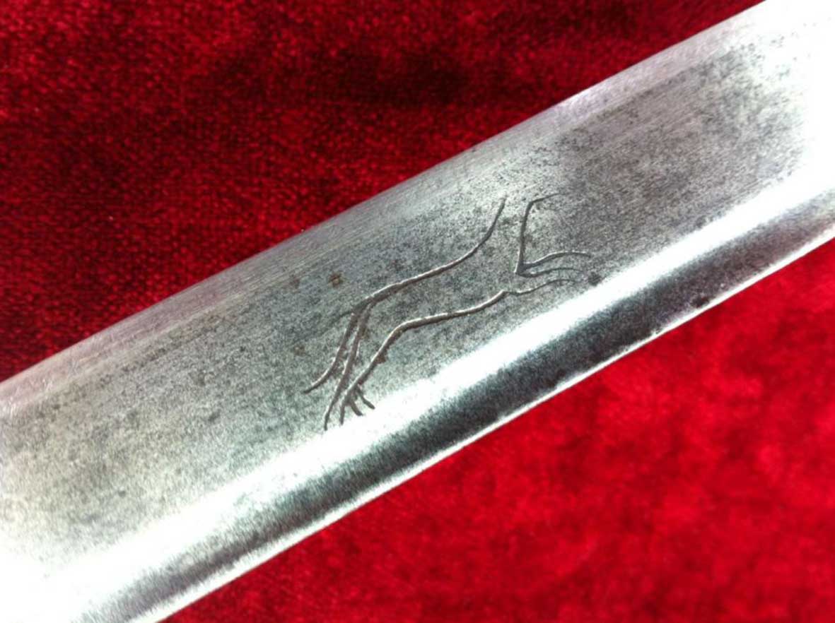

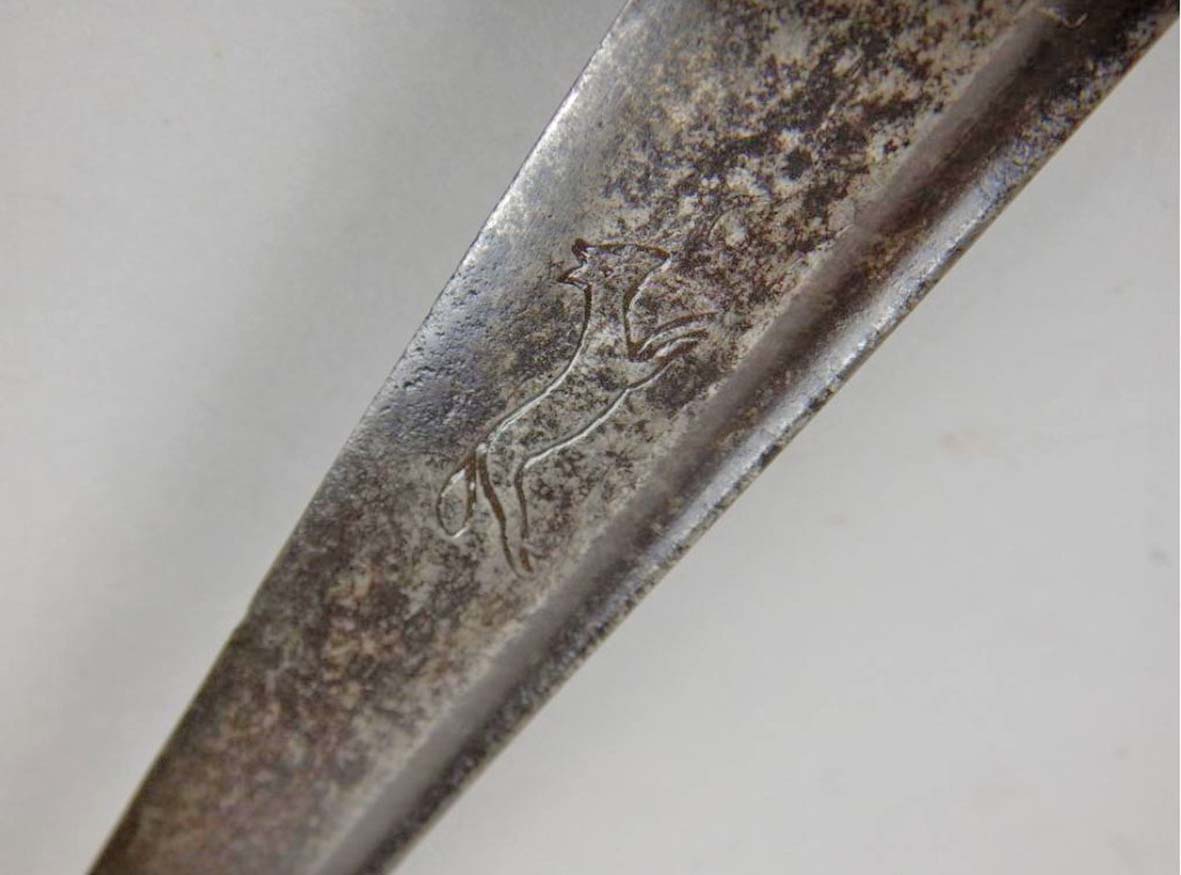

The running wolf conundrum :
It seems that the Solingen applied running wolf was typically an almost chop mark type image, often barely recognizable as a specific creature. This was in accord with the way these had been applied in Passau in earliest forms.
There was little, if any, uniformity in these images, and in Wagner ("Cut and Thrust Weapons", Prague, 1967) the chart of these 'wolf' marks depicts the variation, but misleadingly adds years, suggesting any such chronology existed. It was entirely a matter of the worker applying the mark in nominal form.
Actually, by the time of Shotley Bridge in the latter 17th century, as far as I have known, the running wolf occurring on Solingen blades would have been an anomaly. In my opinion the blades with Shotley Bridge and running animal (looking more like a dog and actually recognizable) were probably finished there, and likely 'blanks' from Solingen.
The later canine figures used by Harvey (and possibly Dawes) in Birmingham seem to be a running fox (note plumed tail) and with Harvey using his initials enclosed. It would seem these were in earlier blades and alluded to the German quality which had been known from Hounslow times and Shotley. Remember that these blades were highly esteemed and still circulating. In later Harvey blades there were various marking with his name and initials but no fox.
The fox may well have recalled Shakespeare who used the term 'fox' to describe a fine sword blade in some of his works, and for a time became a colloquial term (' thou diest at the point of fox').
It seems like there were some blades with Shotley marks which were more of the rapier form with central fuller known on some of the English cup hilts, but I have never heard of a Shotley colichemarde. But then as previously noted, it is really unclear what they actually produced aside from the examples of military backsword or broadsword blades and some hangers.
Maybe somebody out there has seen Shotley marked blades and might post here in addition to those already shown.

Keith, my apologies I entirely missed your post (#36) and the illustration of the hilt with marks. Could I see the entire sword?
These 'regimental' marks on the hilt seem to have been more of a convention of the mid to latter 18th c. in England, though I am not saying such cases did not exist earlier. There was little standardization and such unit stamps were simply applied incidentally it seems.
The '2' with hyper link D and 'B' would certainly be plausible as 2nd battalion.
I am curious at how the Oley attribution to the blade is made.
By the marking crown over 9, this seems indeed an inspection mark, and these are described by Robson in his "The British Military Sword" (1975) but I do not have my copy at hand. It seems these kinds of marks were not used until the second half or latter 18th c. but again could be wrong on that.
If this is as I suspect, a mid 18th century infantry hanger (possibly the heart shape guard known as 1751 due to the Morier paintings) and dating to the Revolutionary War period, then it would be fascinating to see an Oley blade from Shotley confirmed. If Shotley was indeed producing military swords that late, I am curious why it is not included in any of the literature that are compendiums and listings of such makers over the past 60+ years.
It could be of course that old hanger blades from Shotley were remounted just as the case with numbers of blades with both Hounslow and Shotley markings, however evaluation of the sword as a whole is necessary.

Hello Folks. As I have mentioned earlier in this thread, I am still 'on probation' so my postings must pass muster with Mr. Moderator, which means I'm appearing out of sequence.
I posted a picture of a running fox inscribed on a blade with a verifiable probity, as the vendor was from SB and knew the history of the sword i.e. an Oley blade. This style of fox is identical to the one on the blade I bought some time ago. Also, the sword that Nicholas Oley is shown holding i.e. the last blade made in SB by his grandfather (which puts it at approaching 1840) looks identical to the one sold by the ex. SB resident and also to my acquisition.
Non-the-less, in the case of my sword, it looks to me like a poor fit in the hilt, but the blade looks like it has been much used, sharpened and polished in its life, so it may indeed have been re-hilted.
I will post pictures of the verifiable sword first, then pictures of mine.
[IMG]

Unfortunately the images I've just posted are out of stated sequence: so my sword is the one with the bone grip and the faded fox.
