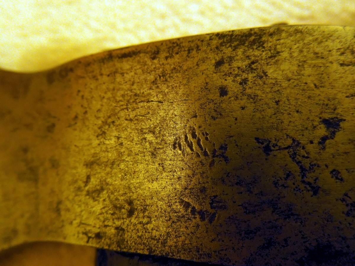

I have recently acquired these two Scandinavian boarding axes but I cannot identify them exactly. They are a similar to the 1780 Swedish model - see picture 3 for comparison - but whether they came before or after, or were private purchase I cannot tell. I would also like to narrow down the country of origin - any ideas?
It is interesting that the axes are still together after all this time and probably came from the same ship. Although, at first glance, they look very similar there are many small variations in size and shape. Even the handles are a slightly different diameter and length, but both have had some black coating which is mostly worn away or been removed. It makes me think that these axes were individually hand made .
The heads were rusted and no clear marking showed up after cleaning off the rust. Knowing my usually flawed optimism in deciphering numbers and letters, when none are there, from surface defects and corrosion marks, I hesitate to suggest that the marks in picture four are the remains of a logo but as similar, fainter, marks appear on both axes on both sides of the head I think it worth risking the embarrassment! Outline of a bird with feathers or tool marks?

Beautiful examples, unfortunately I don't have much to add other than guesswork. I would assume just from the general shape and the fact that they appear to be early cast heads, I would venture private purchase examples, mid-19th, made in the likeness of their earlier cousin. That they are boarding axes seems certain. I know of no fire implements with hafts like these.
