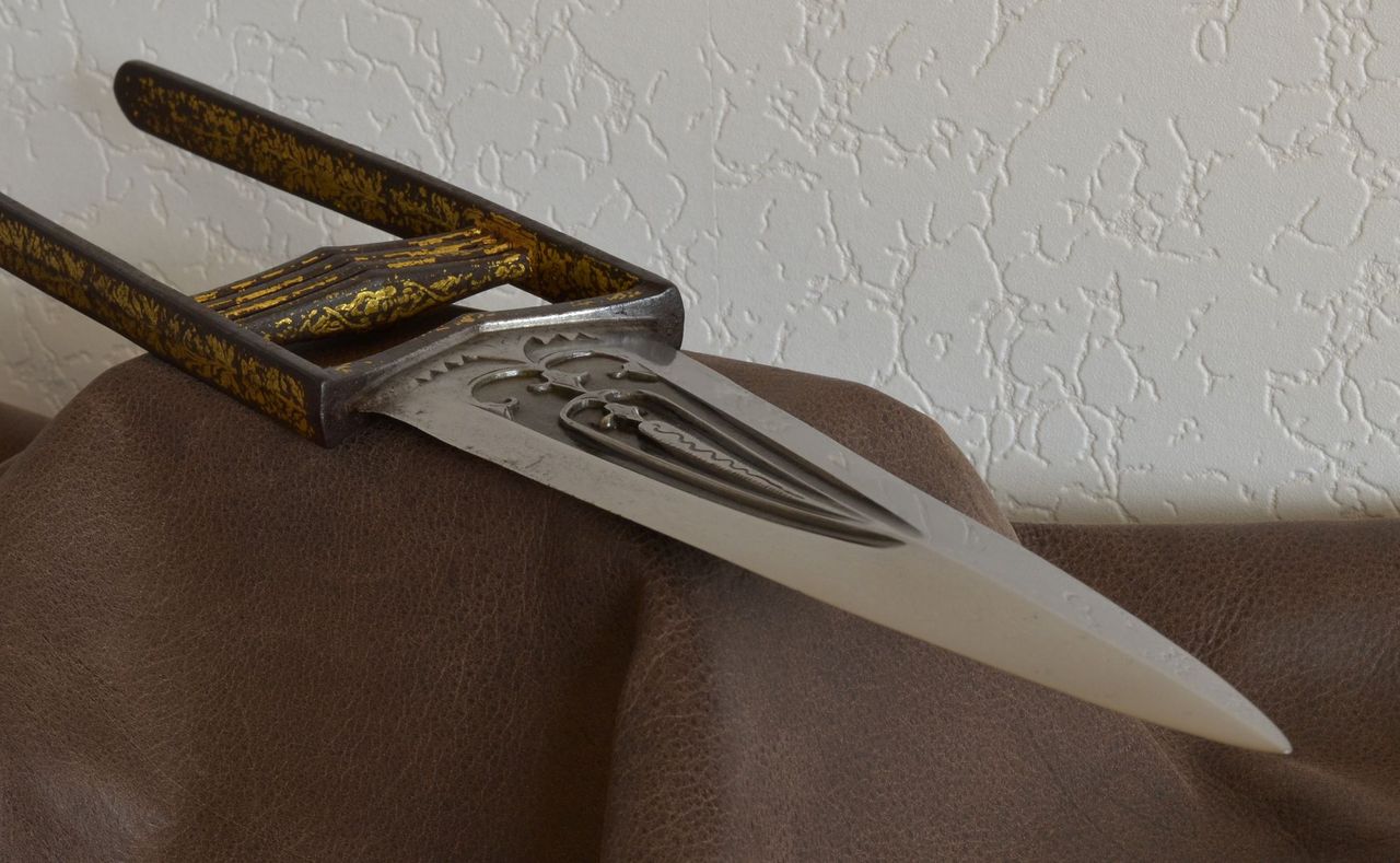

Hello everybody,

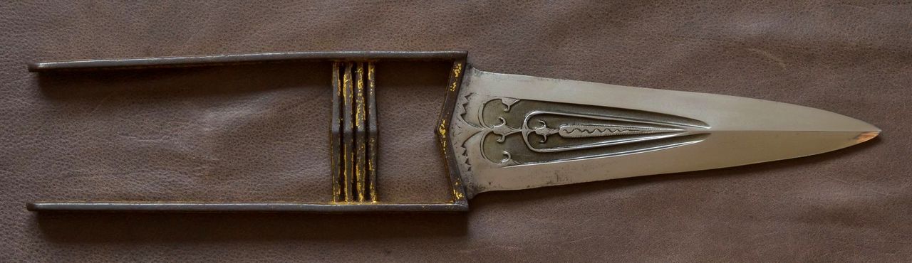

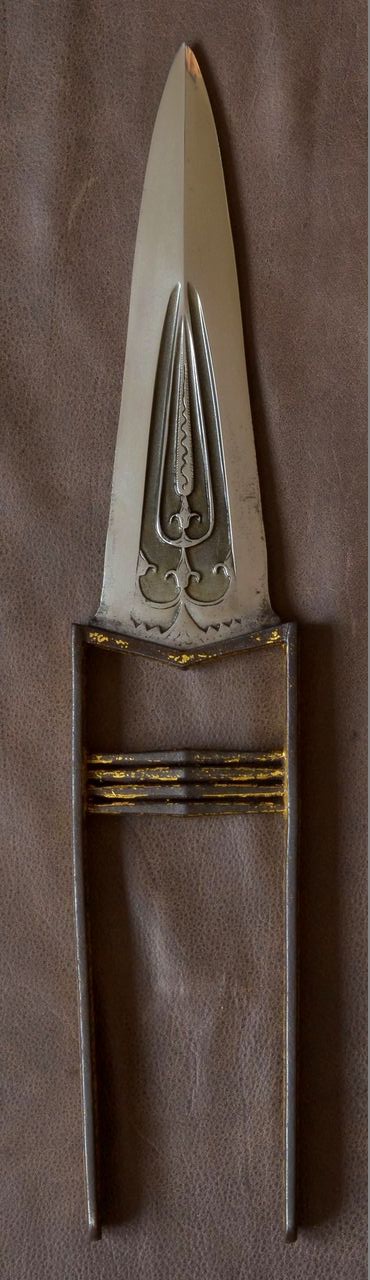

Here is an Indian Katar, maybe the highest quality blade in my collection.

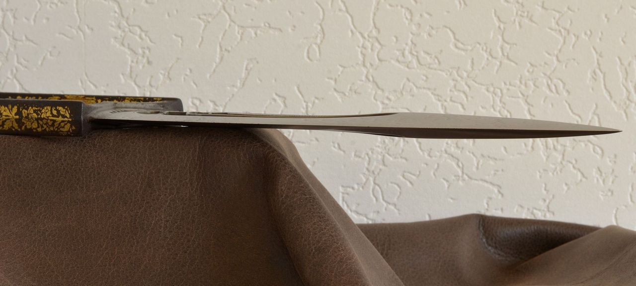

The massive Blade is 23 cm long, 7 cm wide at the base and ~10 mm thick at the thickest point. With a weight 750 Gramm ( 26.5 oz.) this Katar is very heavy. It is more a very short sword than a dagger. This Katar was used very intensively, the cutting edges have many tiny nicks, the point was slightly deformed.

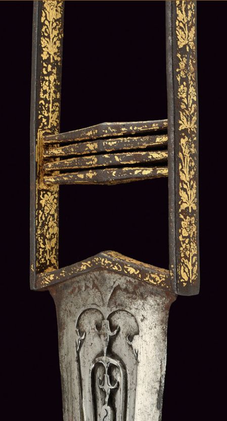

I don’t know how the bars are attached. All I can say is that they are not attached from outside and not glued from inside.
The condition when I received it was a very well base for a restoration. I decided to apply a mirror finish on the cutting edges and a darker finish in the chiseled areas.
The polishing and the etching letting a nice pattern appear, very fine spheroidized wootz.
I added some macro pictures of the pattern.
Best wishes and every comment is welcome!
Roland

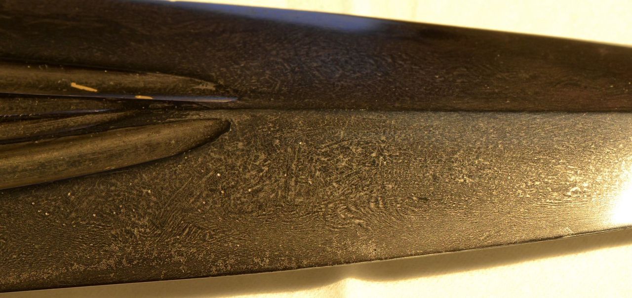

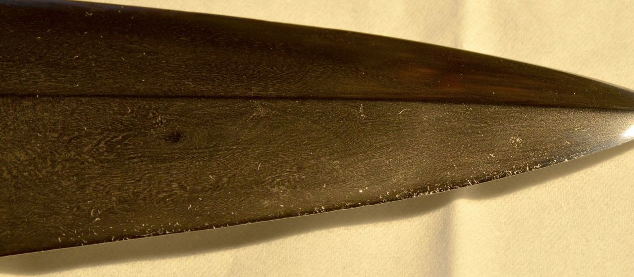

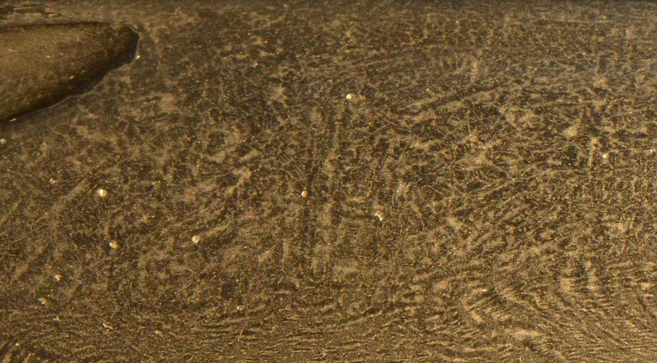

Some macro pictures.
Microscopic fine wootz with a chaotic pattern. Too detailed to see all details with the bare eyes.

The bars appear to have been cut from a single block of iron, and an oblong plate left at each end, the oblong plate has been recessed into the vertical bars and probably forge welded into place.

I believe that some of these little "spheres" are called pearlite. This happens to some wootz in the process of manufacture. I had a small Mughal kard once that had pearlite just like this in the wootz blade.
Old 28th April 2016, 01:13 AM   #5
Posts: 6,436
The pattern almost looks like stone in some places.

According to the wonderful and very valuable Dissertation of Anna Feuerbach "Crucible Steel in Central Asia" one can see the quality of a wootz blade by its shine.
"The shine is the lustre, or perhaps glittering appearance of the sword. The sheen can be absent (Piakowski, 1976, 239) or range in color from reddish to a golden color, which is the highest Quality (Bogachev, 1952, 40)." (Tatton, 1880, 60)
This Katar is from the golden type, clearly visible already during the polishing, if the abrasive cloth has a grit of at least 8000, better 12000. The effect was strong enough, to hide the whole pattern.
Roland

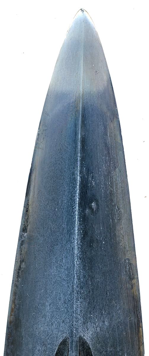

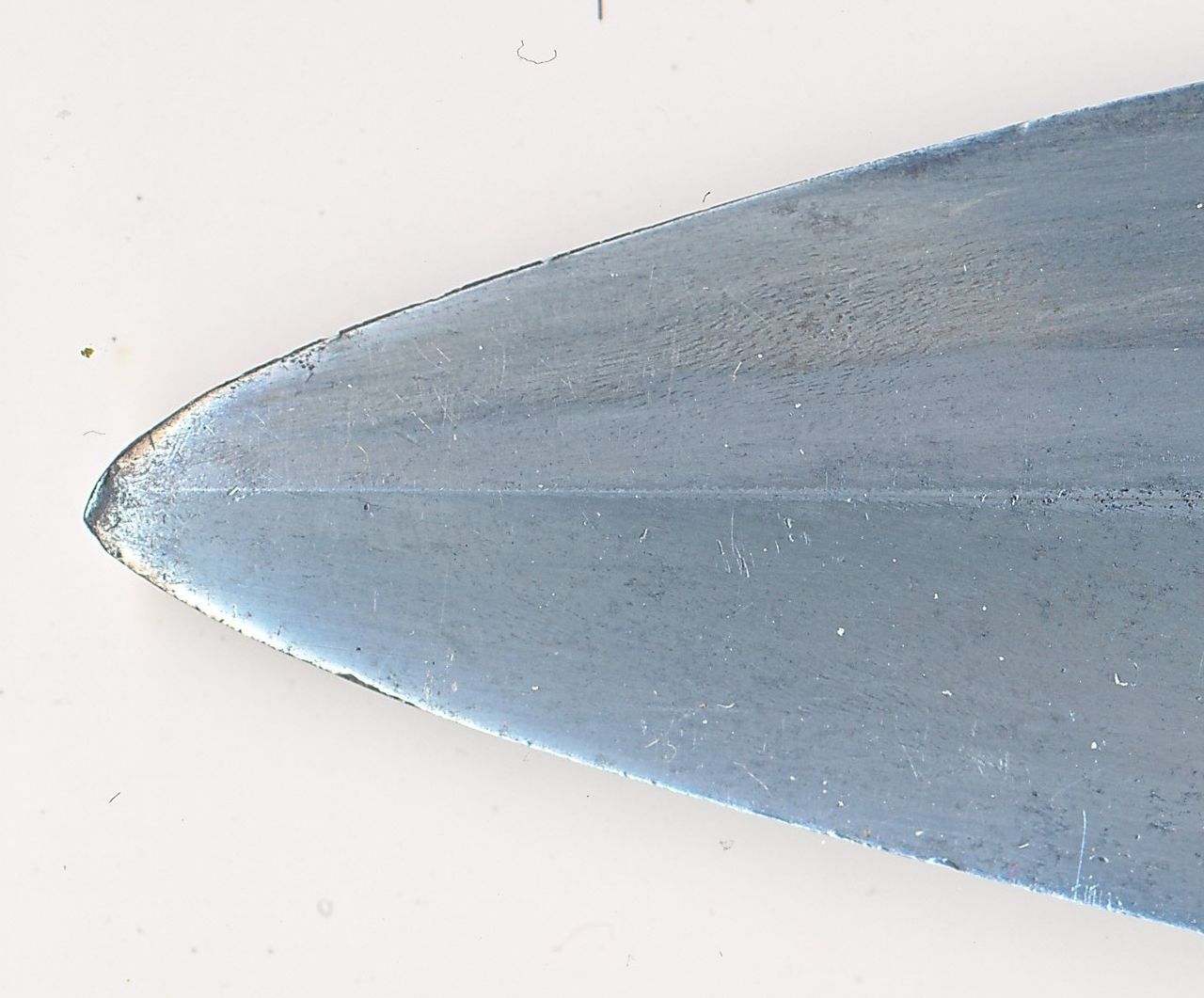

Thank you for your comment. I have one additional picture, which is worth to show. The Katar have a very interesting pattern from differential hardening.
The area around the point on both sides looks like an arrow with two small barbed hooks.

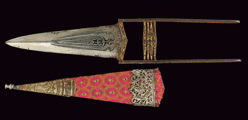

I remember that it was shown here http://www.vikingsword.com/vb/showth...ghlight=Roland
