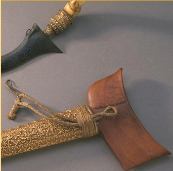

I believe the loop originated from Bugis Sulawesi. We can see it on older examples in many museums and books. Keris from Bima, Gowa... with the golden hilts etc. Bugis influence gradually grew on Sumatra, Riau-Lingga archipelago and elsewhere, so does it's keris and fittings.

Nah, I bow to your experience. From pic #2 and #5 I'd have guessed at a Sulawesi origin (short base of the hilt, nearly perpendicular "bow," very stylized head). I'm far from positive though - just curious which hints are suggesting a possible Sumatran origin.

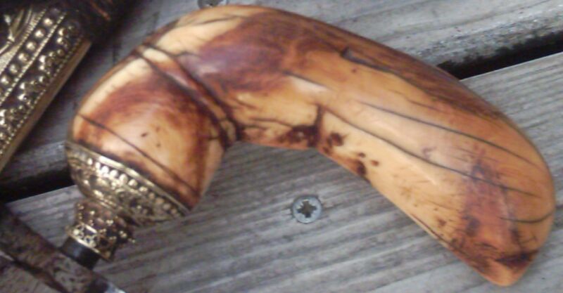

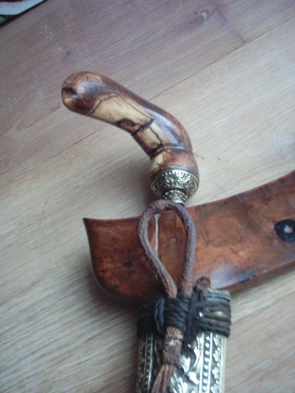

However, upon looking closely again... pic #3 and #6 shows the lower "bow", and flat balong at the back. The head area is 'fatter' with a 'droopy' chin, which leans towards Sulawesi... my mistake.

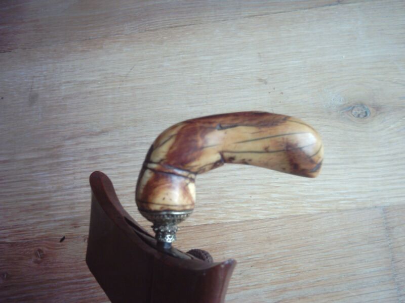

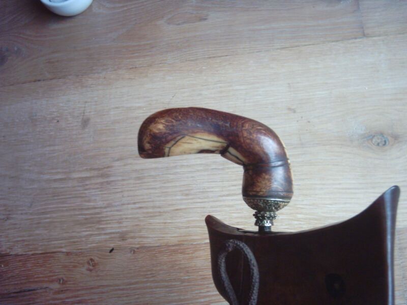

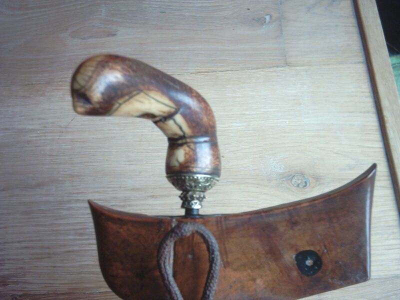

We are getting there slowely.
I have some better pictures of the hilt from different angles.
Please note the very small notch on the top, that seems to be worn of in time.
I received pictures from a forumite of spermwhale tooth objects that were discoloured towards brown/brownish (thanks!). Looks a bit like this hilt. But this hilt has several pieces that almost look like wood on the top and left side. Nothing I have ever seen before.
Old 27th July 2007, 12:26 PM   #20
asomotif
asomotif's Avatar
Join Date: Nov 2006
Posts: 2,238
some close close ups of the hilt. maybe gives a clue on the material.

Thanks for the new photos. From pic #1 and #4, it seems that the sheath is not original for the blade. Previously the sheath was home to a thicker blade, imho.

In addition to this old thread I found a picture of a similar simple toli toli on the website of the Tropenmuseum at Amsterdam.
Are there other examples where the toli toli is extremely simple compared to the rest of the keris ?
