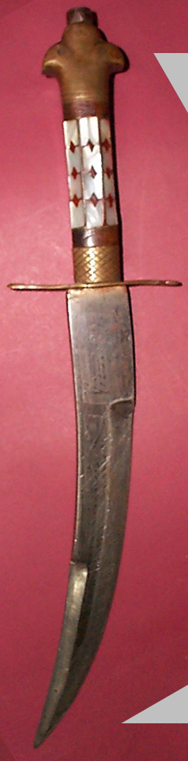

interesting knife i snagged on ebay today
.... 12in LOA apparently
Seller thought it was a bone handled dagger from the middle east, but it does not strike me as such, looks more like a small naval midshipmans dagger or dirk possibly a present as he was sent off to war. apparently has 'pure steel' marked on one side, and 'good luck' on the other, in english, along with the rest of the blade etching, so i'd suspect either english or american origin. i'll know more in a couple of days when it arrives & i can see if there are any other markings....saw some in the other recent 'naval dirk' thread & thought this could be a mustang's (came up thru the hawse pipe) or a poor middie...doesn't look like a milord's gold plated dress toy, rather a proper weapon.
any ideas?
edited:
just found almost the exact item at: Linky
mine looks like it's in better shape with a nicer grip & scabbard. i still wonder whether its US or British & approx age....

Hi kronckew
Your dagger is a kirpan it comes from India.
Lew
Old 8th April 2006, 02:41 AM   #3
Is it?
The blade looks like a Koummiya and the inscriptions on it do not sound Sikh.
The pommel looks American.
Kind of dog's breakfast..... I tend to believe the original idea of a "souvenir" American naval dirk.

I agree with Ariel, this appears to be an American Federal period dirk of about c. 1805-1815. The hilt eaglehead pommel very similar to American silver hilted hangers and officers swords of the period, and the chainguard is also typical. There were apparantly two principal schools of influence for these hilt forms, one in Baltimore and the other in the Philadelphia area, although certainly examples would not be confined only to those areas.
(see "The American Sword 1775-1945" by Harold L.Peterson, 1973, pp.31-51 for discussion on these hilt forms in chapter 'Eagle Head Pommels').
Very nice example, especially retaining its scabbard.

Hey guys
I have a bridge in Brooklyn to sell you! The dagger is from India or Pakistan I have seen these all over the place. Some times they say pure steel or best steel. Look at the scabbard the brass work is sloppy old scabbards would have a nicely formed button on the throat not a bent over hook with silver solder all over it and the leather looks the same as on the kukri scabbards right down to the X stamping on it. Also the eagle head casting is of poor quality 19th century castings have much finer detail to them you also would not see the pommel topped with a brass hex nut. I have seen this type of tourist grade dagger all over the internet in the past few year one had a composite hilt of bone and other material with the same blade and writing but saying best steel kirpan. When I showed it to a sikh friend at work she told me that these were made in India and were worn as kirpans by some of the men in her country. Btw there is no true designated style of kirpan this type might be an adopted form influenced by the British.
Lew
Old 8th April 2006, 09:02 AM   #6
thanks for all the comments, nice to see some discussion....
koummya blades i've seen have the major edge on the inside of the curve, false edge on outside, and very different grips.
kirpan have a similar shape, so i could accept this is an indian copy.
especially if it's good enough to have jim think it was a good example of a federal dirk. i do not have access to the ref. mtls. he listed....
if it is a replica, good thing i only paid a tenner for it. the one in the link ref. i found which looks like it, nut & all, is going for almost $200 & i don't like it as much.
