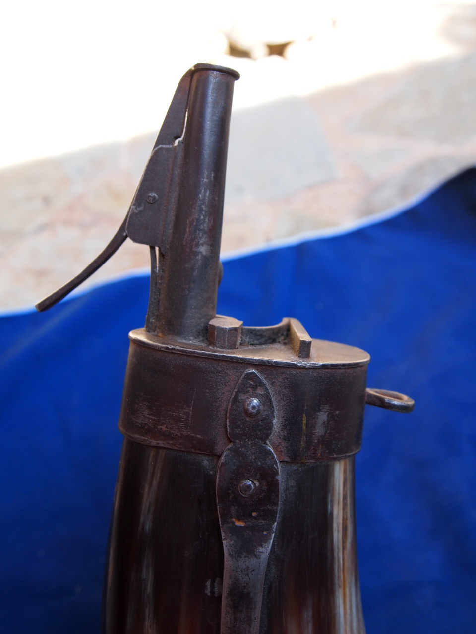

Hello everybody, please feel free to say anything you like about this powder flask. It has been with me for many years (1975) but that's about all I know of it's history. I tried it recently on ebay and had many watchers but no questions or bidders so thought I would ask the forum for their thoughts.
It is 11 inchs in height and brazed together. The joints are not butted up, they lap over each other. A bit rusty with a split in the horn. That's it folks, over to you.

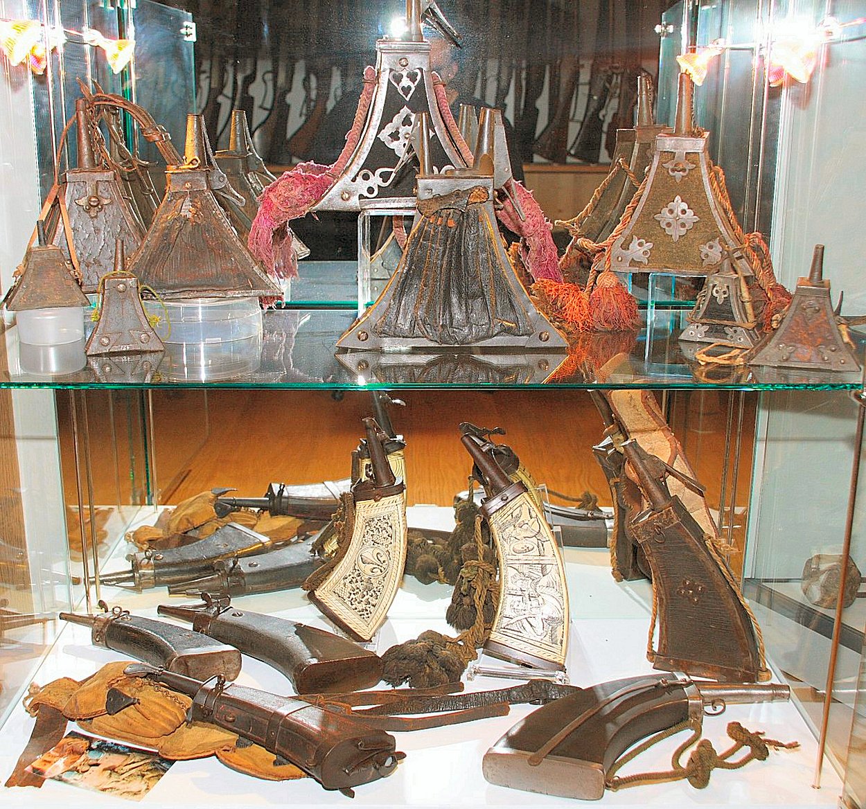

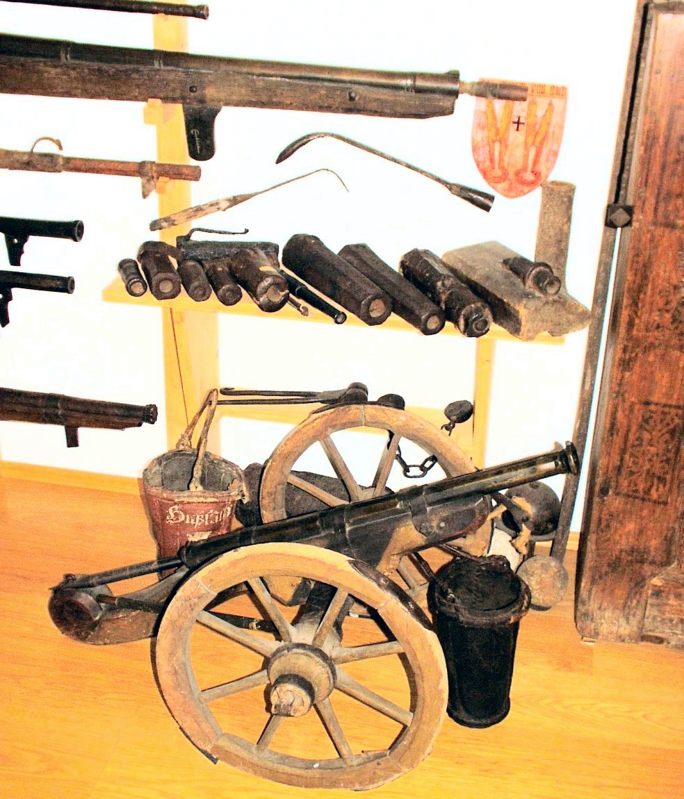

I attached a few photos of my highly specified collection of earliest German and Austrian 'military' long guns and all sorts of accouterments, from ca. 1360 to 1700!

I only have a question regarding the frog hook, which Michl probably can answer. I don't see a screw head is the hook riveted against the flask or are the screws mounted from the inside (which seems unlikely to me).

Looks like they were fixed with different techniques one from the other; which is easy to understand, once having fixed one (upper) section and 'plug it' to the other (lower) one, you can hardly do the same fixation from the inside

6. As I said in my reply to Tony's flask, all hooks usually were attached by a transverse screw, either going right through the body of the flask from the obverse side, and screwed to a threaded hole in the hook, or equipped with an additional iron thorn, to hold the hook in place.
In the case of Tony's flask, which may not have been made in Germany or Northern Europe, there are two transversal screws piercing the flattened cowhorn body, their big rounded heads clearly visible one below the other. The upper screw enters the obverse of the iron base plate of the top mount, goes right through the cowhorn, on through a hole on the reverse of the base plate, and entering a threaded hole in the broadened upper end of the belt hook - thus fixing the top mount to both the cowhorn body and the belt hook. The second, lower screw does likewise, but just goes right through the horn and into another threaded hole in the belt hook, thus keeping the belt hook from pivoting.
I reattached five photoshopped pictures of Tony's flask, showing the two screws entering the threaded hole of the upper and reinforced section of the frog hook.
