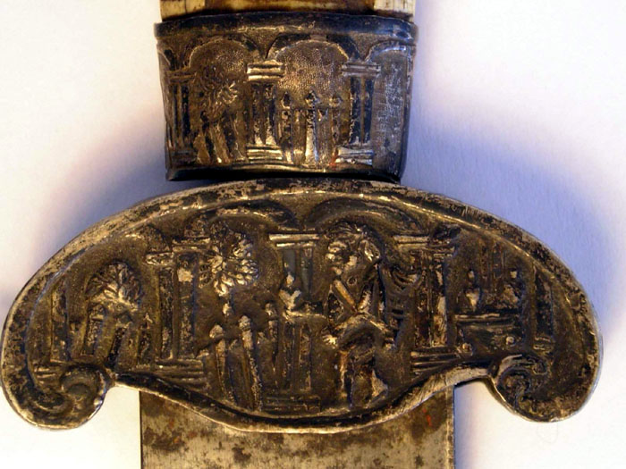

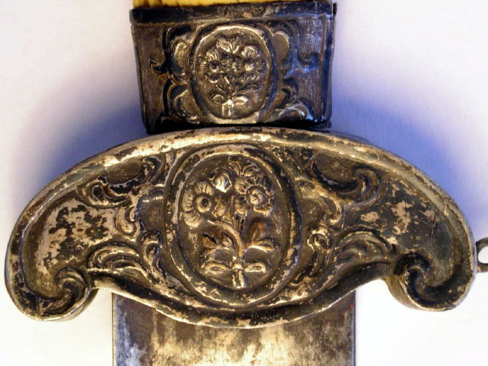

I'm happy to see discussion on this particular kind of hangers. I was always curious of this type because there are rarer and there is almost lack of any informations about them. I haven't much time to watch discussion very carefuly, but if I understand well, we've got two problems. First one is about genuineness of Valhjun's hanger. I'm not taking voice here about it, but I can say the hilt is quite poor. Such hilts were usually decored with engraving and repusee. But maybe such exceptions existed, though its out-of-style appearance is somehow strange. But I will second ham's and Jim's thoughts about hangers. Such ones with "chinese" hilts existed, and were produced in Europe, probably in central Europe, and it was somehow connected to oriental fashion popular on courts. Below you'll find more examples. First and second one are from book "Hladno lovacko oruzje" by Dora Boskovic. First one was made by Clemens Weyersberg in Solingen, 1730-1740 y., second is dated on 18/19 c., so it's quite late. Other ones are examples from my museum, dated around 2nd and 3rd quarter of the 18th century. One is with yataghan blade, with etched inscription looked like pattern, other one is with badly damaged, broken blade, but you can see some magical signs in there, used mostly in Germany. Regards! |

I must apologize for delay in responding. I just wanted to thank Wolviex for the outstanding post and illustrations supporting the observations on the Chinese motif presence on European hunting hangers of the 18th century, beautifully done!!! I would like to note also that in reviewing some Austrian sabres of the 18th century they also had openings pierced in similar location on the upper grip, presumably for lanyard or sabre knot.
Jeff, I always admire your keen assessments of weapon 'forensics'. You have noted very astutely some important factors that suggest inconsistancy in this weapon. Since the components conform essentially to those seen on known sword examples of this period, I am still inclined to presume them original to the sword, although it would seem there has been rather inept attempt at cleaning the weapon. I also think the weapon was dismantled to clean the blade and guard, although the ferrule, thoroughly corroded, was of course not cleanable. Since it is obviously rusted through, it must have cracked in reassembly. The darkened deep pitting areas on the guard seem to be left from the overcleaning. If I am not mistaken, inconsistancies in corrosion or patination are often due to different metal composition or quality, as well as the manner of production of the metal of the components.The blade itself, rather than being a 'yataghan' blade, is of a form known to exist on these 'military' hangers. While I would defer final judgement on the integrity of this example to hands on examination and to those much more experienced on appraisals, these are my observations based on what can be seen in the photos. Best regards, Jim |

There is one thing I would like to solve to avoid some misunderstanding. I put CHINESE in quotes because this is style which we are matching as such. I'm not quite sure if it was made as "chinese" in 18th century, how far our European ancestors were familiar with so exotic weapons from far far east. Maybe it's just a simple convergence of shapes? So the question is, do we have 18th c. chinese weapons that could be a pattern for these hangers, and were they know in Europe? Eastern fashion, I thought about, is appearing in yataghan blades, fitted to European hangers. Quote:
