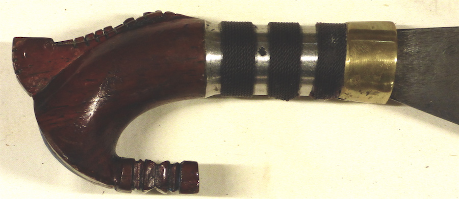

I've had these three barung for a while and I've been meaning to put them up for discussion.
The top one I purchased in Zamboanga in the late 1990s. I think it is Maranao or Yakan in origin (or perhaps a combination of both). The horn hilt is a flamboyant one, similar in manufacture to some of the modern pira that come from the same area in that it has a trapdoor at the end of the hilt. The pictures of the hilt show this feature.
The second one came from Manila and is Palawan in origin. A distinguishing feature of Palawano barung is often the absence of a metal punto which is replaced by rattan wrapping. The scabbard also has a distinctive style of wrapping with rattan that is also seen on their bangkung scabbards (there are examples of that sword and its scabbard elsewhere on this site). The scabbard on this barung has some nice carving showing dragons fighting. Palawan is the westernmost island in the Philippine archipelago and closest to the Chinese coast. It is not uncommon to find Chinese motifs in their crafts.
The third one I acquired in Davao City. It could be Maguindanao or Maranao in origin. The blade is a liberal interpretation of a barung. (Perhaps Jose can judge its origin from the okir work). Of the three, this is the best one with regard to quality of materials and workmanship.
Each of these barung is a departure from the more traditional forms seen in the Sulu Archipelago and Mindanao. These recent interpretations are interesting and reflect the ongoing skills of Muslim groups in the Philippines.
Ian.

Interesting pieces, Ian.
The first barung might be Maguindanao from what little okir I can see.
I agree the second one is Palawan in origin, adding that this form of sipput barung mostly comes from that island.
The okir of the last barung looks Marano to me.

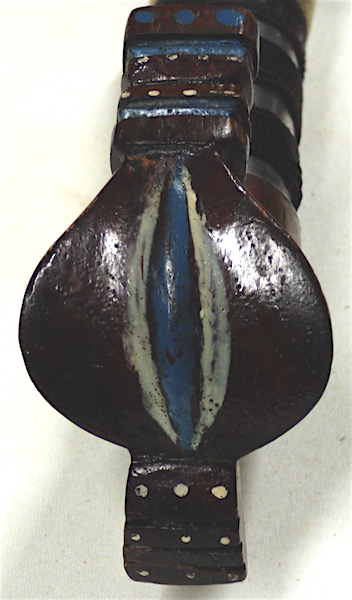

Default Another late-20th C piece
This one was collected in Davao City in the late 1990s. It resembles the bottom one in the initial post of this thread in that the blade is an odd clipped form--something of a "barung/gayang" shape. The hilt has also been decorated with painted motifs on the kakatua pommel (see pictures). I think this one could be Maranao or Maguindanao in origin.

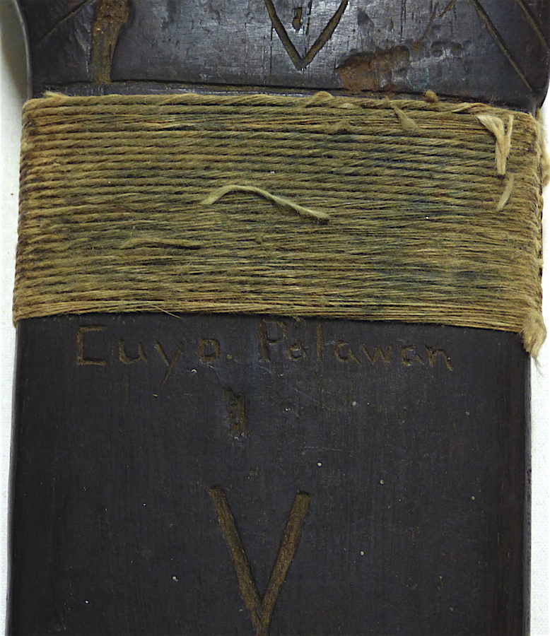

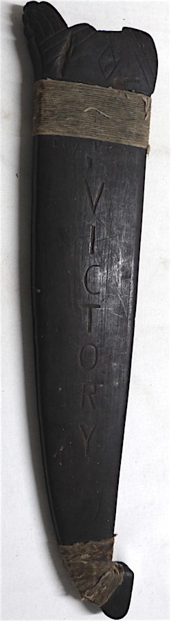

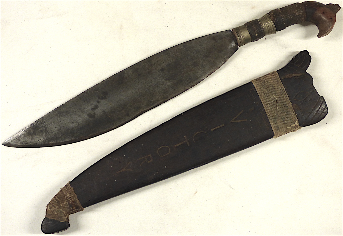

Default WWII-era Palawano barung
This one has the appearance of a WWII-era barung. It has a narrow blade for a barung and is well worn and much sharpened, The scabbard is wrapped with cord in the manner of many WWII-era pieces. It is distinguished by an odd punto and a scabbard that is carved with "VICTORY" vertically, and with "Cuyo, Palawan" just below the top cord wrapping. The Cuyo Islands (capital Cuyo City) are a small archipelago of islands under the administration of Palawan Province that run between Palawan and Panay in the western Visayas. It is unusual to find and identify Palawano weapons by inscriptions of this type.
Ian.
Ian.
Badung also from Southern Palawan, non-tribal
