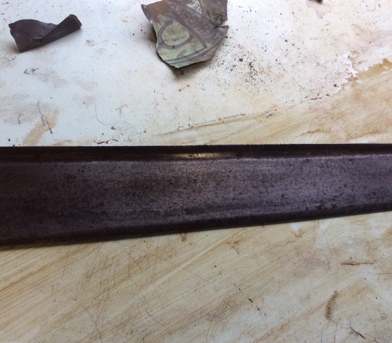

I normally do not clean my items but this knife just had to be cleaned, I left the brass and horn un cleaned
I decided to document the process to see if I can contribute somewhat to this fantastic forum

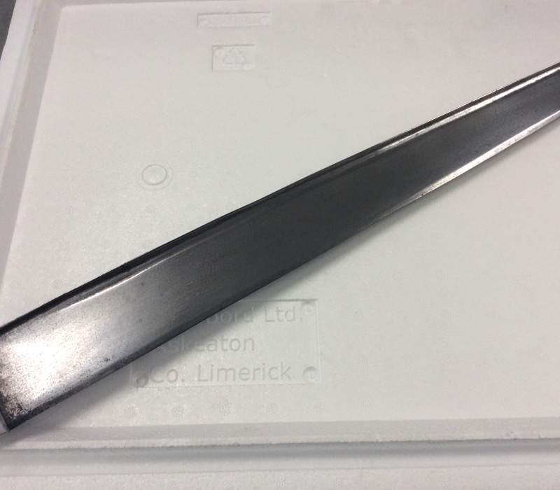

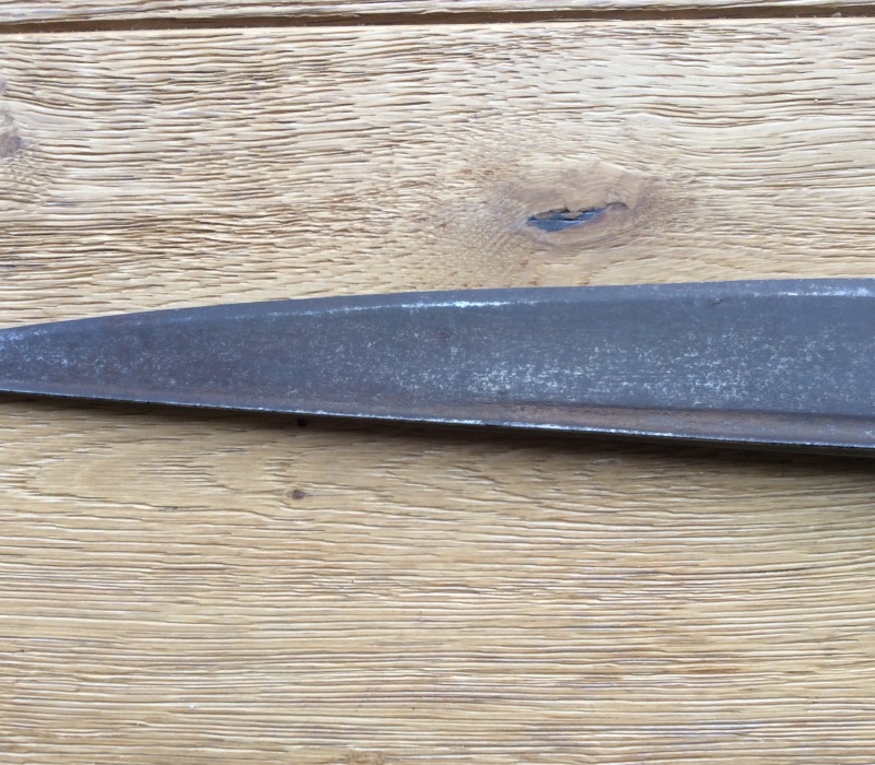

See below the blade in original state

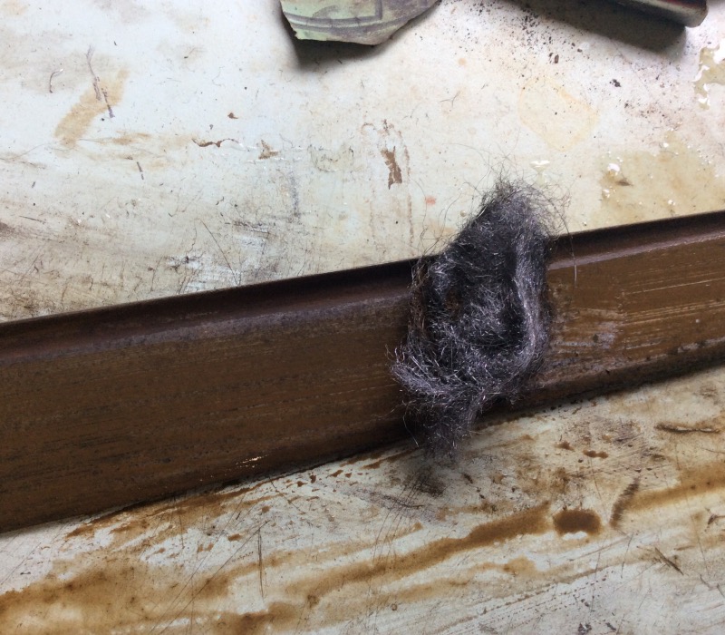

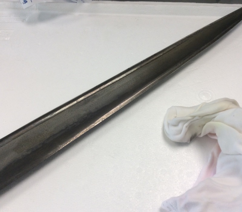

I worked from 000 wire wool with oil up to 2000 grit sand paper
Probably took 2 hours in total
The first set of images are the cleaning in progress
There are a good few pictures so this will take a few posts

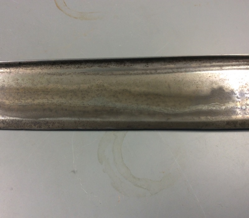

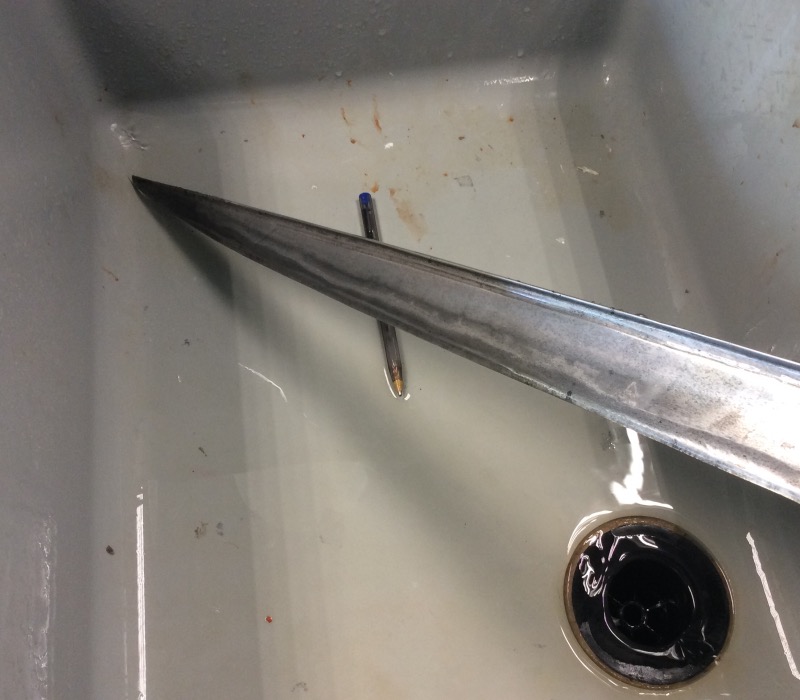

Next step was the etching
I pm'ed mariusgmioc after his recent post on etching to ask about the solution he used
I work in a lab so getting the natal solution he talked about was no problem.
I mixed up 500 ml of methanol with 20 ml of 70 percent nitric acid to produce a 4 percent solution.
I decided to rub on the enchant as I did not have a container deep enough and I did not want to use up too much solution as it can be hazardous to store.
In making up the solution it got slightly warm but if you add to much nitric the reaction can go too crazy and degrade the alcohol, giving off red fumes.
I was prepared if the solution degraded with 5 L of water to hand to dump the solution into
Gloves, goggles and lab coat were worn.

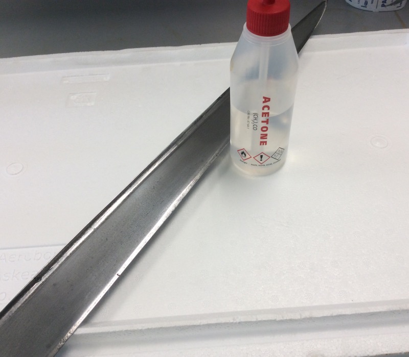

I washed blade with acetone to de grease it.

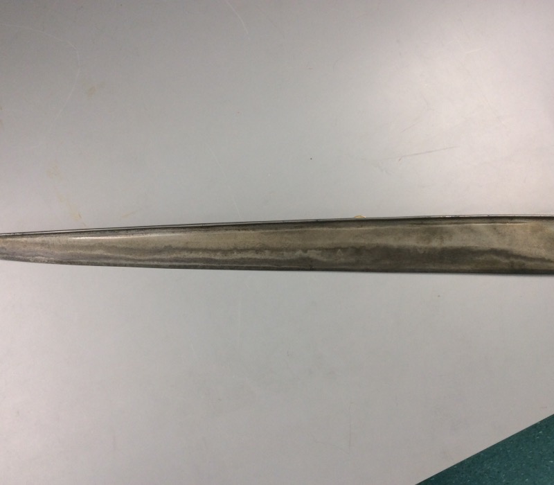

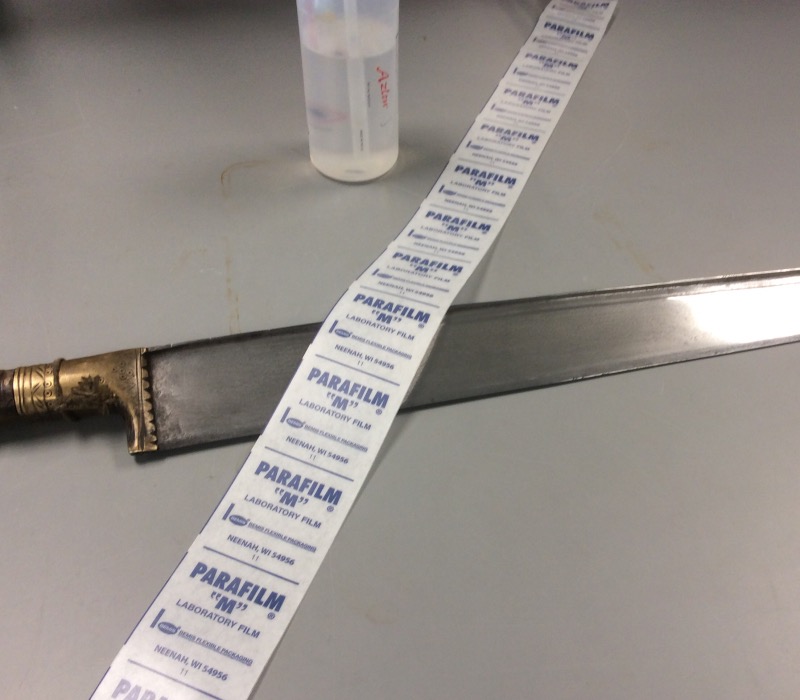

Then I rubbed the solution using a cotton swab and left to sit for 10 seconds
Then flushed with water in a sink
And dried with tissue
The process was repeated 3 times
Para film was used to protect the handle, this is a lab product like cling film
I could see the pattern emerging in 3 or 4 seconds
Nothing fancy compared to what I see on this forum but definitely a laminate blade, I think!
Results on the next post

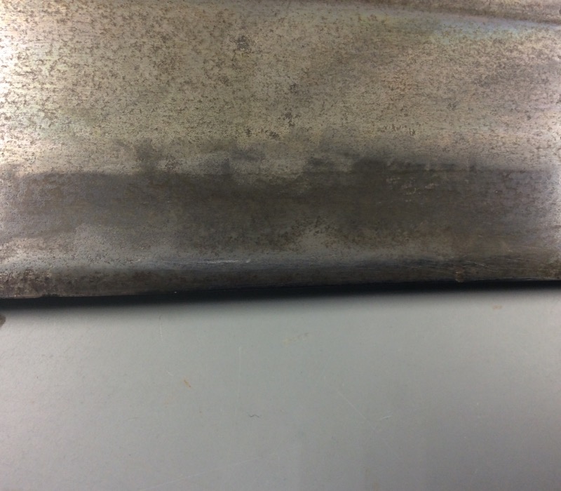

And finally what I have ended up with.
Slightly brown in places but I might have a go at polishing gently the whole blade later on.
Any comments advice welcome

From what I see, you didn't polish the blade sufficiently. It should be up to grit 2000-3000 (mirror polish; some pitting here and there is acceptable but the surface between pits should be mirror polished).
Then try etching.
For lower contrast/difficult wootz I use "reversed etching." More exactly I strengthen my Nital by adding about 10-20% Perma Blue and apply the solution to obtain a uniform blackening of the whole blade. Then gently wipe off the excess black oxidation with cotton wool swabs and Pre-lim.
Good luck!
