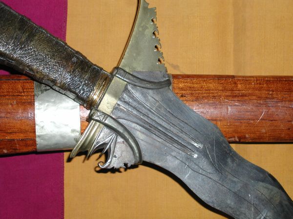

This Kris has been residing in my collection for a few years now. I cleaned it and etched it with PCB etchant. For some reason the ganya and the elephant's mouth cavity won't take to the etchant. What do you forumites think, stainless steel, highly unlikely. BTW the lower portion of the elephant's mouth is copper. I saw another Kris with the same type of ganya, I believe it was Ibeam's. Overall length 28", blade 23.5". The last photo is of the blade before the final polish.
How about the hilt, any particular name? Maybe an Indo name?
As always all comments are welcomed and much appreciated.

That's interesting! Is it possible the ganga is silver or silver plate, Kino?

I wonder if it could also be nickel. I know it isn't affected by arsenic and lime on Indo keris. Perhaps it would resist PCB etchant as well. But Andrew has a point and it does look a bit like silver. Was the gangya tarnished before you etched?
The blade certainly looks Moro, but i have never seen this type of hilt before. At first look it (the hilt) appears distictly un-Moro. Do you think this is a re-hilted blade?

Maybe I should have it assayed to see what the silver or nickle content is.
In Cato's book, pg. 61, a Kris with a similar type of hilt. I don't think it's a re-hilt.

If that gangya has silver in it or is silver it would turn black with an etch .
Suspect that it is high nickel content alloy .
The hilt reminds me of Borneo work without the inten .
Also , is it just me or is that a pretty skinny tang on this sword .
Could we possibly be looking at a genuine Borneo kris ?

Here's how I think this was done. With the blade disassembled, the separate gangya and the top inch or so of the blade were electroplated -- possibly chromed. Then the plated portion of the main blade was lightly ground/polished back leaving only the elephant trunk area still plated. The main part of the blade was etched and the sword reassembled to create its present state.
The hilt is similar to those on some of the highly decorated smaller kris being produced in Lanao. In which case this one could be Maranao in origin.

I think that the hilt is a later style. I also agree with Rick - if the ganga were silver it would have turned black or very dark brown. Only chrome or possibly nickle would not react to the etchant.

I just came back from the Jeweler, he tested it and confirmed that it is Nickle with some silver content (German Silver).

FYI - Nickel is German silver with a little copper in it.

I am pretty sure that 'German silver' ,'Nickle silver',and white brass are all the same thing,and none have any silver in them,heres the breakdown I have:
60% Copper
20% Nickle
20% Zinc
Justin is offline   Reply With Quote

I just re-read this. Nechesh and Justin are right, there isn't any silver in "German silver" which is nickel/copper. If there is indeed the presence of silver and the presence of copper (somthing of which I assume in the testing) then KIno has a point - it could very well be a low grade silver alloy, say 65-75% silver and the rest copper. Coin silver is 80% silver and would not turn up much of the copper in silver testing as it would in white brass. This makes some sense in parts where I see brown patina.

Silver turns black quickly in sulphur compounds . Egg yolk contains sulphur. A drop of egg yolk on the ganga will turn it black VERY quickly, depending on the silver content. Mine did.
