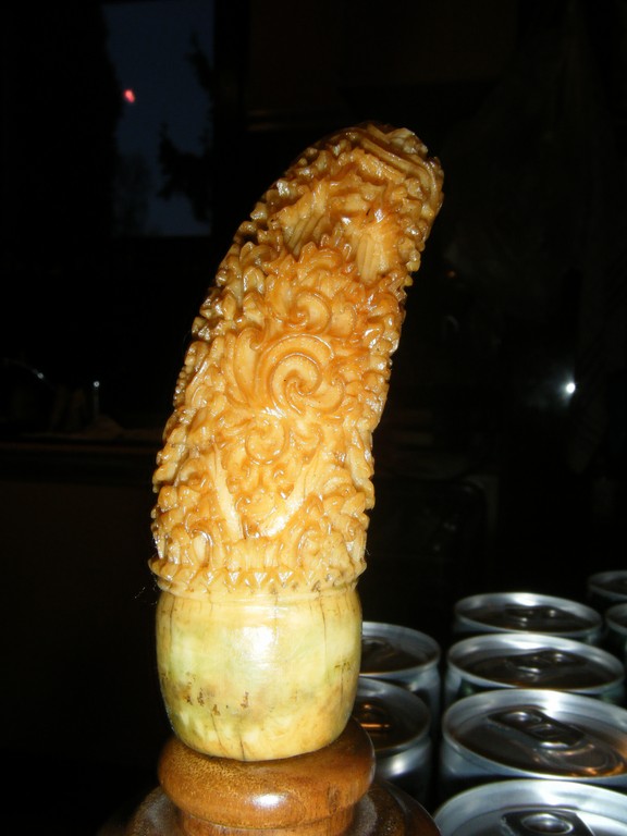

Originally Posted by Sajen

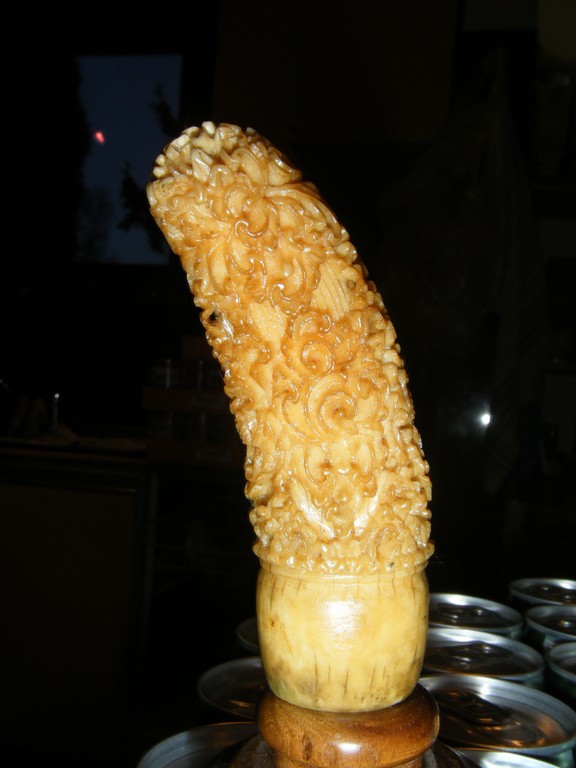

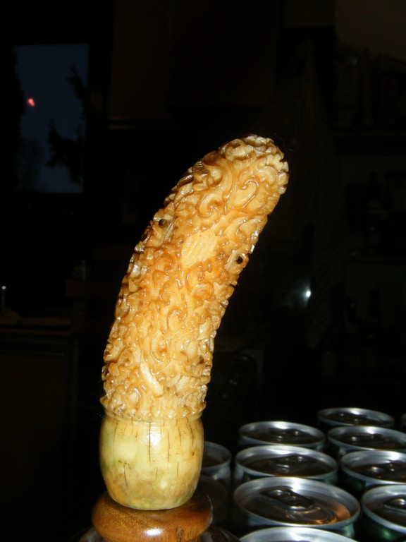

Here some of the same "family" from a other form, know someone the name for this form?
Here one in the same style from marine ivory which enter my collection a while back.

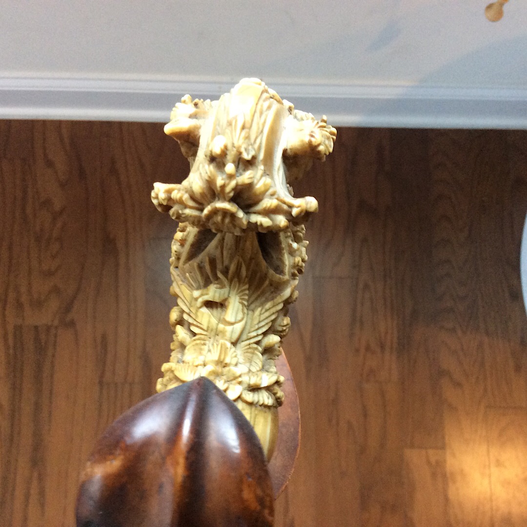

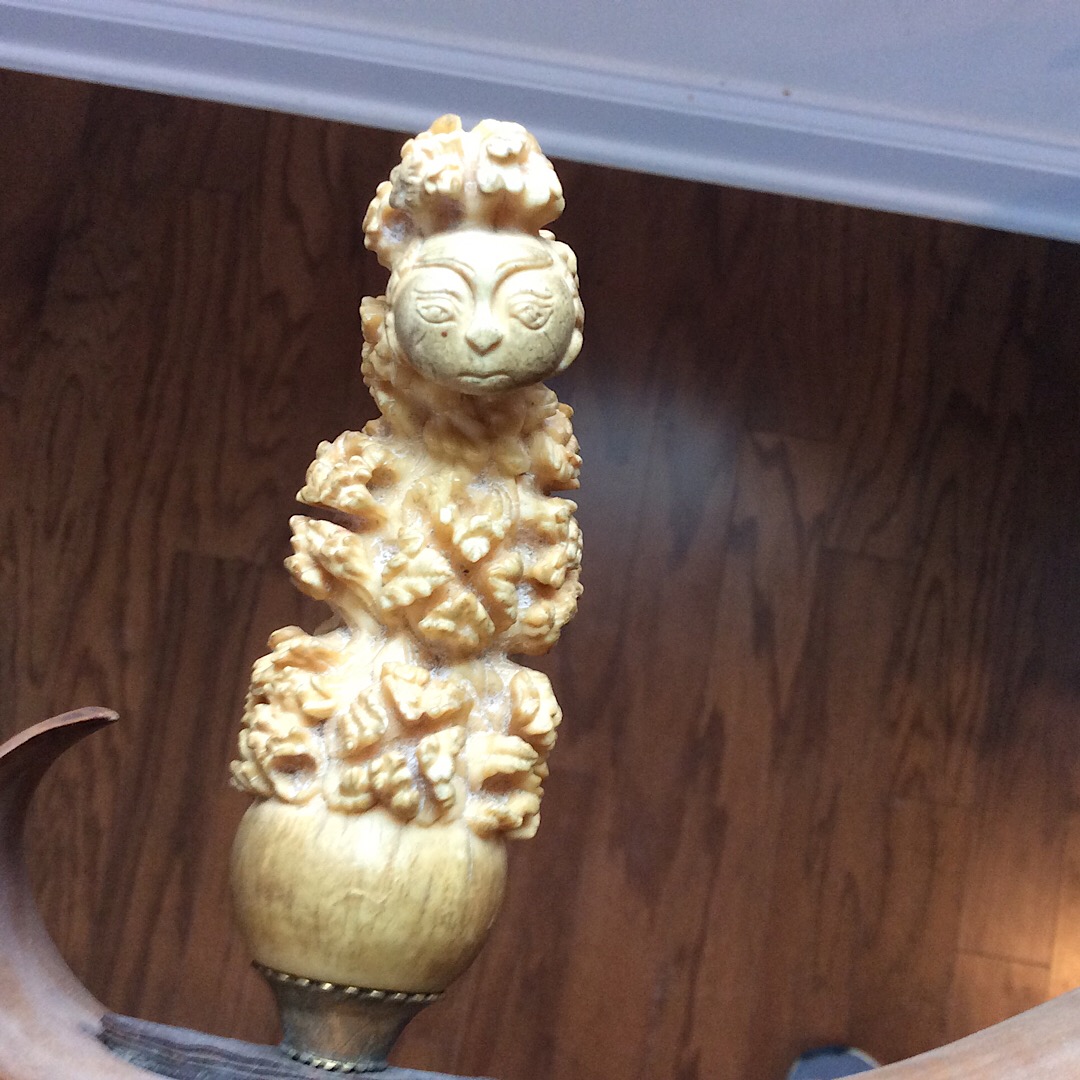

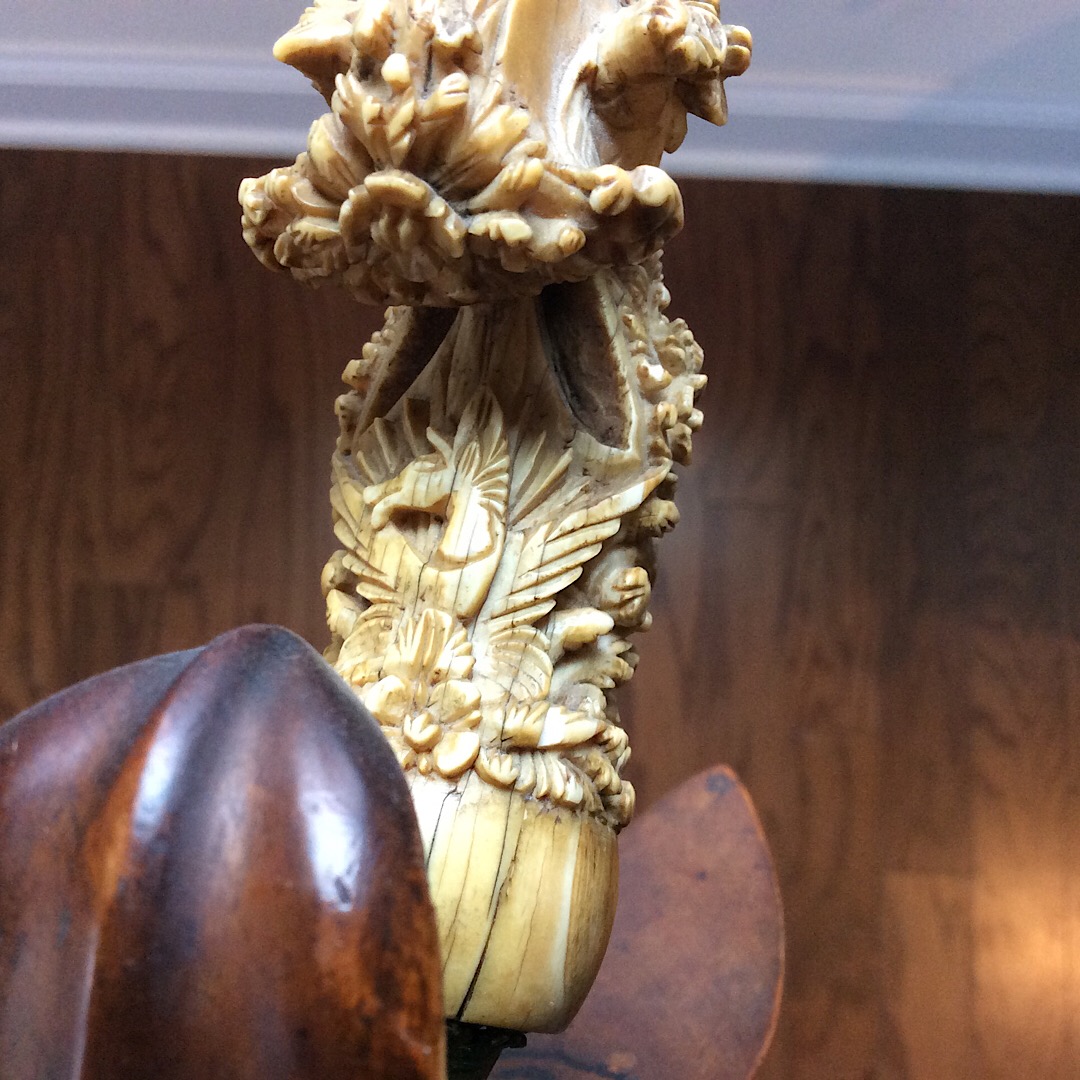

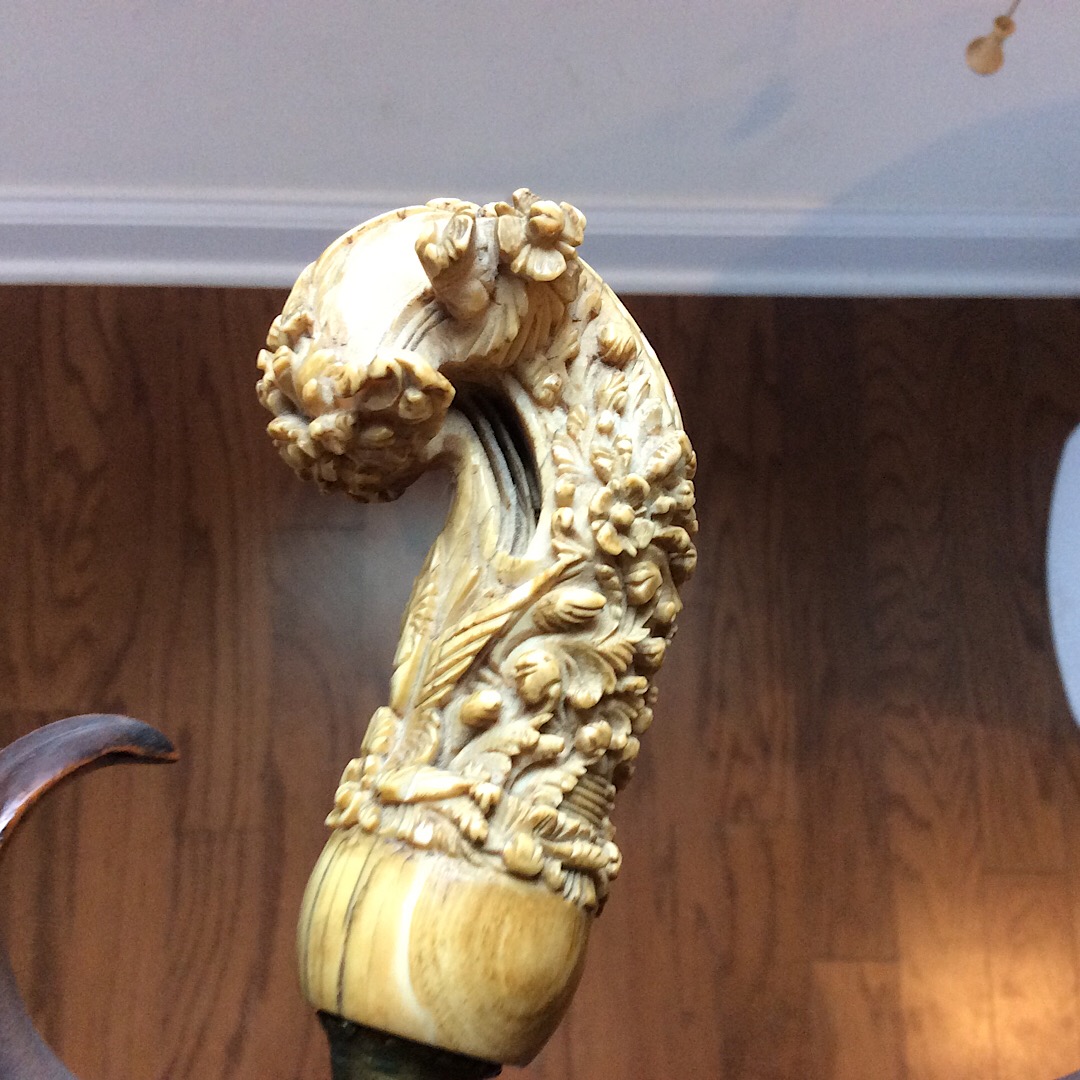

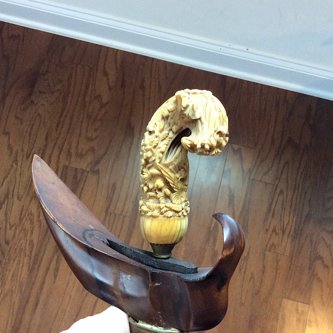

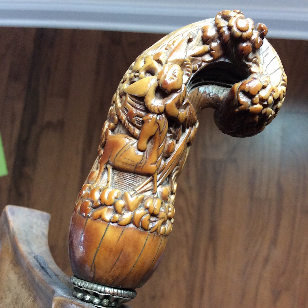

Here is mine very similar to post 17 ( hilt 8) which Alan shows us.
A good examination reveals that it LOTUS flowers are all around.
Does it have a deeper religious meaning or just aesthetical purpose?
The sacred lotus, Nelumbo nucifera, is an aquatic plant that plays a central role in the art of Indian religions such as Hinduism, Buddhism, Sikhism, and Jainism.
Symbol for Purity: The lotus flower emerges from murky waters perfectly clean and beautiful, so it is also a symbol for purity. The meaning of the lotus flower holds such power because it can offer hope and strength to people struggling in their daily lives. It is a symbol that shows that no matter where you start off in life and no matter what you're going through, you have the ability to rise above, overcome all negativity and find bliss as you emerge from your struggles.
Paul B. is offline   Reply With Quote

Anybody having a clue?
Old 1st February 2020, 07:31 PM   #130
Hello Paul,
Most of the carved elements are lotus leaves rather than flowers (they are also the most striking part of the plant keeping itself clean from mud/dust with the help of bit of rain); AFAIK they share the same symbolism - purity seems a pretty universal meaning attached to the lotus across many cultures.

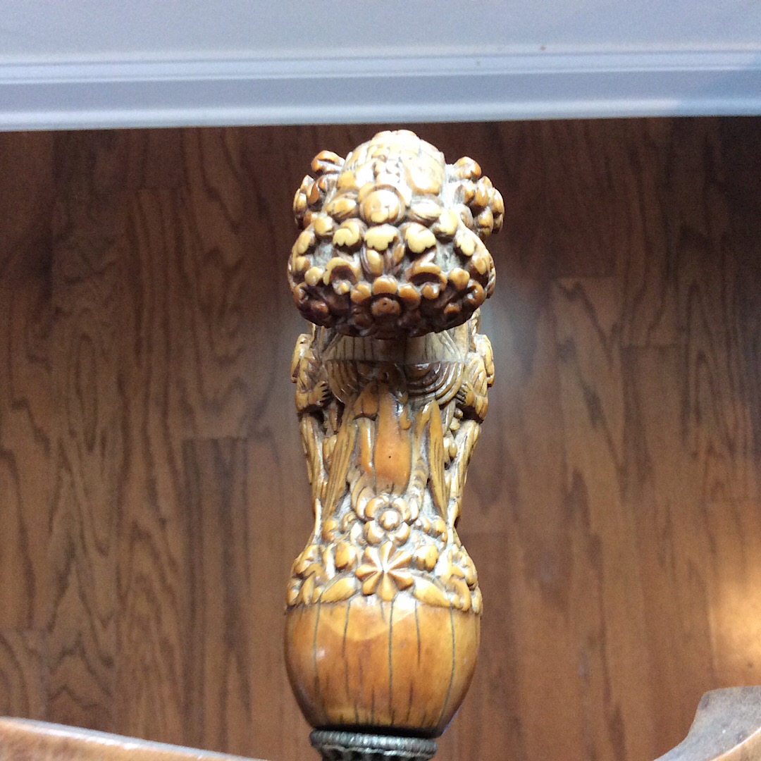

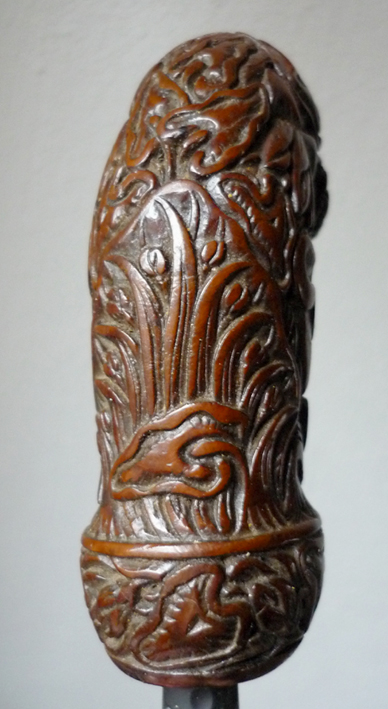

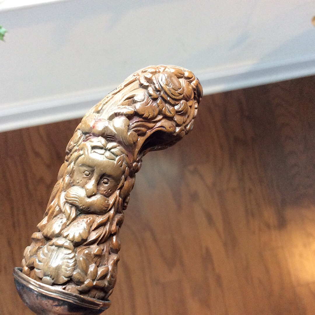

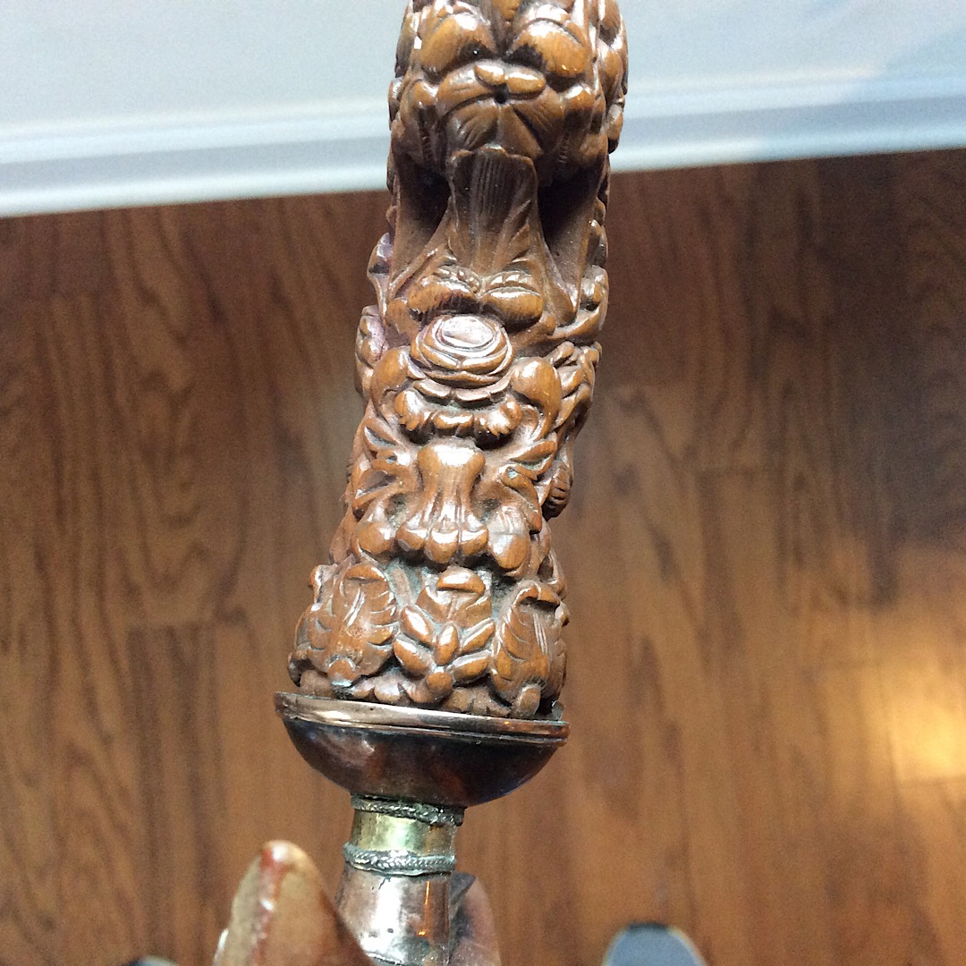

Some more examples for the record.

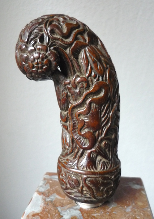

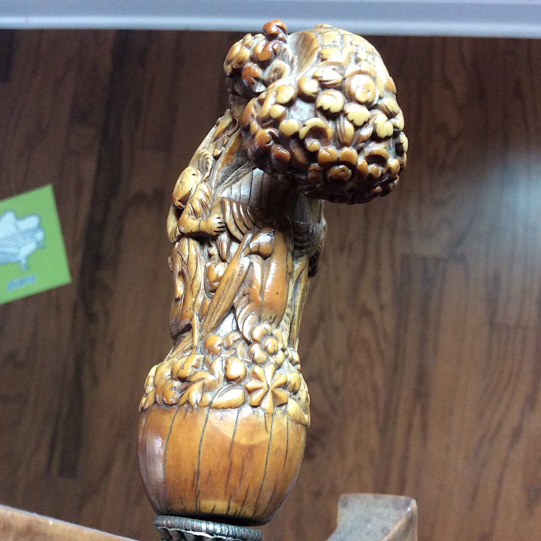

Another example.

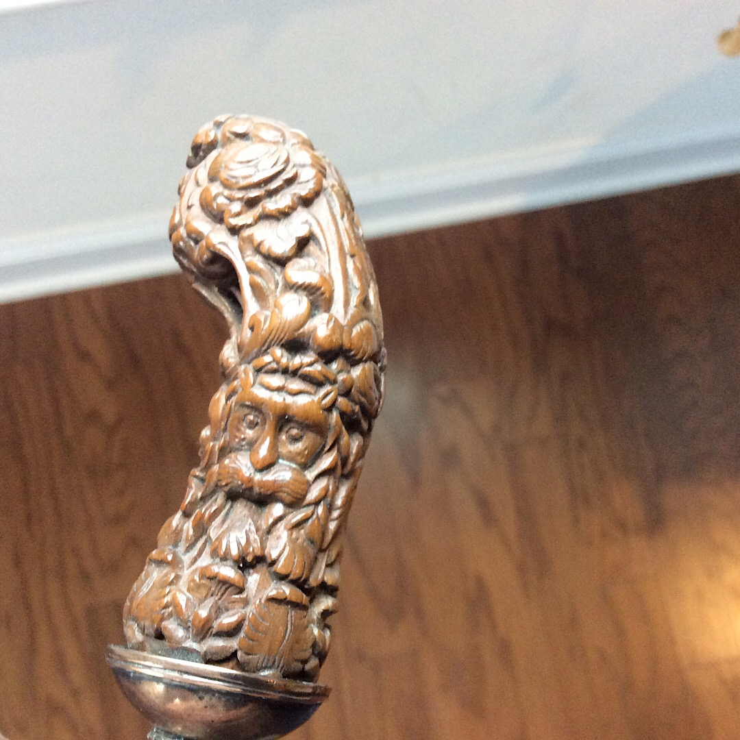

Example 3 for the record.

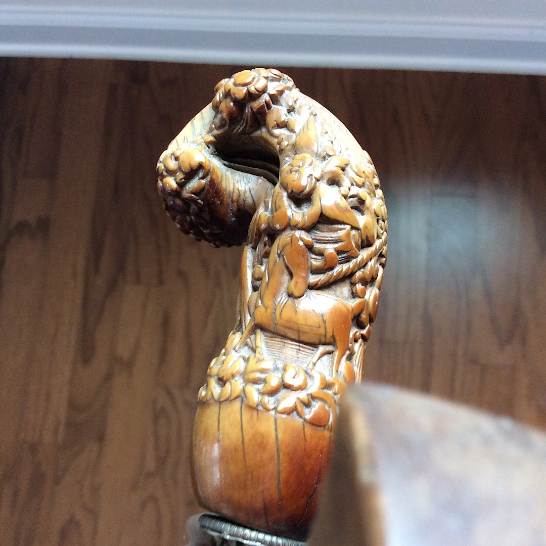

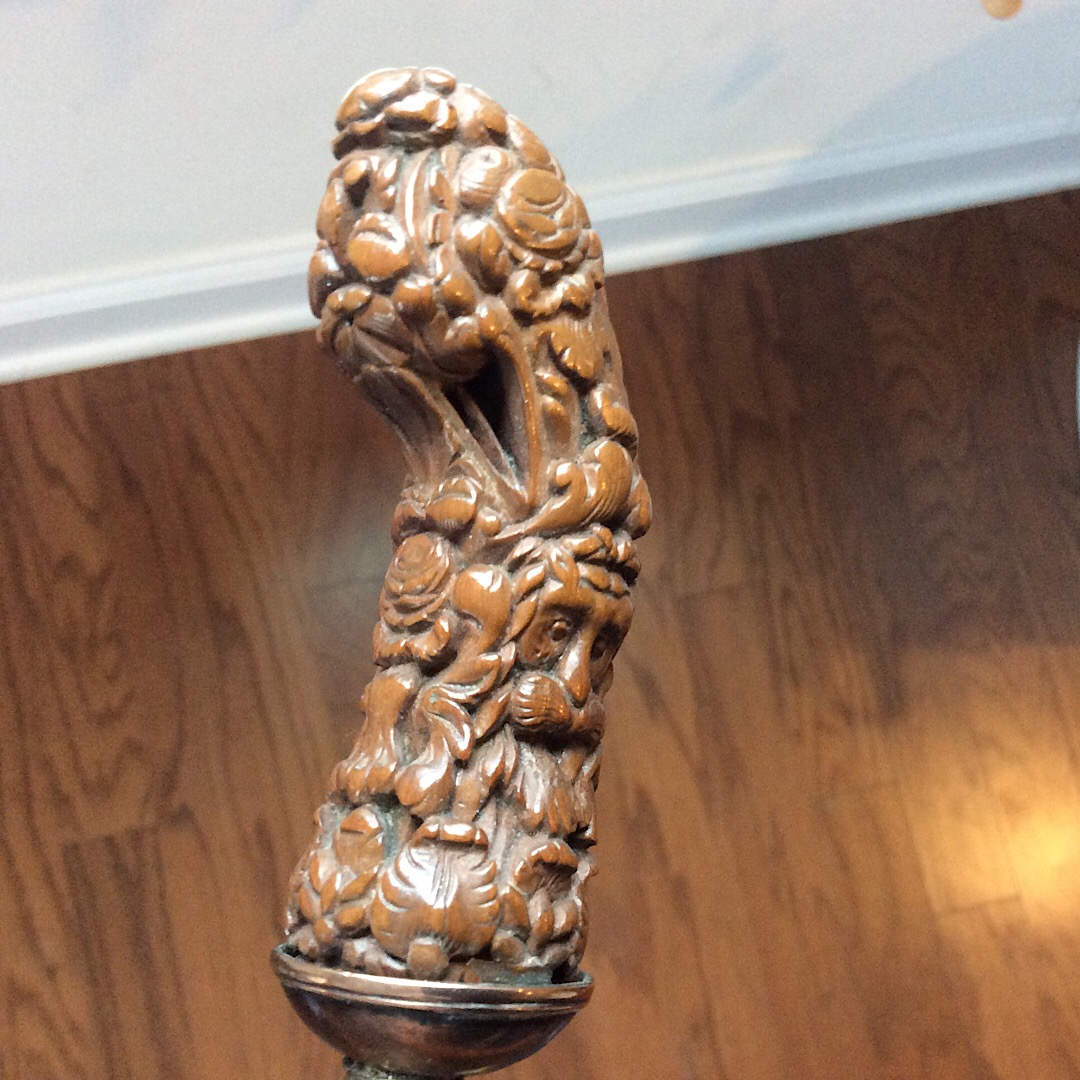

Fourth example to share.
