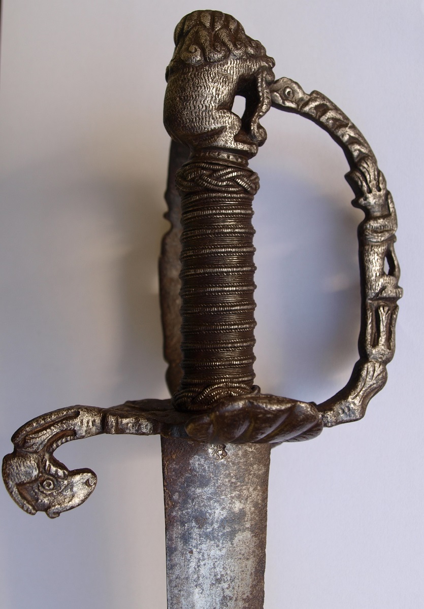

Hello Together,

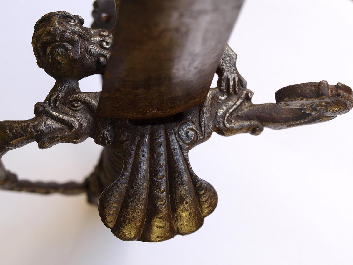

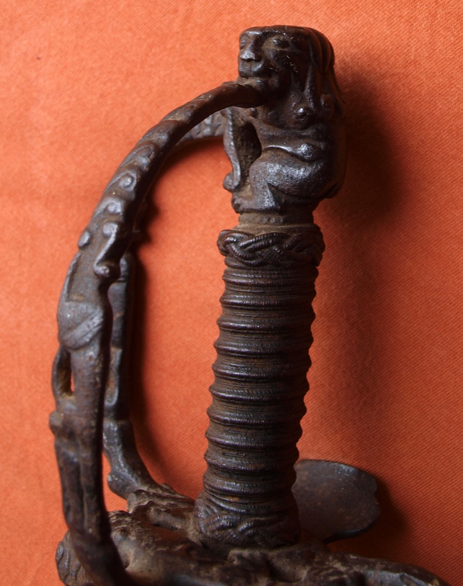

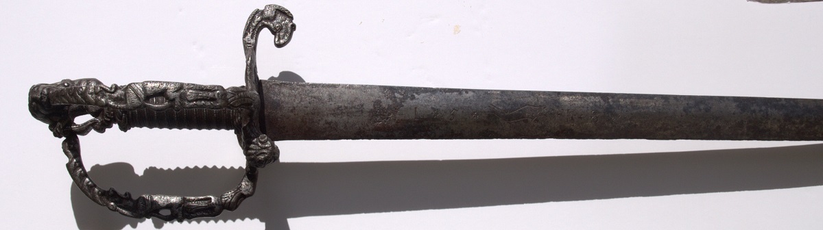

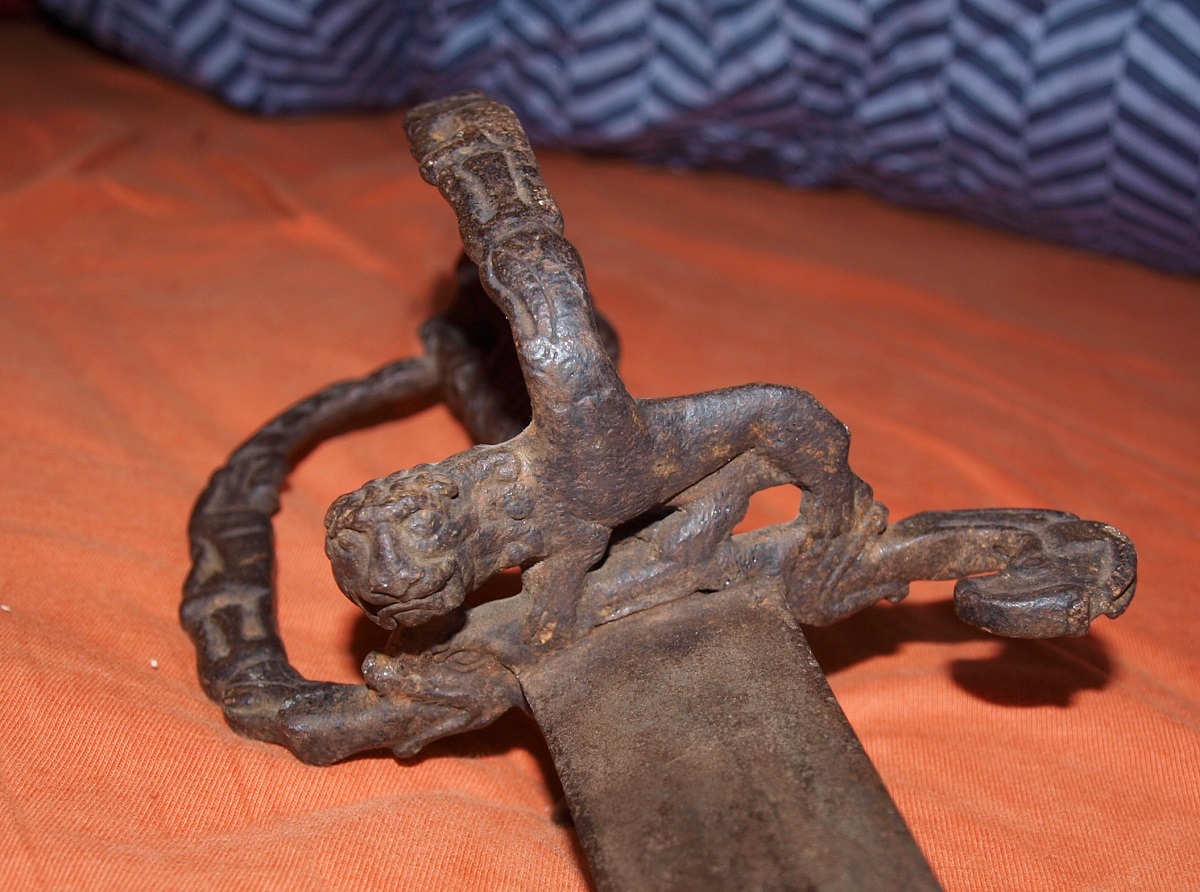

Some month ago I got this interesting sword. It was covered by a thick patina (see first picture) which was easy to remove. Surprisingly the condition under the patina was quite good. It is 90cm long, the blade is 77cm. The Guard is cutted from iron, no iron casting. There was a thumb-ring on the shell-guard, removed in the old times and the blade is signed with the "passauer Wolf" and the "magical number" 1518. I found a similar piece (converning the lion-guard) at Hermann-Historica, Auction 62/63 -> a selection of collectibles -> Hunting Hangers Lot Nr. 2330c http://www.hermann-historica.de/db2_...ion-62-63.html
I got three different opinions on this piece:
- "maybe historism (19th cent.) while using a blade of the 17th."
- "Officers Felddegen, around 1660, the guard in the style of Gottfried Leygebe"
- "Guard around 1580, Northitalian, the blade marriaged with the guard around 1600"
My opinion: Due to searching a lot of catalogues etc. I think the second opinion (around 1660) is the most likely one. But I couldnīt find an identical or nearly identical piece. In my eyes evidence against historism is the removed thumb-ring and the deep nick/cut on one of the stirrups (sse picture), which seems to originate from another edge weapon, also as this potential hit bended the stirrup out of shape (see last pic).
I would be very interested in your opinion about this peace. Maybe you can also help me to find out about the geographical context of the sword.
Thanks and best regards,
Andi

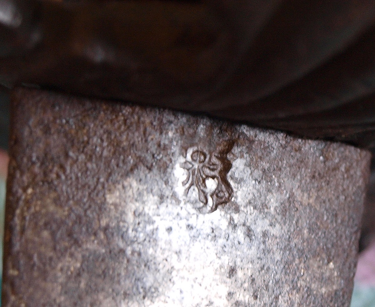

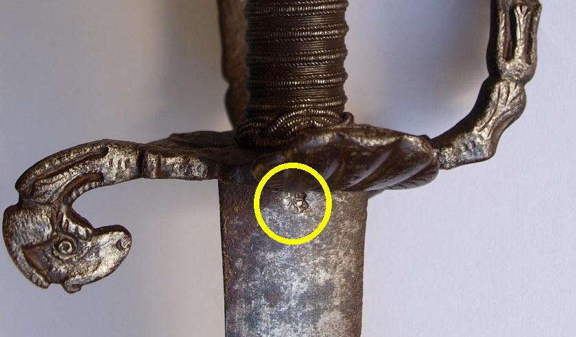

Say, aren't you skipping over a vital detail, which is that mark on the ricasso ?
Once identified, it will be more than half way to find the provenance of your sword and potentialy remove the historism possibility.
Can you take a better picture of this one ?

Hi at all and thanks for your replies. Fernando you are right, I forgot to mention the mark. Here is a better picture of it. I studied some books about Solingen-Marks but couldnīt find it.
Andi

To me the patination looks good, and concurs with swords of this age. The blade is interesting, and I have not found information on these rather unusual lenticular blades, but know they were used of course. The stamp at the forte seems floral, but I cant make it out. In style it seems like it could be one of the town stamps used by VOC kamers (the seven chambers in Netherlands) but have not yet found more .
As well noted by Andi, the 1518 is indeed a magic number rather than date, and the running wolf along with it indicates of course pretty much a standard pairing for Solingen products of these times.

Having a look at the inunmerous marks in the Wallace Colection catalogue (1962) i don't find it either ... whatever is correct position.

Fernando, you were very astute to point out the stamp. Even I had blundered past it when this thread was originally posted. Is there any possibility that flower could be a tulip? (Dutch tip of the hat again. Sorry, can't get past those lions ).

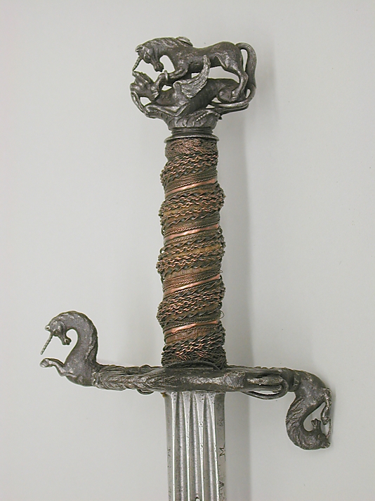

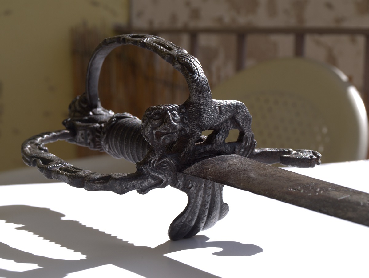

allow me to fetch up this old thread. Itīs now nearly 10 Years I own this piece and it still wonīt let me go. From time to time I do a bit of research on it and my biggest dream is to find a painting showing itīs owner with the sword I know it is very very unlikely, but I am sure such a painting once existed. The question is: did it survive and is it listed somewhere...
But anyway: I just stumbled over a picture I saved as a reference years ago with the comment "Sweden, 1660-90". Iīve found several swords with similar lion cross-guard, many of them indicates the Netherlands as origin but there are also pieces with other provenience. But this is the first time I found this wave-like decorations on the guards. Also the tool used to decorate the stylized head seems to be similar to the one used to form the lions coat. Maybe this can be a another hint to its origin.
Sadly I canīt remember where I saved it from, only that it was a (Swedish?) museums online gallery without more information.
Does anyone of you know similar examples?
