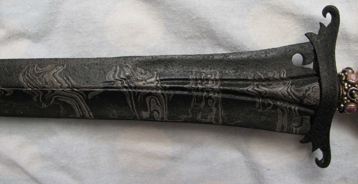

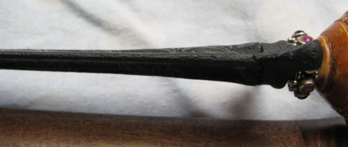

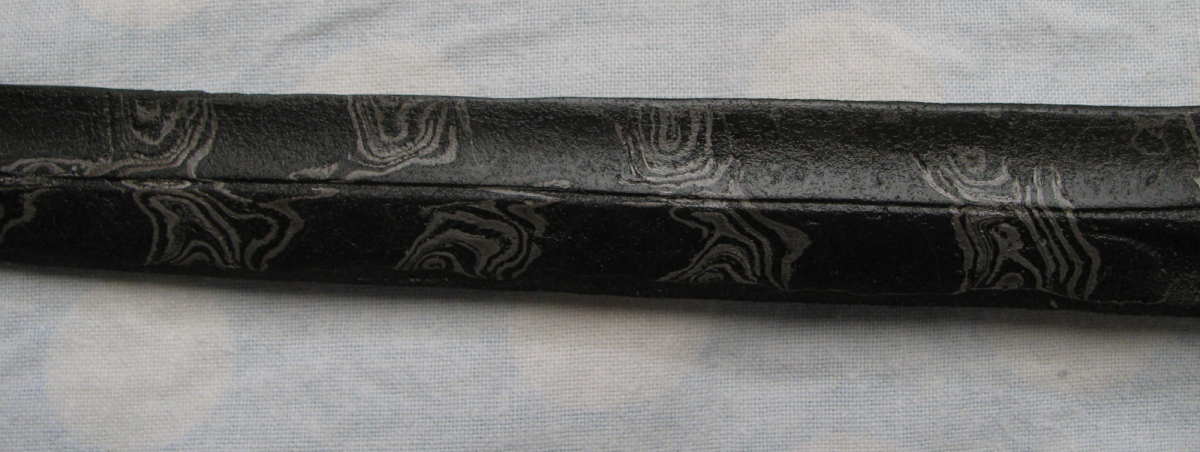

Dear all,
I recently acquired this ligan (pedang keris) from Lombok. I think it fits the description from Ir. Lalu Djelenga book, Keris di Lombok. The blade itself is not straight, it curves like a pedang. It also has half the back edge of the blade(inner side of the blade curve) without an edge (see pictures). The pesi itself has a rectangular shape. I dont have a scale handy while taking the pictures; but the blade has approximately 60 cm in length from tip of the blade to the pesi end. (two pieces of A4 photocopy paper combine together in length)
Any idea how old is this? Pamor type?
Any comments positive or negative will be appreciated
