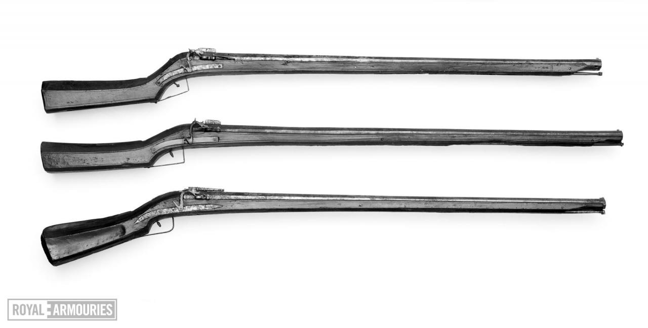

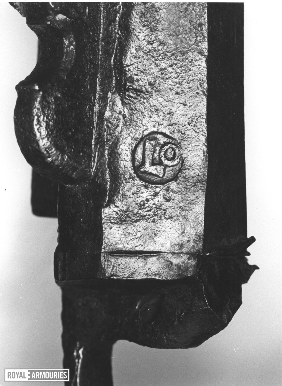

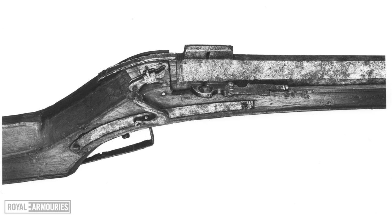

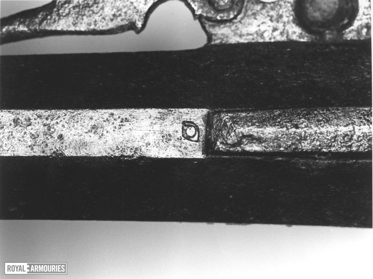

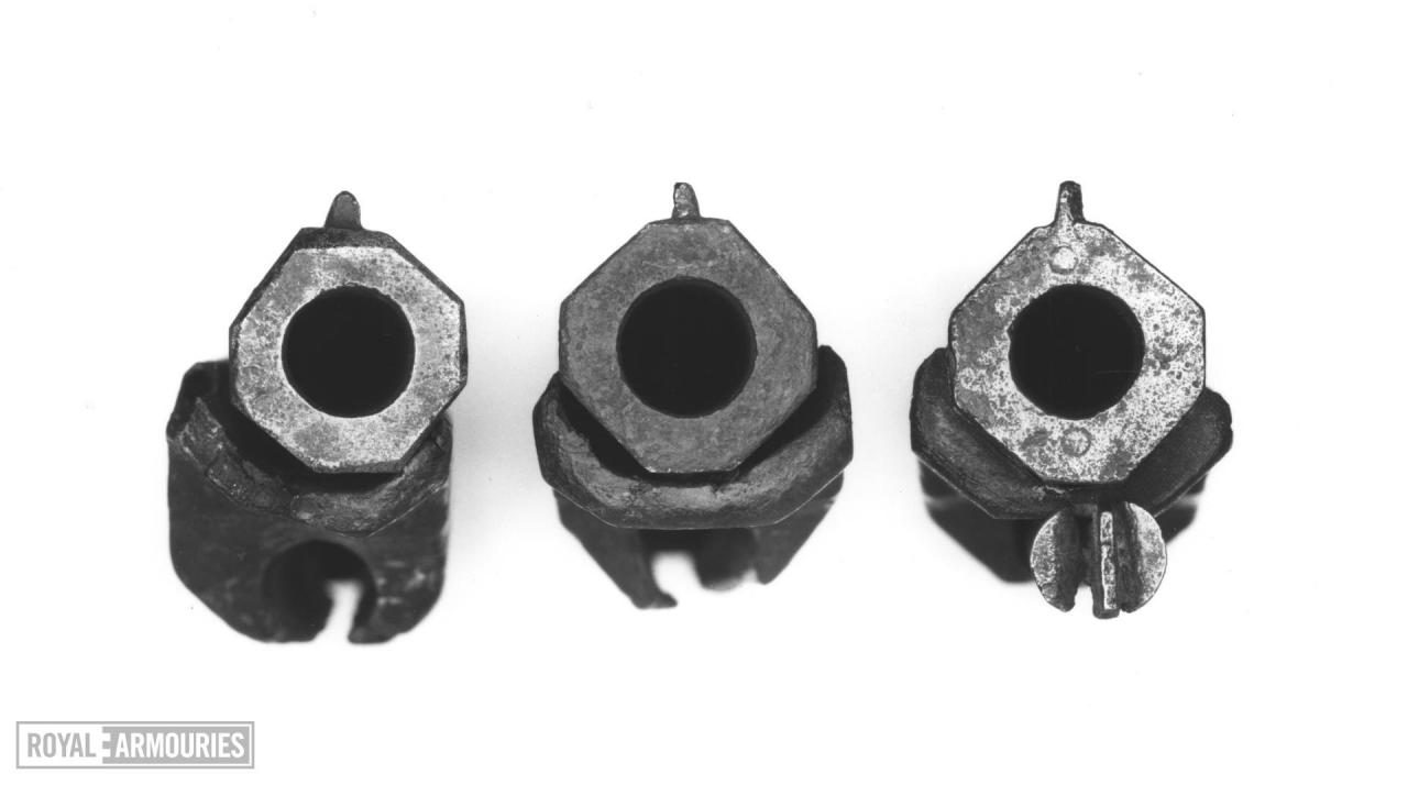

By chance i found these at the Royal armouries website and thought it well to show them and lift this thread up, once more to be enjoyed.
All pictures in this post are copyrighted by the Royal Armoury and are not to be distributed without their consent.
https://royalarmouries.org/collectio...t/object-28683
