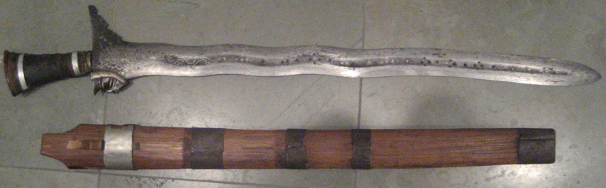

hello all,
here's a moro kris i find rather unusual. engraved on both sides are symbols i haven't seen on any moro swords. the closest i've ever seen these designs are on european swords, reason i'm posting this here. actually the more i look at it, the more i think the blade itself was of european origin.
regarding the blade:
it has a total of five flukes (two upper and three lower) on each side of the blade. also, a shallow fuller runs for about two-thirds of its total length.
as far as the symbols, here is how it's arranged:
both sides has seven crosses that reminds me of templar design. in-between these "templar" crosses are smaller crosses that is similar to a shuriken in design. after the fourth templar cross (counting from the handle, on both sides), there are some unusual figures that reminds me of masonic origin. one of these figures looks like an architect's compass, and also, there's an arrowhead looking thing with a cross inside. in the world of moro weapons, there are similar type of figures (arrowhead), but in moro weapons tradition, these figures point out, as in the sharp point of the arrowhead points toward the tip of the blade.; NEVER towards the handle. on this one, well, it seeks like it bucked the system.
anyone familiar with this marks? if this was indeed a european blade at one point, what country would it originally came from, and from what type of sword? also, what would be the age of the sword?

Hello Ron,
Congrats, I'm glad you snapped up this sweet kris!
Maranao, 2nd half of 19th c. seems right to me. The other kris you referred to still looks like a (mid 19th c. or a bit earlier?) Sulu blade to me. I'm afraid that I don't grasp very close similarities or is it mainly a feel/balance thing? Could you post a pic of both pieces side by side, please?
Frome the pics, I don't get the impression that this is a reworked European blade: The pamor at (or in front of) the sampir area looks undisturbed, especially visible on the left hand side; also the form and fullering of the blade does look like nice Moro work to me. Since some of the talismanic marks are situated inside the shallow central fuller while those at the base are engraved into the convex blade surface, I think that the chances that this is an European blade with original European marks are slim to none.
I believe this blade would benefit from careful repolishing and an even etch - this would certainly allow to verify its construction and origin.

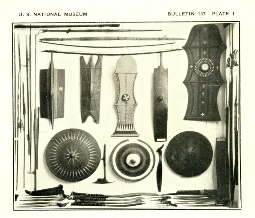

the bagobo shield (upper right hand corner in the pic) sometimes have cross-like symbols, too ...
i think i see where you're going with this, lorenz... geographically, how close are the bagobos with either the maguindanaos or maranaos???
i notice the pattern going down. could just be a coincident. i notice the shield smack in the middle as well...

the circle atop an inverted 'v' is also reminiscent of lumad iconography on their brasswork (the lumad kris pic is from erik farrow, and the top inset is from my lumad panabas) ...
