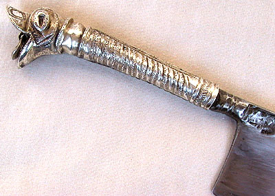

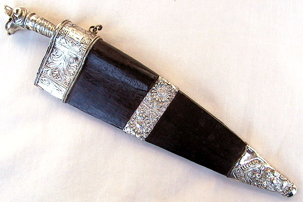

These are not very common and this is an unusually nice example of a small Kerala knife. The mountings are pure silver (and heavy) and the sheath may be original.
This is a fairly old knife, and the person from whom I purchased it claimed it was 17th C. I doubt it is that old, perhaps 18th C.
OAL = 10 7/8 inches
Blade = 6 1/4 inches (tip to bolster)
Hilt = 4 1/2 inches (bolster to end of hilt)

The "Kerala knife" is a style such as shown above, with a wide, dropped point, spear-shaped blade, a T-spine, and a sheath of similar shape that encloses more than half of the hilt. Hilts vary in style but arise from the back of the blade and there is usually a small bolster.

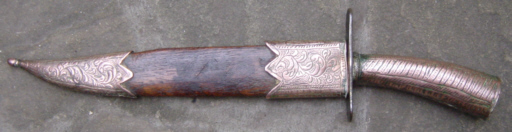

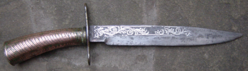

I have brought this to the surface because Lew suggested this bowie was from Madras which is the state of Tamill Nadu to the east of Kerala. look at the decoration on the handle. I am told by my brother inlaw who lives in Madras or should I say Chennai, that there is considerable cultural cross over/links and trade with Burma in the past. He is on the large side and said the food was very similar. I feel it is clear there is some relationship in the origin of these to knives.

Great knife -- very interesting mix of cultures. The hilt appears brass, and the cross guard looks European in style to me. But the blade is definitely Burmish. That koftgari style is typical of Burmese decoration, with the scrolls and spirals being characteristic (what is sometimes called "Burmese roccoco").
I'm going to speculate about this one because you mentioned trade between Burma and Madras (Chennai). I think this is a Burmese blade originally, that was later reworked and rehilted for a European. And I will suggest that the European was most likely Portuguese or British. Portuguese mercenaries were prominent in Burma, dating from before the Anglo-Burmese Wars in the 19th C., and of course the British assumed increasing influence in Burma during the 19th C. as a result of those conflicts. The remodeling of the blade in a "Bowie" style, the addition of a European-style cross guard, and a sculpted bronze hilt suggest adaptation for a Westerner; the wooden sheath is evocative of the leather European sheaths with silver mounts top and bottom seen in the second half of the 19th C.
All this suggests to me a late 19th C. origin for this interesting knife. Thanks for showing it to us.

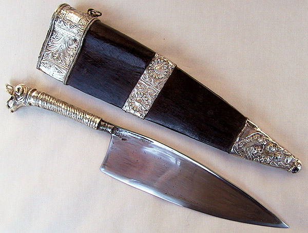

Here is one example:
with gold and silver inlay on the blade:
and another one:
It should be mentioned here that while traveling in Rajhstan, I have seen several similar ones where the dealers / owners claimed it to be a Rajhastani knife, but I im inclined more toward the Kerala origin

Thanks Artzi. I thought you had a couple of these. Beautiful knives.

How very helpful, although mine is a bowie style knife the scabbard could almost be from one of the other knives in it's similarity. Certainly a south India origin.

Ian, it's amazing how much that knife resembles in shape a modern chef's knife!
Could you slice and dice your enemies with that?
No doubt one could slice and dice very finely with that puppy.
