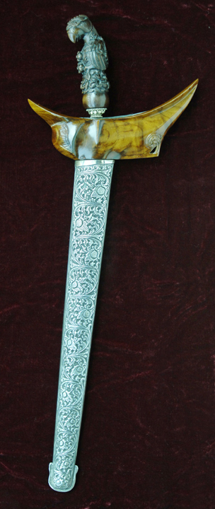

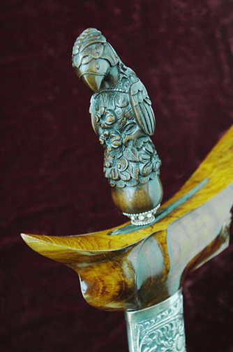

Old 7th November 2023, 05:40 PM   #9
Posts: 7,297
Here is an alternative take on formal Madurese dress from my collection. I believe this hilt depicts the same subject/figure.
Old 8th November 2023, 01:29 AM   #10
Posts: 7,228
In Jawa we call that style of wrongko "kacir", which means something that is thin/spindly, sticking up. It is a legitimate Madura & East Jawa form, but sometimes people will reshape a broken ladrangan form into this kacir form, expecially if the wood is a prized type of material.
