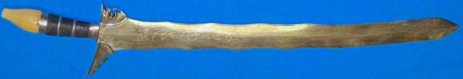

Greetings folks!

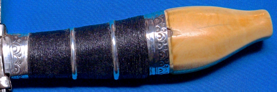

I now have this Maguindanao kris I believe from the 1920s. Although the luk curves are sharp, the ganga is separate. No laminations in the blade. The pommel is made of ivory and the mounts are silver (I made the ferrule to match and replace the missing one).

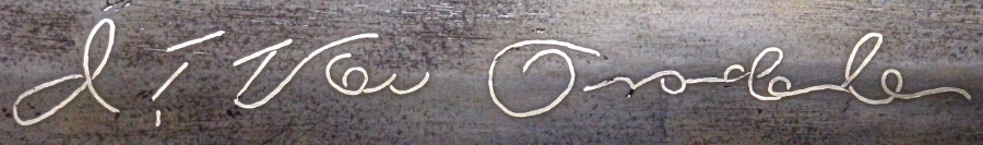

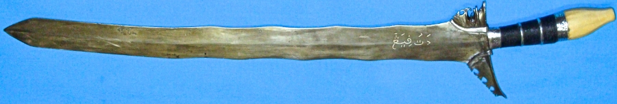

On one side of the blade is a name in Western handwritten script (which I can only make out some of it). On the other side is Arabic or Jawi script. Would someone help me in the translation of the Arabic or Jawi script please? (and also the Western script as well?)
By the way, the script on both sides seems to be made of white metal, odd (and harder to inlay).

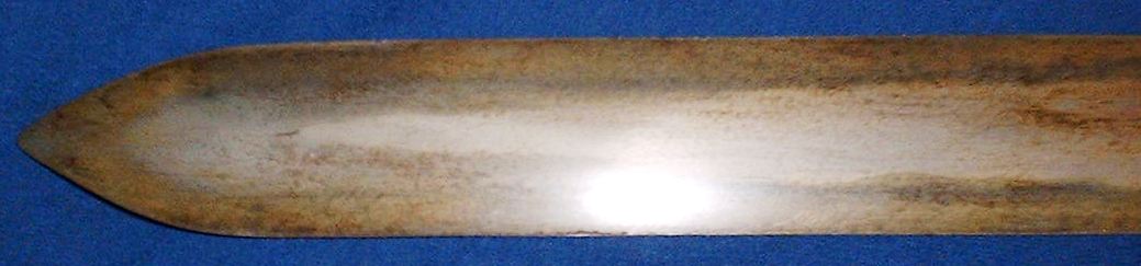

Very interesting angular point to go along with the sharp luks, Jose .
Old 29th January 2015, 04:20 AM   #3
Posts: 7,422
Tru'dat, Rick. I have owned 2 Maguindanao kris in the past that ended in blade points like this, one of which was this one:

The tip on the first is even more angular than the tip of the one just posted. While I have seen a few examples very similar to the the second kris posted, this is the first one I have seen where the tip is made with such abrupt angles as those shown on the first piece.

interesting kris! i always associate those pommels as more of a phallic symbol that tulips, lol. i've seen wood, but not ivory. also, i would say that it's older that what you credit it for, jose. turn of the century, at least... nice catch on this one!

can't help you with the Jawi part, but on the western script side, i believe it's a name. if i'm not mistaken, it says: "property of Ron, please return promptly if found". i kid, lol...
seriously, i think it says "J.T. Van Orsdale". J.T., or John Timothy Van Orsdale served under General Woods in Cotabato from 1903 to 1904. he was a colonel, and in charged of the 17th Infantry. after doing his tour, he stayed for another year in Zamboanga. he left mindanao in 1905, and i believe he went to Cuba after that. so going back to the age of this kris, if it's indeed his going away present, that would place this piece around the turn of the century.

Also according to Oliver Pinchot in an email, the Jawi says, " Datu Fi'cha" (spelling of the name might be a little off). I will now look for information for this Maguindanao datu.

1) it's J.T. Van Orsdale
2) regarding the Datu's name: i can't see it myself as Fi'cha. for one thing, there's no "F" nor "C" in the Maguindanaon language, so we can go back to perhaps the name was spelled phonetically. long stretch, but it could meant Piang. you could start your research by looking for how Piang wrote his name in Jawi, or even in Arabic script.

Thanks Ron. I was writing quickly. The name has been corrected.

Got a final Jawi translation from Oliver (he found an link to Jawi, Oliver also reads Arabic) and he translated the name to "Datu Fiang" which in Maguindanao would be "P"iang (no "f" in Maguindanao as Ron mentioned), which means that this piece says and is from:
DATU PIANG! From him to Van Orsdale.
Now we know both the giver and recipient. We know the story and have documentation of both men.
This makes the 2nd sword I own that once belonged to Datu Piang. I am a very happy camper.
