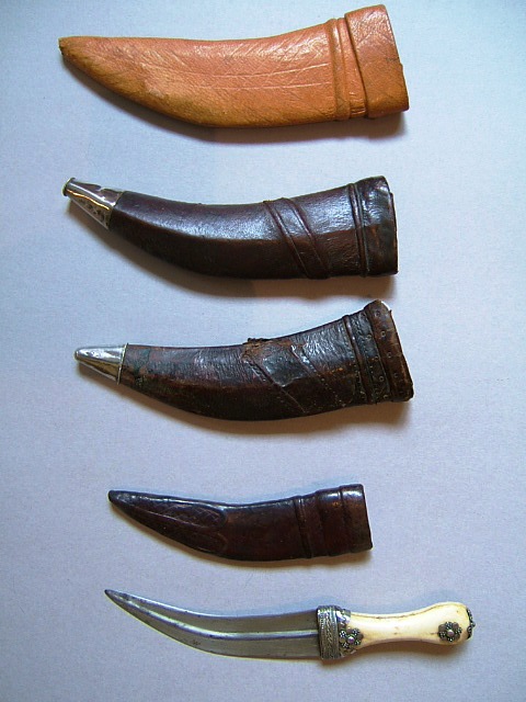

Hi All

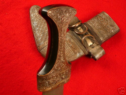

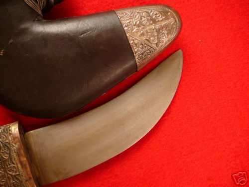

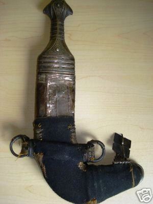

Lately I been asked by a few people about how you tell the difference between older jambiya and ones made after the middle 20th century. I will attempt to explain the differences. The things you need to pay attention to right off the bat is the blade. Newer blades made after the oil boom of the 1970s often exhibit a central rib that looks squared off and pressed rather than rounded and forged to shape also the tip on the older blades some of them were imported from India seem to have the rib terminate just behind the point with the last 1/4 inch having a radiused tip that reinforces the tip during penetration. The next thing to look out for is the quality of the hilt most newer hilts have sheet brass coin like discs rather than real old coins or nail work and the band just below the blade is often of poor quality. You also must pay attention to the scabbard quality a general style which change from era to era below the top scabbard is recent the two below that one are 19th century and the small one is circa 1940-50. Below are some examples of Yemen jambiya all but one are late 19th century pieces. The example with the brass discs is 1970-90 vintage you can see the difference in quality the older versions have a mosiac of silver studs which were very labor intense to apply. I will be posting other examples from different regions in the Middle east in the future.
Lew

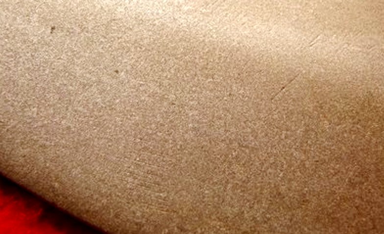

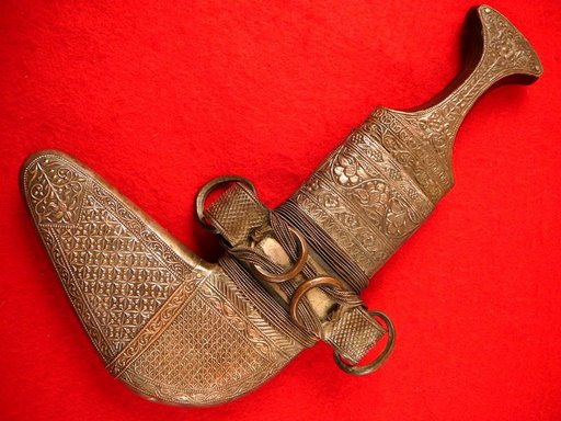

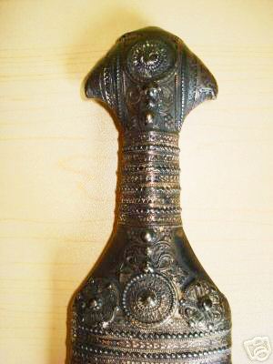

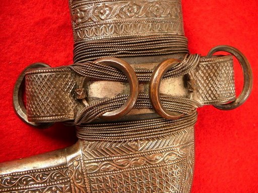

Hear is an Omani jambiya that sold today on ebay and it seems highly suspect to me. The embossing seems to be stamped out the blade for some reason was etched to give it a wootz effect but I can see no pattern and there is no central rib in the blade. The leather is newer looking without any wear. I would place this piece around 1970-80. The jambiya at the bottom also just finished on ebay and to me this one is a true older piece late 19th century. Notice the older style blade good quality silver work and good wear as if it had been carried a long time by it's original owner.
http://cgi.ebay.com/19th-early-20th-...d=p3286.c0.m14
Lew
Old 17th June 2008, 04:21 AM   #10
Posts: 7,416
Lew, I agree with you 200% That other newer one - BLEHHH!

The blade on the more recent Omani is very strange. There does seem to a central rib....all be it very 'unpronounced', the blade edges are rounded The 'wootz' pattern is very indistinct but is very fine, faked acid etched wootz is (AFAIK) much coarser and its surface 'ridged' The blade's mat grey apearance certainly suggests its been 'etched'...perhaps too agressively with a more consentrated acid ?
If this blade is definately not wootz ....has someone deliberately or accidently create the 'look' of 'the possibility of wootz'
In general I was informed that mid to late 20th C Jambiya's had sheet metal blades ie two halves welded/braised together. Is this the case for the mass majority manufactured at that time. As this blade looks 'solid'.
Regards David

Dave
Not all mid 20th century blades were made of two halfs welded together. This blade has a shallow diamond shaped grind to it and not a raised forged rib as seen in the other example. So this blade was probably made via stock removal. As far as I know Arabian,Yemen and Omani jambiya were never etched they always show a high degree of polish. This blade looks as if it was purposely etched or over etched to give the blade either a wootz look or at the least an older look. This seller often comes up with blades that have been recently etched just to show off a particular pattern even if it's shear steel so he can say it's damascus. It's like using the Zulu term on any African piece it seems to stir up higher prices people here the word wootz and they start to flip out. It's like Sy Syms always said "An educated consumer is our best bet"

for clarifying the situation. I can see now, that stock removal is most likely. I have seen some shear steel blades that when etched gives an 'indication' that its wootz.
