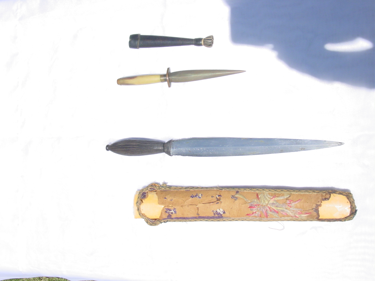

I recently acquired this dagger as part of a group knives. This one in particular is outside my field of study so I am at a loss for what it is exactly. The dagger is 17" long total, with a horn grip. As seen in the pictures one side of the blade has a central ridge while the other side is flat. I would really appreciate some help with the who, what, when, and where of this piece. Thanks in advance for any insights.

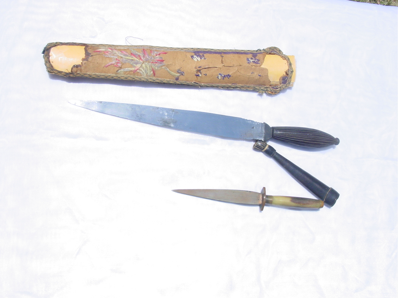

HERE ARE TWO KNIVES I HAVE WITH THIS THREE SIDED BLADE CONFIGURATION. FLAT ON ONE SIDE AND WITH TWO SIDES MEETING IN THE MIDDLE FORMING A THICK CENTER RIDGE. THE LARGE OLDER ONE IS DEFINITELY CHINESE THE SMALLER I AM NOT SURE OF. I SUSPECT THIS IS AN OLD CHINESE FORM THAT MAY HAVE BEEN SPREAD BY CHINESE MERCHANTS AS THEY TRADED MOST EVERYWHERE. PERHAPS SOMEONE WILL HAVE A CHINESE NAME FOR THIS FORM OF BLADE. AS FAR AS I KNOW IT IS NOT A COMMON FORM.
