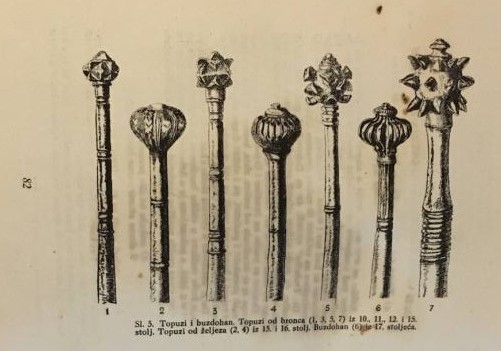

a few more cold arms pictures from an old book I have, published in the former Yugoslavia some 8 decades ago: "Oružje starih hrvata", by Milan Praunsperger.
If you understand some of any of the Slavic languages, it is quite easy to read. If not: google translate will do 80% of the job for you and with your knowledge it will easily be 98%
