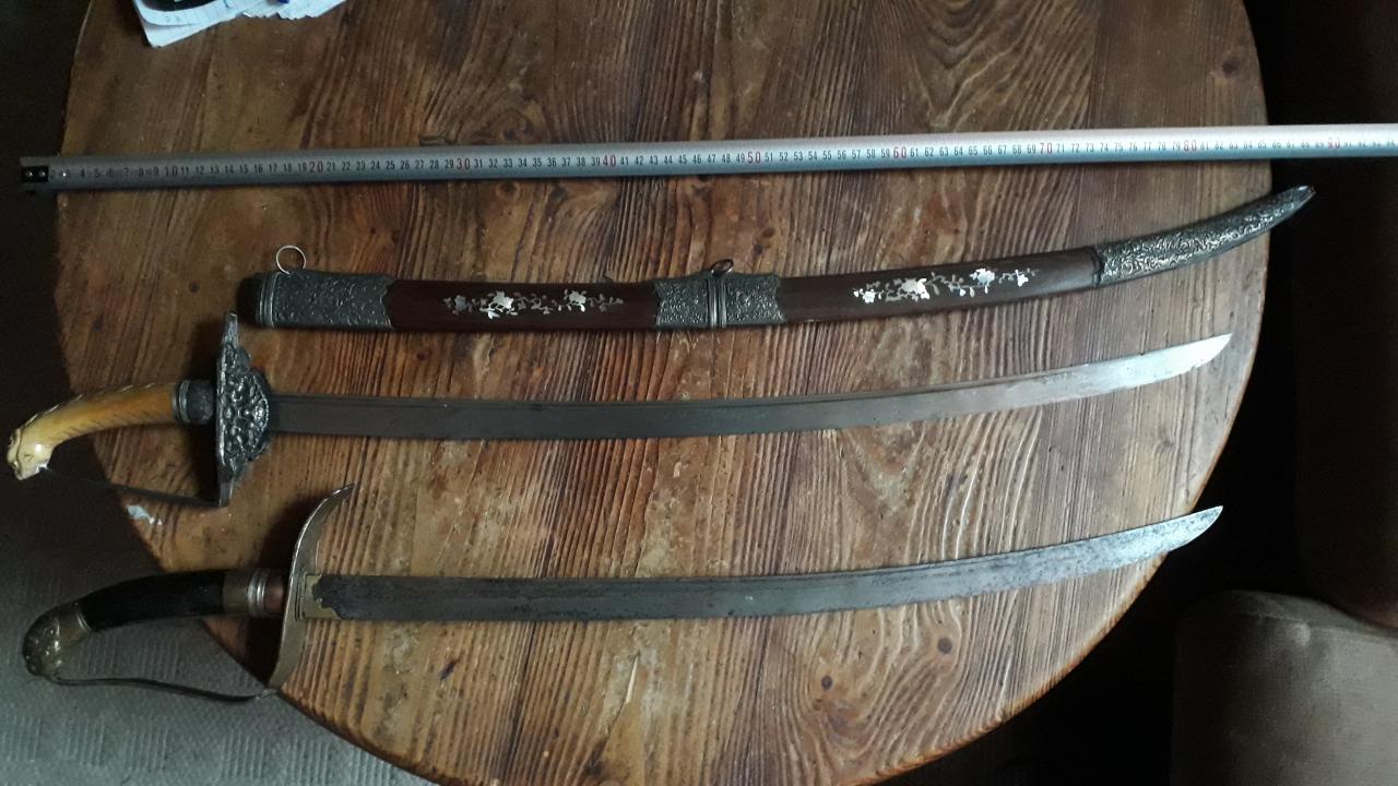

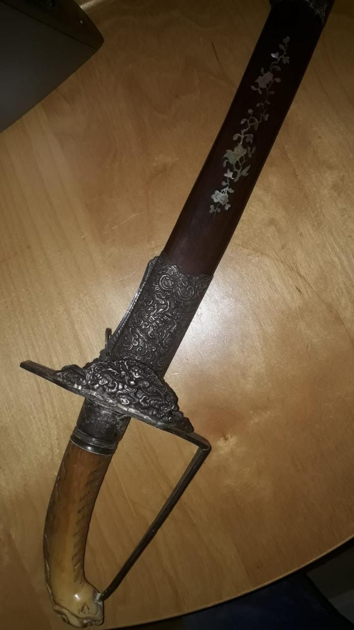

I picked up a slightly unusual guom officer's saber last month (or at least, that's what I think it is).

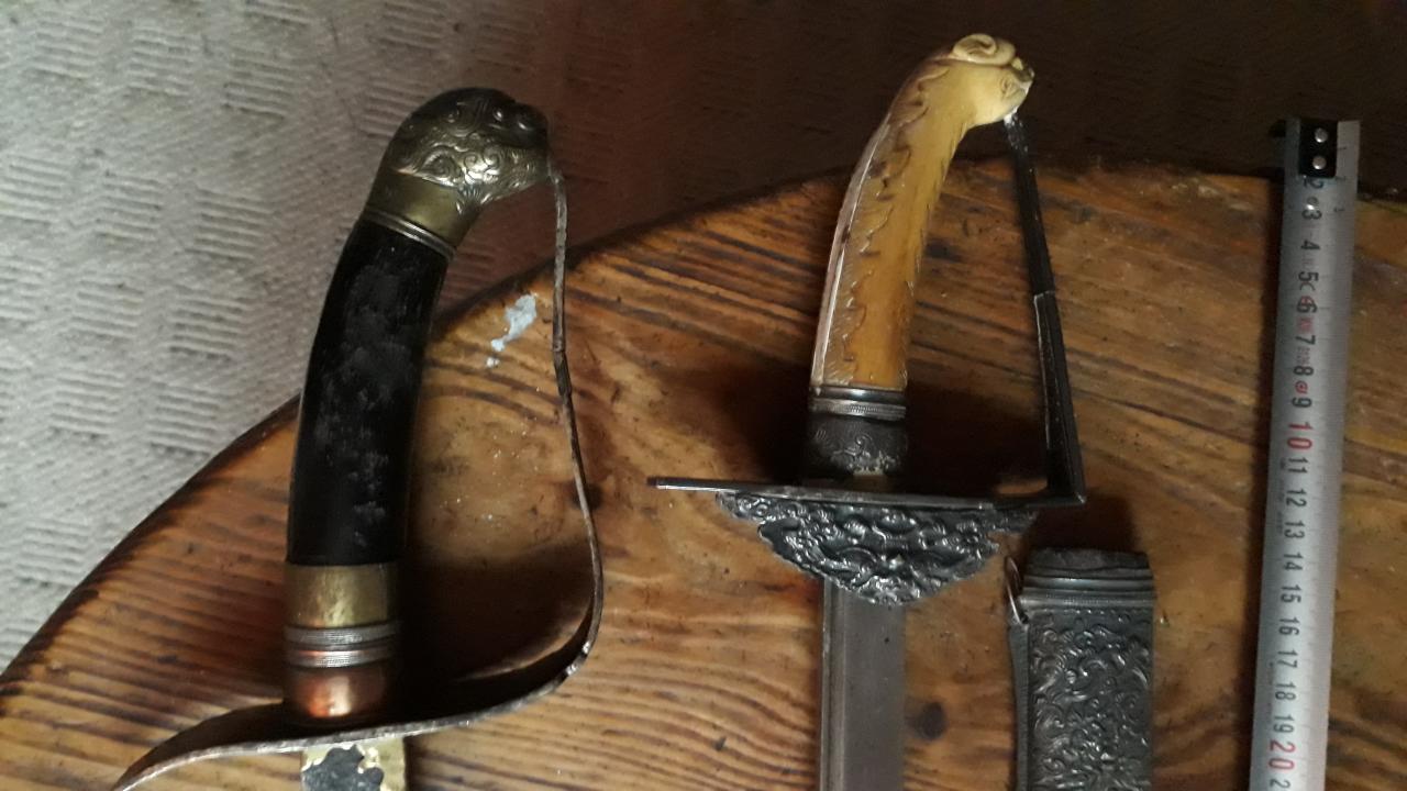

I've had one without a scabbard for a while, shown for comparison (with the dark horn grip).
The "new" one has a (what looks to me like) ivory grip, with an admittedly somewhat ugly old repair (it looks like it was once split and then glued back on rather crudely; the whole guard could use some cleaning). I suspect the lion(?) head pommel may once have had inlays in the eyes. It looks a little bit stoned with that smirk.
The blade of the new one has considerable girth near the guard but it tapers quickly and the blade is otherwise quite thin and light. It has some geometric patterns of decoration. It looks like it's laminated, though it's hard to tell from the pictures since my phone's camera is not great.
The one I already had does not have much distal taper, and it has a fuller running down the spine and is somewhat shorter and even lighter than the new acquisition. The new one lacks such a fuller. Both have solid connections between the grip and the blade, but loose guards. Both are rather sharp.
The scabbard is decorated with mother of pearl inlays and silver fittings with both scrolling patterns (strikes me as waves or clouds or maybe floral) and a somewhat hidden dragon meandering through. Demon faces on the "plates" that are attached to the guard (not sure what these are called; they also show some signs of an old repair). The chape has a few dents and may be missing it's very tip. One of the rings is a modern replacement.
I hadn't seen one with these kind of decorative plates on the guard before except in one unclear museum photograph that had a subscript calling it an "Ayuddhaya sabre" somewhere on this forum in a thread that I can no longer seem to find (so I've attached it). Are these a common feature?
Your thoughts would be appreciated.
Also if anyone can recommend a good overview book for continental South East Asian swords I'd appreciate it, as I don't have much reading material on swords from this part of the world yet.

Congratulations on an unusual and complete specimen with good quality silverwork and scabbard inlay. As you say, the forward-projecting plates on the guard are a distinctive feature; this is the first example of a guom that I've seen that has these. I can't vouch for the Ayutthaya attribution in the museum catalog, without corroborating info it sounds a bit outlandish to me. There were military confrontations between Siam and Vietnam in the early 19th cent., there are Thai silver-mounted dhas in the historical museum in Saigon which were capture pieces modified by the addition of Vietnamese silver-inlaid disc guards; I'm sure that the one in the possession of the Thai prince's estate might have been a trophy from one of those encounters as well.
These sabers were ceremonial regalia used by military officials of Vietnam's Nguyen Dynasty (1803-1945). An officer's attendant carried the sword, in its scabbard, while on parade and at official functions; otherwise it was displayed on a stand at the entrance to his residence or tent. They are thus depicted in numerous historical photos taken during the French colonial period; because the sabers were not intended for use or to be drawn from the scabbards during ceremonies, the blades were invariably lightweight. Late specimens are even found with brass blades.
Years ago I used to own a soldier's field-service version of this pattern, the hilt similarly carved of dark horn, with the knuckleguard being a shaped piece of horn as well. The cutlass-length blade was stout with a well-tempered edge and a Chinese inscription (probably a workshop name) at the forte. I acquired the weapon without scabbard but I imagine that the original would have been brass-mounted of plain hardwood with the fancy work. Unfortunately I can't find a photo of it now.

Thanks! Yes, I was wondering about that Siamese attribution myself. Aside from the guard with these unusual plates, the saber as a whole and particularly it's scabbard scream Vietnamese guom to me, but as noted I have little knowledge about swords from this part of the world outside of what I've read on vikingsword and on Mandarin mansion. But I included it since it's the only other example I've found so far with this style of guard.

I congratulate you on acquiring this excellent sword! Thank you so much for showing us all the photo of your unique item! Never before have I seen anything close to the same.
Now about the sad thing - there are still no specialized books on the historical weapons of Indochina. At least in European languages ​​and Vietnamese. The articles published on Mandarin Mansion are in my opinion the best choice for today, but they are not yet able to see the whole picture.
For this reason, the opinions of connoisseurs of Vietnamese weapons are largely subjective. And mine too.
I believe that the scabbard was made much later than the sword, in the first third of the 20th century. And the sword itself belongs to the beginning of the 19th century. The difference in the decor style of the silver details is striking to me. At the turn of the 18-19 centuries. in Vietnam, more precisely in its southern part, in the possessions of the Nguyen clan, there was a strong influence of France. And this is noticeable in the design of the sword - a protective bow and pommel in the shape of a lion's head. But this is not a copy of the French lion, but the mythical dog-like lion Nghe, often depicted as a protector and gate guard. On the hilt of the sword is a pattern of curls or tongues of flame pointing upwards. This is an interesting detail - in Vietnam there is a beautiful legend that when Prince Nguyen Phuc Anh, the future founder of the imperial Nguyen dynasty, was in exile on the island of Phu Quoc, his faithful companions and guards were dogs of the unique local breed Phu Quoc Ridgeback, which have a strip of wool along the ridge directed from tail to head. In memory of these dogs, the ornament adorns the back of sword hilts.
While on Phu Quoc Island, Prince Nguyen Phuc Anh negotiated successfully with King Taksin of Siam. Later, the Nguyen army, together with the Siamese troops, fought against the Tai Son rebels. Thus, at the end of the 18th century, the Vietnamese and Siamese were quite familiar with each other's weapons and it is safe to assume that a mutual exchange took place. And when, after some time, fighting began between them for influence in Cambodia, military trophies also appeared.

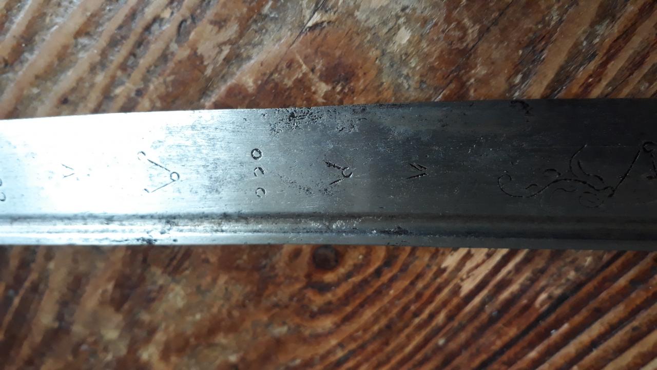

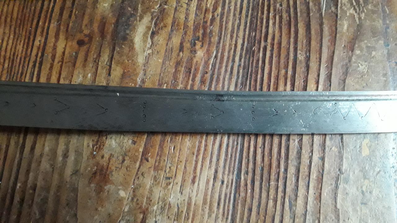

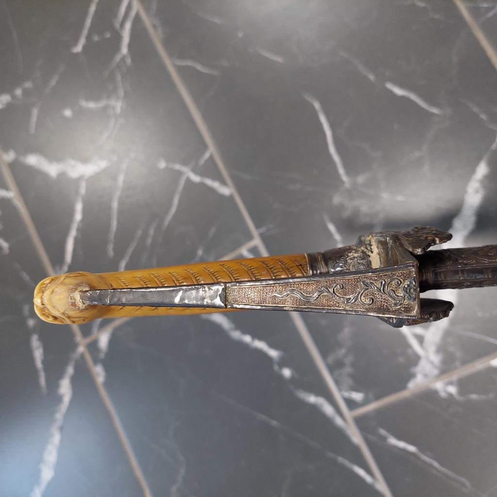

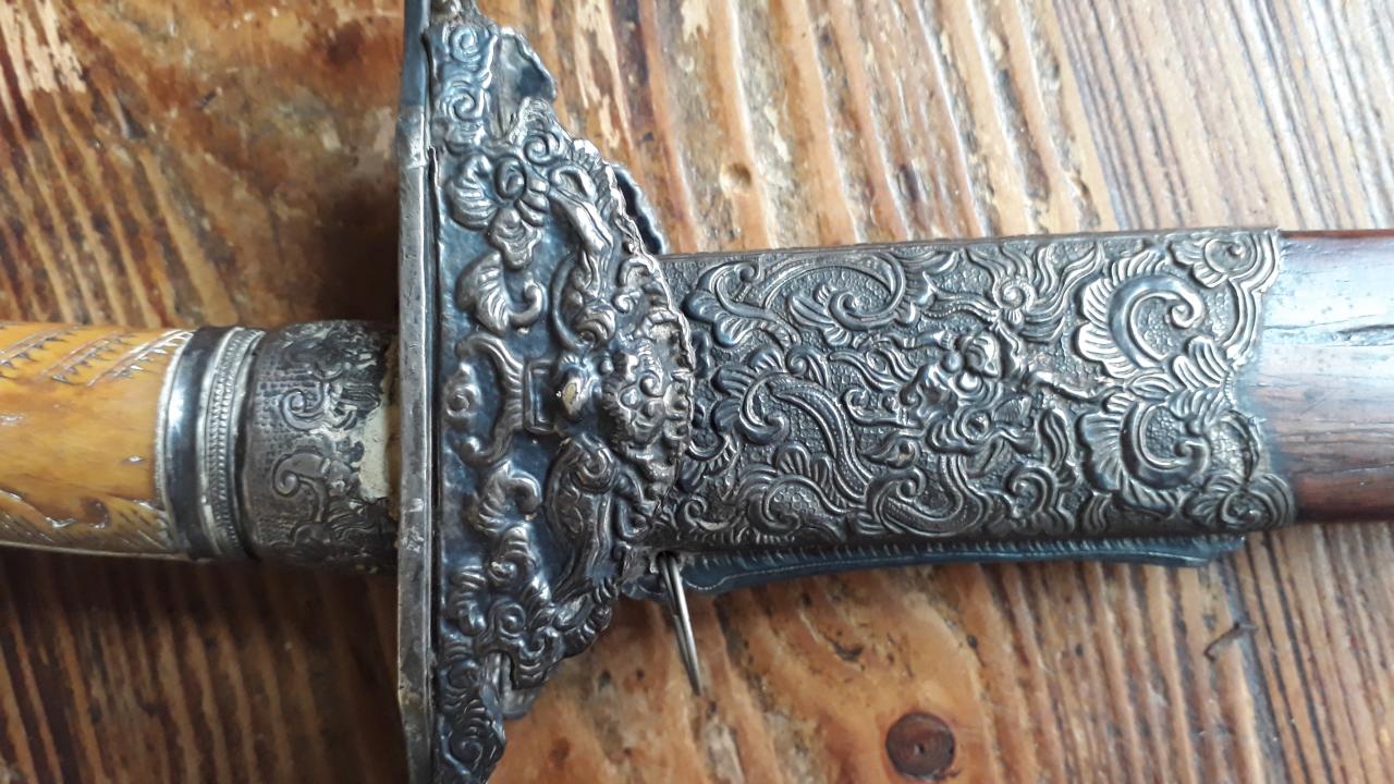

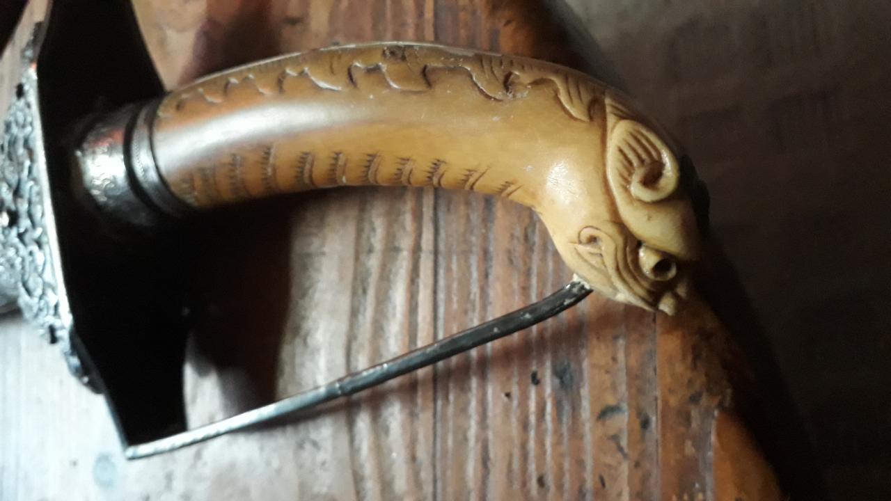

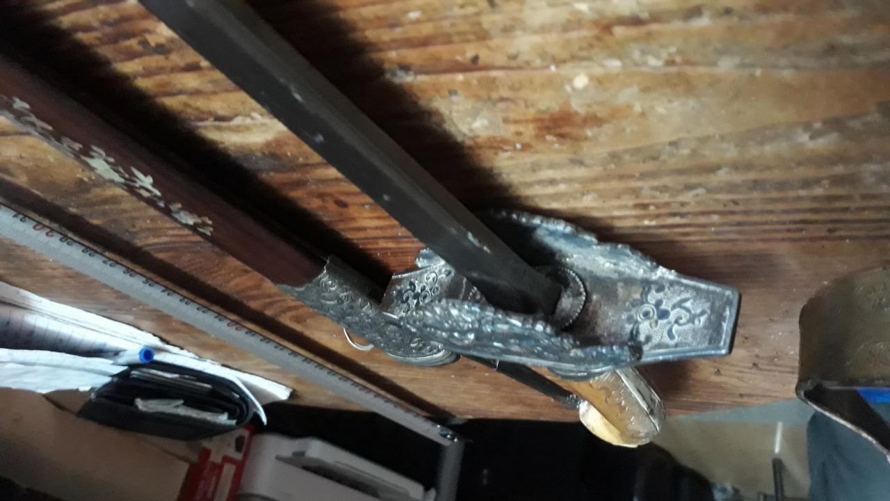

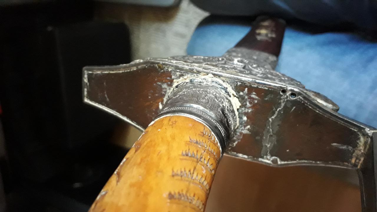

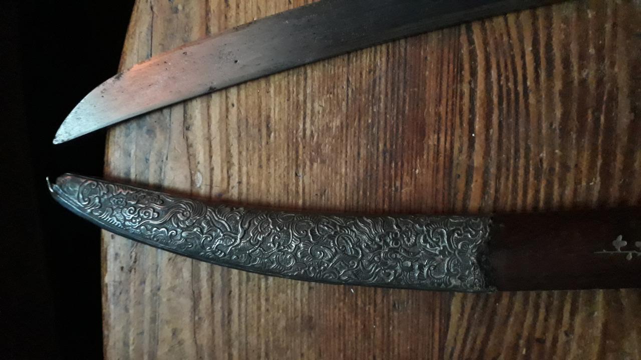

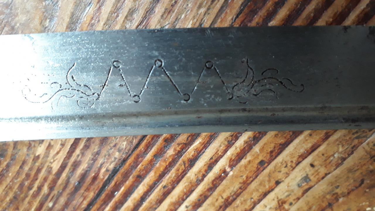

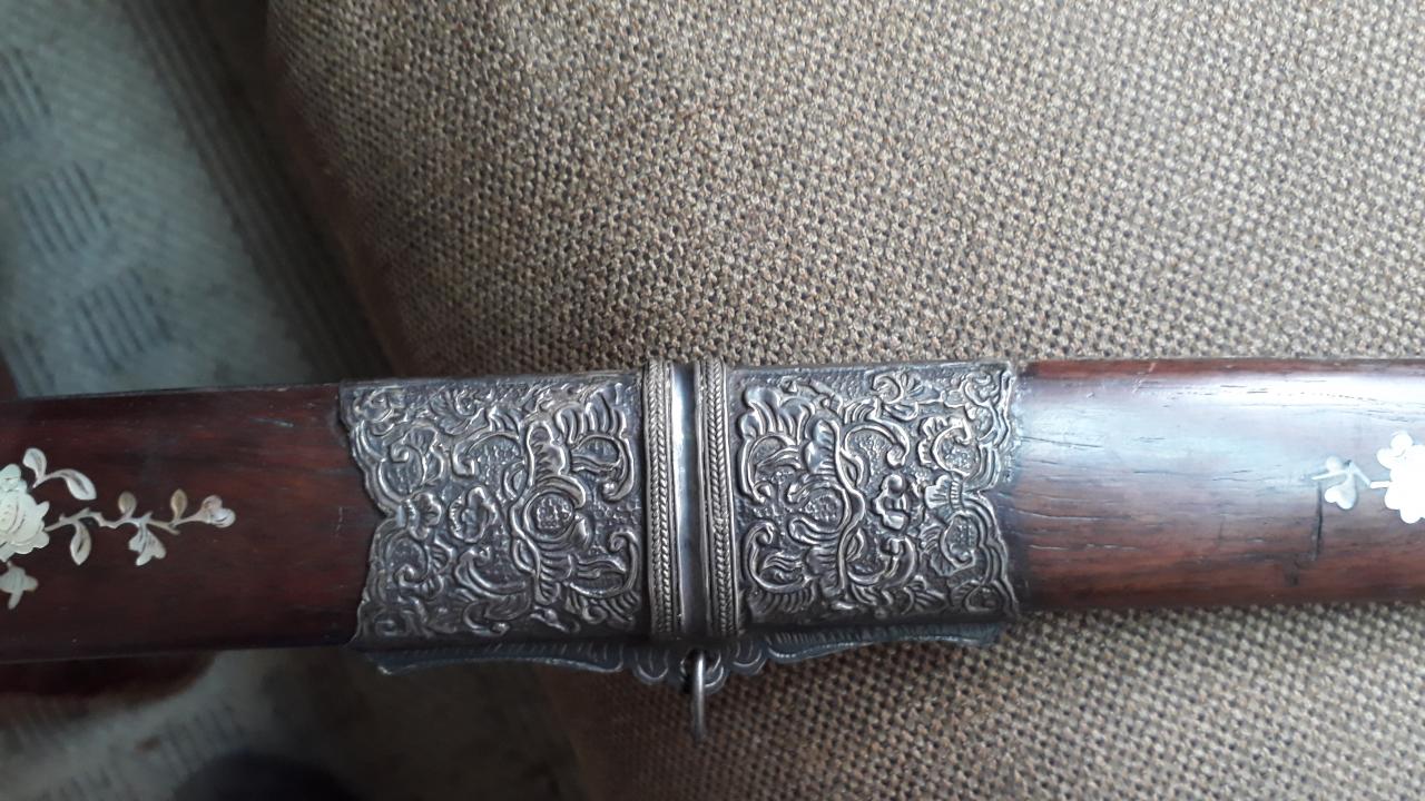

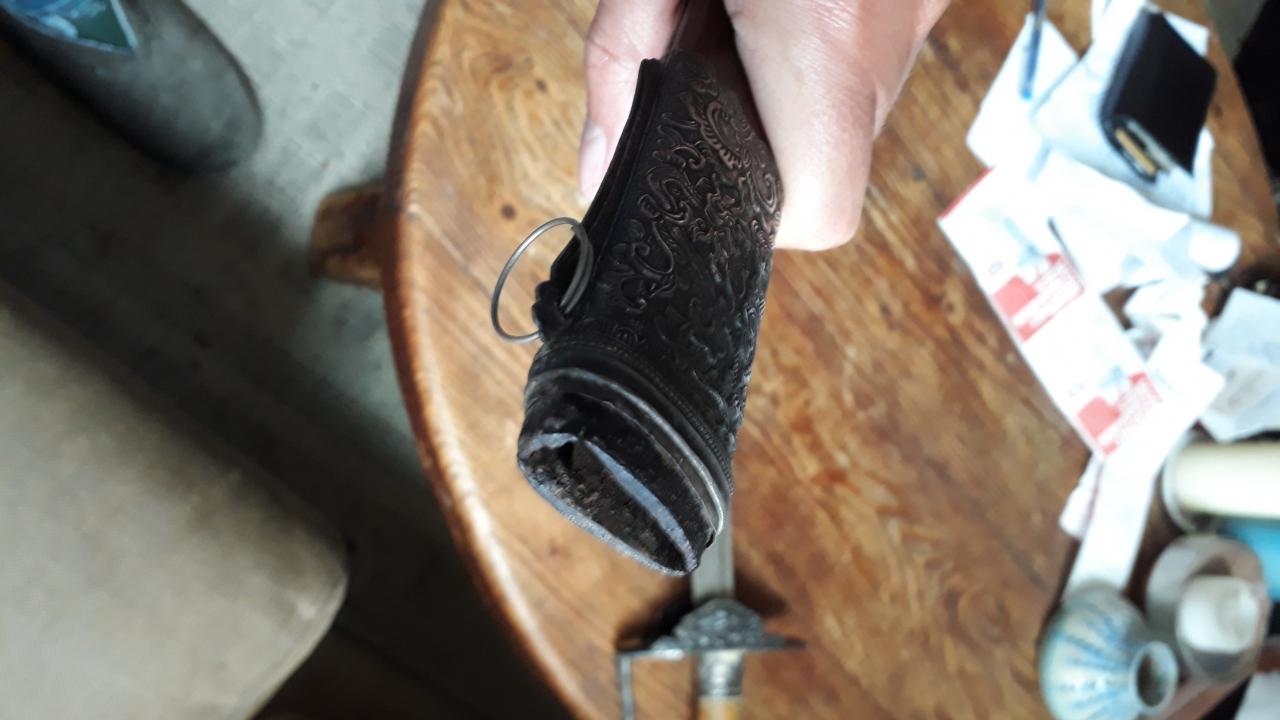

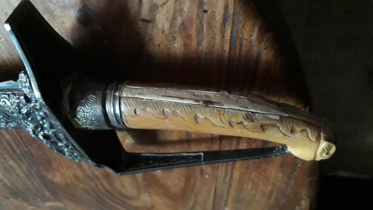

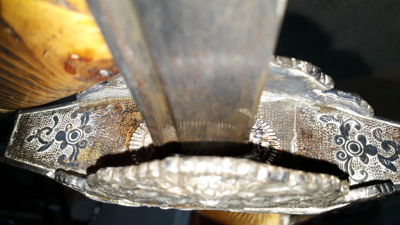

Well, 95% of my pictures were blurry again, but here are some of the less disastrous ones.

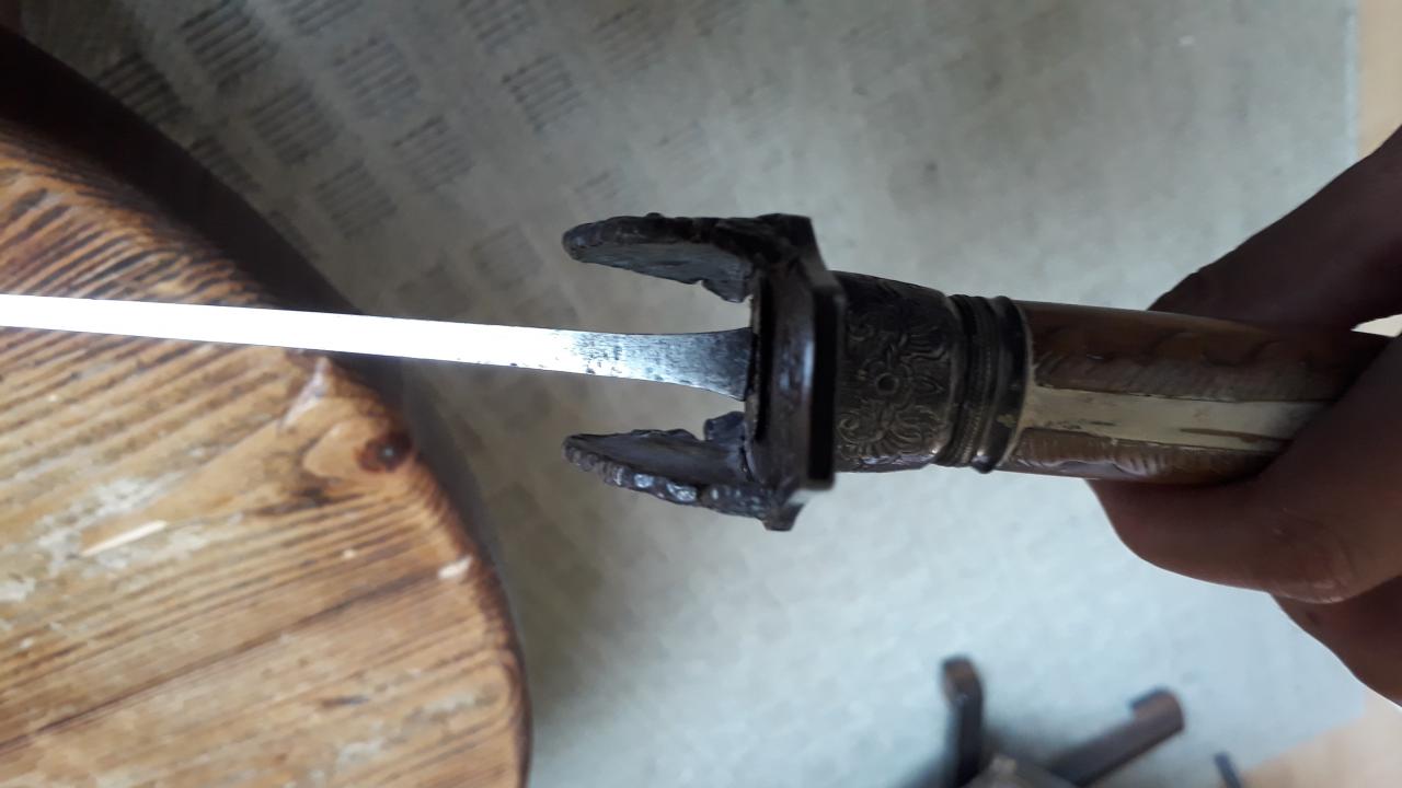

It's clearly undergone significant repairs to the grip. Something I failed to notice before is that it looks like the guard may have been broken and welded back together at one point. The sides of the crack line up well so I assume that the parts do belong together. It looks like the plates were riveted to the guard as can be seen in the pictures; the rivets are missing in one corner, leaving two little holes.
Some measurements: I can't quite get my calipers between the plates on the guard but the blade is about 2.6cm broad and 9mm wide at the base, then (distal) tapers quickly to about 5mm 10cm down the blade, then a gradual taper to about 3mm at the end of the fuller, then down to 1mm near the tip. The length of the blade measured from the tip in a straight line to the shoulders is about 67cm. From the tip to the peen is 81cm. 87cm total inside the scabbard. POB 10.5cm from the base of the blade. I don't have good scales here so unfortunately I can't give an overall weight.

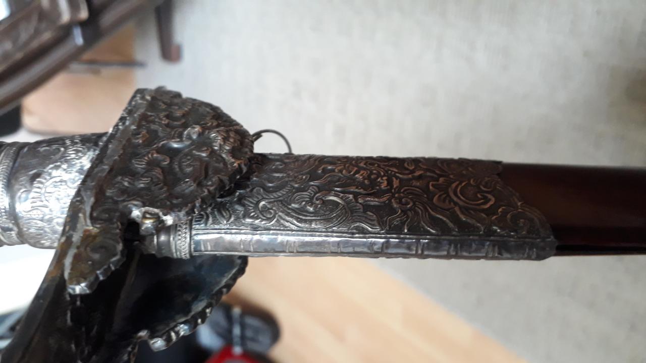

The scabbard grips the blade well enough to hang suspended from it by friction without support when I'm holding the grip of the sword, but not well enough for it to hold the sword in when I hold it upside down while holding the scabbard.
I wish I had a better replacement ring for the scabbard as it looks a little silly. }|:oP

Thank you very much for these photos!
I see that this sword had a long and hard life. But he is still a strong and cheerful old gentleman
In my opinion, the blade is quite typical for this part of Indochina. The decor is a stylized image of the constellations. The same or very similar ones were depicted on ancient Vietnamese flags, which, for example, were used in Nam Giao - the ceremony of sacrifice to the Earth and Sky. On Chinese blades, the stylized image of the seven stars of the Big Dipper can often be seen, but this is the first time I see it on a Vietnamese blade. And the style itself is different from the Chinese.
The crack on the handle looks too regular and symmetrical for accidental damage. I can assume that there used to be a decorative insert in this place, for example, a silver stripe.
Thank you for the wonderful input so far, it adds a good deal to what we know about a field about which so little reference material exists.
On this blade, yes, the arrangement is different from the usual Chinese, but I still see seven "stars". As other readers are no doubt familiar with, the typical Chinese arrangement on double-edged blades is a simple zigzag to accommodate the overall shape of the space; on sabers you occasionally see them as inlaid dots, typically between segmented channels along the dorsal profile.

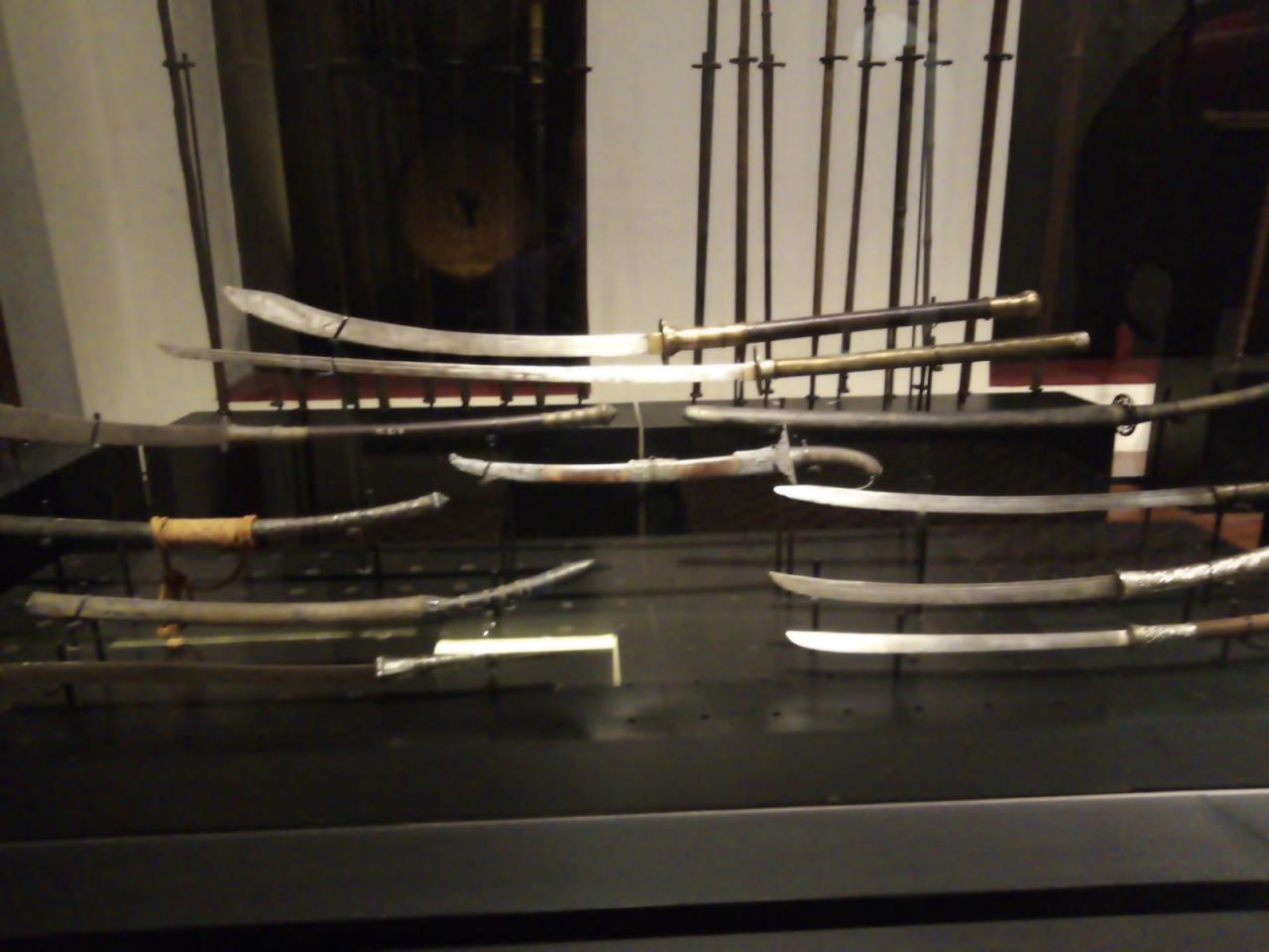

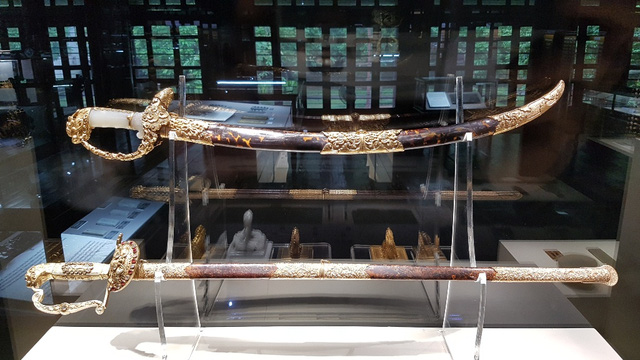

A friend of mine is currently on holiday in Thailand and he just sent me the picture attached to this post, taken at the National Museum in Bangkok. It's interesting to see that there are more of these around with those plates projecting from the guard.
EDIT: My friend is also interested in anything you might be able to tell us about the other swords (particularly the large ones in the back).

The large swords in the background are called trường gươm 長劔 in Vietnamese - a long sword or a long saber. In the late 19th and early 20th centuries they were exclusively ceremonial weapons and many painted and varnished wooden models survive. Here are some pictures from this period.

The second one from the top in particular seems to show strong Japanese influences. Is that a correct inference?

Quite right, werecow! Japanese influence was very strong in Vietnam and much of Indochina in the first third of the 17th century. Later, the influence also took place, but not so direct and strong.
I could only find a picture of one flag with constellations. But there were more of them and they were used during various ceremonies.

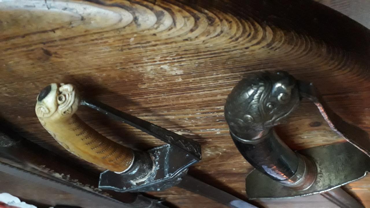

Originally Posted by werecow View Post
I look forward to reading it! If you want any more closeups of a specific part of the sword or the scabbard, let me know. }|)

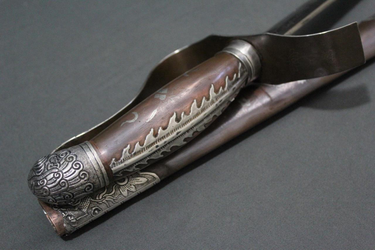

I apologize, the search process was somewhat delayed. Here are examples of guards with a shield that have a clear French influence.
And also an example of a hilt with an insert, where the curls are facing down. I'm assuming that this hilt was made much later than yours.
