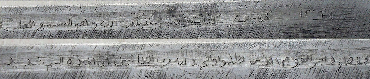

An interesting Golok, the poor finish on the blade in stark contrast to the amount of time they spent adding the long inscription on both sides.
The date puzzled me initially as it looked like a mix of arabic and western numerals, but a closer look seems to show that it's 1365 Hegira, which would be 1945 gregorian.
If someone could please have a look at the rest of the inscription. It's clearly done with some care.
Thanks
Gene
Old 12th June 2011, 12:18 PM   #2
Atlantia
Atlantia's Avatar
Join Date: Jun 2008
Location: The Sharp end
Posts: 2,928
Inscription side 1.
top right joins to bottom left:

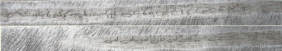

Old 12th June 2011, 12:19 PM   #3
Atlantia
Atlantia's Avatar
Join Date: Jun 2008
Posts: 2,928
inscription side 2.
Top right joins to bottom left:
Old 12th June 2011, 12:25 PM   #4
A.alnakkas
A.alnakkas's Avatar
Join Date: Nov 2010
Location: Kuwait
Posts: 1,340
Beautiful! Quranic verses on most (I think)
The first picture (its on reverse)
Its: Nasrun min allah wa fat'hun kareeb, Wa bashir al mu'mineen. Wa ma ramait ith ramait laken allah rama Which means : Close victory from God and close conquest, so give glad tidings to the believers. (then it moves to another quranic verse) If you have shot your bow, it is not you who have shot, but it is God.
Bottom inscription makes no sense to me except for the repeated "Ha Mim" which are 2 letters common in Quran that no one understands.
Will try to translate the other photo's soonish.
