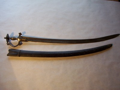

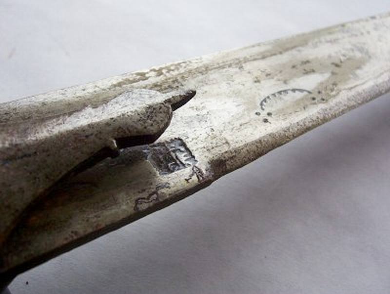

Hello- Can anyone tell me anything about the markings on this fine tulwar? High quality blade measures 31.5 inches.
Cheers
bbjw

Hello, hard to make out, but I think your tulwar may have the Mazar-i-Sharif stamp...cannon and minaret.

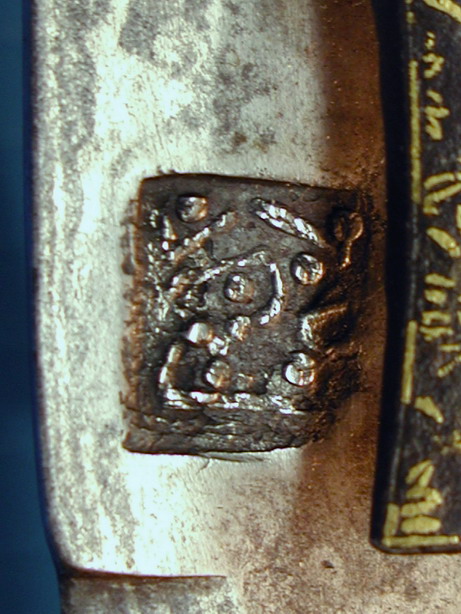

Enlarged and sharpened.
Not so sure this is a Mazar stamp.

The details shown are from two different tulwars. The square stamp is deep, so it must have been made then the blade was still warm, which could suggest a smith’s mark or maybe an armoury mark – but both suggestions are pure guessing.

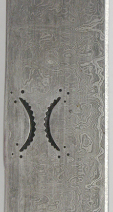

The other detail, the ‘eyelashes’ with the three dots at each end could be a copy from European blades, a kind of ‘quality mark’, or they could mean something else, as they are used with the three dots, which are relatively often seen on Indian weapons, but not on European weapons, as far as I know. A funny thing is, that I can not recall to have seen the ‘eyelashes’ on dagger blades – can anyone else?

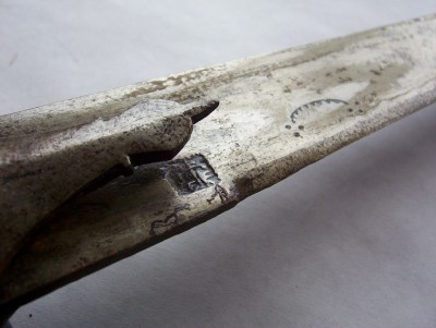

A very good example of a NW India tulwar, and the deep stamp near the forte of the blade is probably arsenal related, with the characters found in the cartouche typically in Urdu. As Rick has noted, the deep arsenal stamps for the Mazir-i-Sharif are found on the Anglo-Afghan military swords from the 1890's, and seem to have been associated with campaigns in NW frontier regions through the 3rd Afghan War.
The 'eyelash' (often termed 'sickle') marks are native interpretation of the early trade blade markings that seem to have derived from Italian blades, particularly Genoa, and diffused widely into centers in Styria, the Caucusus (where the stamps bring the term 'gurda' to the blade, meaning quality) and of course India (then including Afghanistan regions). The Afghan sabre known as the paluoar seems to consistantly have these 'eyelash' marks on the blade, though they do not regularly appear on tulwars. Therefore the thought of the Mazir-i-Sharif stamp, though not the case, does seem a good suggestion. Possibly this blade may have derived from the far northern Afghan regions near the frontier, while the armoury at Mazir-i-Sharif is further away.
Outstanding observation Jens!! You are right, now that you mention it these marks do not occur on dagger blades. While we know trade blades for swords were a common commodity, it does not seem that such trade existed for dagger blades..or did it?
