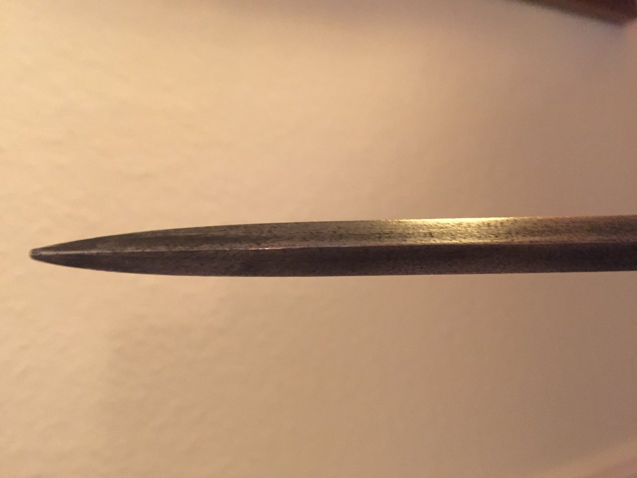

O.L. 127.5 cm ; blade L. 109 cm; blade width at cross 3.2cm
Passau wolf mark in one side.
Grip: made from horn (about 11 cm)
Blade: flattened hexagonal section With a Fuller running from the cross till the tip.
Pommel: Oakeshott type T
Cross guard 20.8 cm of square section
Type XVII would be the nearest type of Oakeshott who could correspond to this sword.
Période 1470-1530 ?
Any comment on it will be welcome.

Hi Cerjak,
what a beautiful sword! I am looking since years for such a sword.
In my opinion this is a cavalry sword (in german "Reiterschwert" for "Rider sword").
An Estoc is more massive and normally with a triangular or square cross section, designed for powerful stabbing through plate armour. Or more precise, designed to find the gaps in the enemy plate armour.
Roland

Hi Cerjak,
until now i only found this sword from 1547. I am sure, that an Estoc has no groove in the middle.
Your example of the ridingsword is quite unusual.
Can you check the weight please? The ridingsword weighs around 1450-1650 Gramm. The quality and value of a ridingsword is normally much higher than an Estoc.
I can see four possibilities:
1: a riding sword
2: a very early rapier
3: a symbol of authority (like the sword below)
4: a composite piece (improbable)
Best wishes,

HI Andrea
This sword is about 1260 gr.
Also the point of balance is 10 cm from the cross.
This sword is very well balanced Cornelistromp who had it once in hands could confirm it.

Hi Cerjak,
with a weight of 1260 Gramm, a blade length of 109 cm and the balance point you described, i would classify it as an early rapier.
The rapier is a further development of the longsword, the so called "hand and a half sword".
Roland

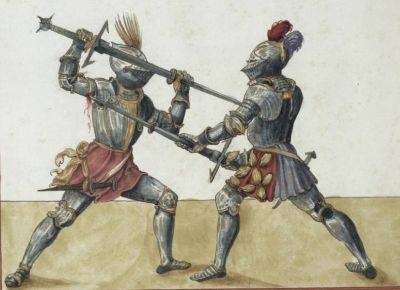

Hand and a half Estoc fighting during tournament. Note how the combatants are searching for the opening in the opponents plate armor
That is correct, but searching for openings is very different from the common perception of piercing the armor - which is plain impossible.
On subject of mail - there have been many, many attempts at piercing it, so generally speaking, a very thin blade in most cases fails to split even one ring on a high quality riveted mail. In few cases when it was able to, it certainly did not produce anything even close to a disabling wound. In order to produce it it would have to split many, many rings - remember, usually there was a gambeson under the mail.
Fortunately for the estoc owner, great majority of fighters didn't have such armor. So estoc was potentially quite effective in the battle, but not because it was able to pierce the plate.

The plate armor was developed due to the weakness of the mail armor and especially the weakness the mail has against trusting weapons. The above two History Channel documentaries explains this development.
In the drawing below it seems as the mounted rider to the left is penetrating his enemy's mail with an "Estoc" type weapon rather than an lance:
