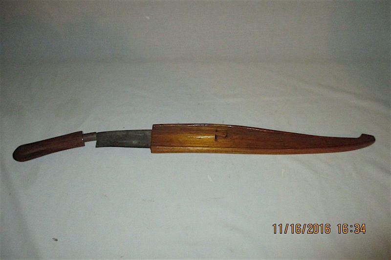

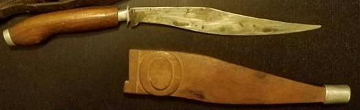

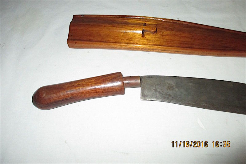

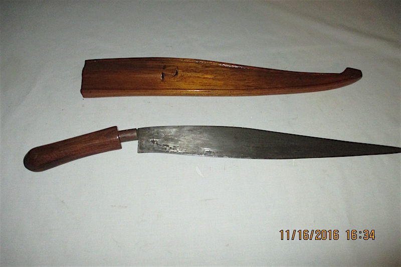

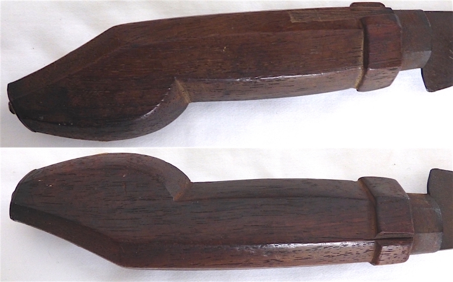

This is the second example of this identical knife that I have owned. I don't yet have this one in hand. However, its twin had an extremely sharp edge that was hardened. The small ferrule and straight cylindrical handles with rounded ends are identical on each knife, as are the scabbards.
The precise origin of these knives eludes me, but it appears to be SE Asian. I had thought that the first one I found may have been a custom made piece, but the arrival of its twin suggests this is a "style" that appears to be rare.
Any thoughts on their origin would be appreciated.
Ian.
Here are the seller's pics.

Hi Ian, can you give some measurements.
The piece certainly has a 'Philippine' feel to it..mostly.
The handle/ferrule set up seems a bit strange; but the blade profile would seem to fit within parameters for that area.
BTW
Nice knife.

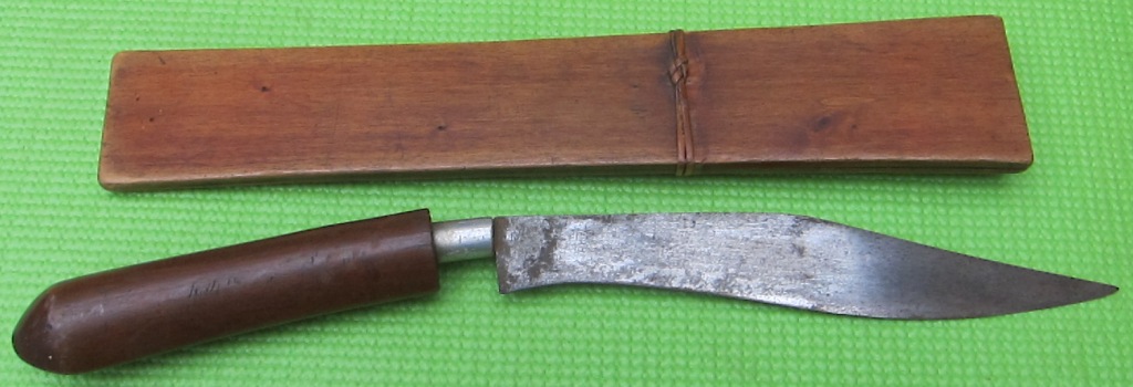

Hi Rick:
The only data I have is from the seller: OAL in the scabbard is 22 inches. The seller also thought it was from the Philippines, circa WWII, although there was no clear provenance linking it to the Philippines or to that period.
The absence of rattan bindings, or any binding for that matter, on the wooden scabbard would be unusual for a traditional Filipino knife of this size. I can't recall whether the other knife I owned had a scabbard that was glued or pinned together with small brads. Either way, not really typical Filipino work. The hilt and ferrule are unlike any Philippine knife I have seen. I should also mention that the hilt is not full tang, which would pretty much rule out Luzon.
The workmanship on each knife was considerably above average, and the scabbards have been well carved and finished carefully. There is no obvious suspension system for it to be worn around the waist, so presumably it was meant to be thrust through a sash or behind a belt.
Ian.

The scabbard and even the blade to a lesser degree looks a little Bicolano to me.
You are right, a rare version. Does the tang go through the hilt?

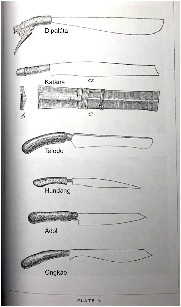

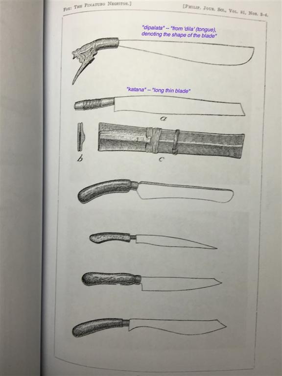

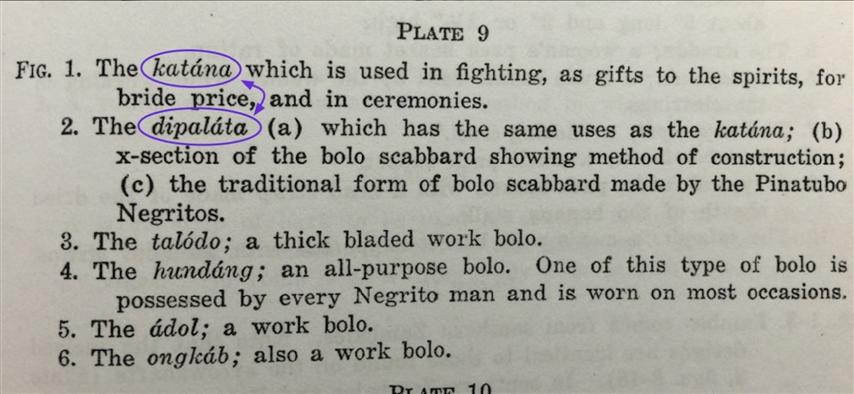

Hello Ian, I believe that this bolo with its blade and odd hilt and ferrule style is from Negrito and if I remember correctly is called a "hundang". Somewhere locked up on my old computer I have a photo that I believe shows this type of bolo, I just hope that at some point I posted it here on the forum and can find it again to post here. I will do a search and see what I can find.
Robert
Found it. Even though there is a slight difference in the shape of the hilt I believe that your bolo looks very similar to the one listed as No 4 on Plate 9 in this photo.

Robert:
Thank you.
This makes sense. The knife was among articles found in an old GIs possessions. The Pinatubo Negrito were located very near the Clark Air Force Base on Luzon, so it would not be surprising to find such a bolo being brought back by a U.S. serviceman.
I remember you posting this picture before, and I have tried to find the original reference but unfortunately my library cannot locate that particular number of the original journal.
Ian.

The information that I posted was photographed from "The Philippine Journal Of Science Volume 81 - The Pinatubo Negritos" which was most graciously sent to me by Lorenz. If anyone is interested in reading the rest of the material I have please let me know and I will email it to you as it is too large for me to post here.
Robert

Attached is my transcription of what Robert sent. It is incomplete and definitely not the whole article published by Fox, but it is everything that I have.
Fox appears to have been an ethnobotanist with expertise in the plants used by these indigenous people of the Philippines. If you don't fancy reading the Latin plant names, just pass right along to the general text. He describes, in considerable detail, the manufacture and materials used for men's and boy's bows and arrows, the creation and attachment of arrowpoints, the significance of different shaft lengths for the arrows, and even how to make and string the bow. In case you were wondering which vines were used for the bowstrings, it's all here in great detail.
The space devoted to edged weapons is small but informative. He provides drawings of various bolos (Plate 9) and gives their respective names and uses. The materials used to make the knives and scabbards are described, including the sources of the glues and resins needed to secure hilts, scabbards, arrow heads, etc. It would be nice to have the complete article (which seems to run to several hundred pages and may have been this guy's doctoral dissertation).
To help with orienting where the various groups are and the geographical features I've attached a picture of the Central Luzon Region. I have indicated Mt. Pinatubo, the site of the old Clark AFB, and the nearby town of Apalit in the Province of Pampanga. More about Apalit in a later post.
Very interesting reading this article, and I've enjoyed going through it in the process of transcribing the text. Because of size limitations on files, the article is split into two parts, one for the text and the second for the Plates.
Ian.

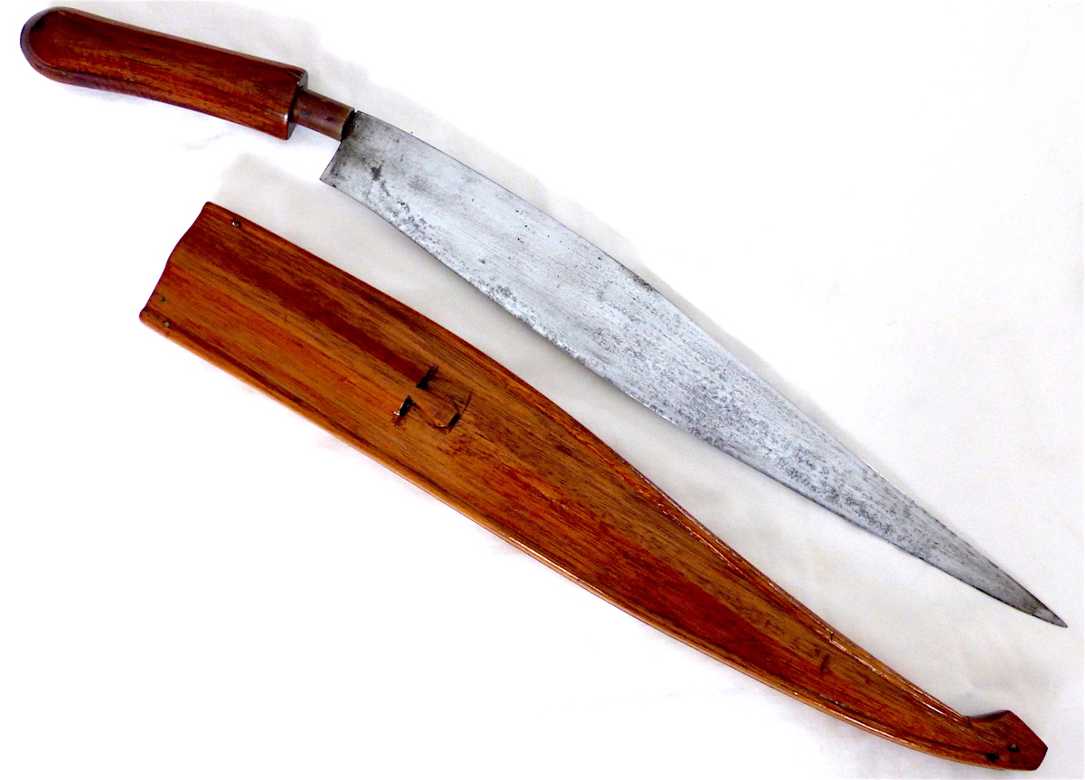

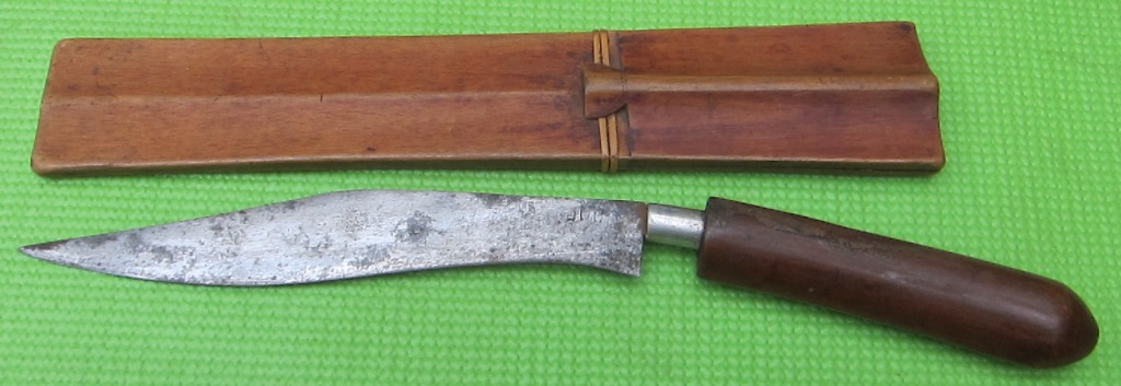

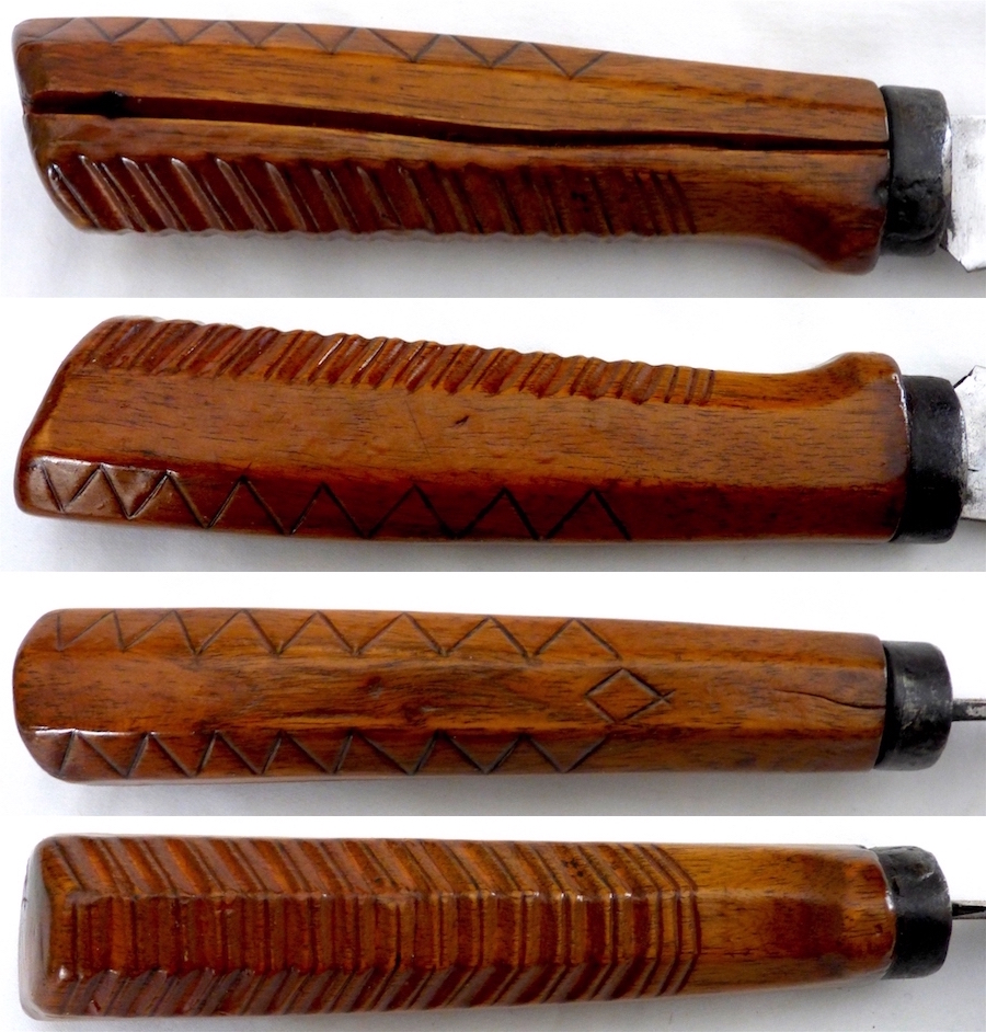

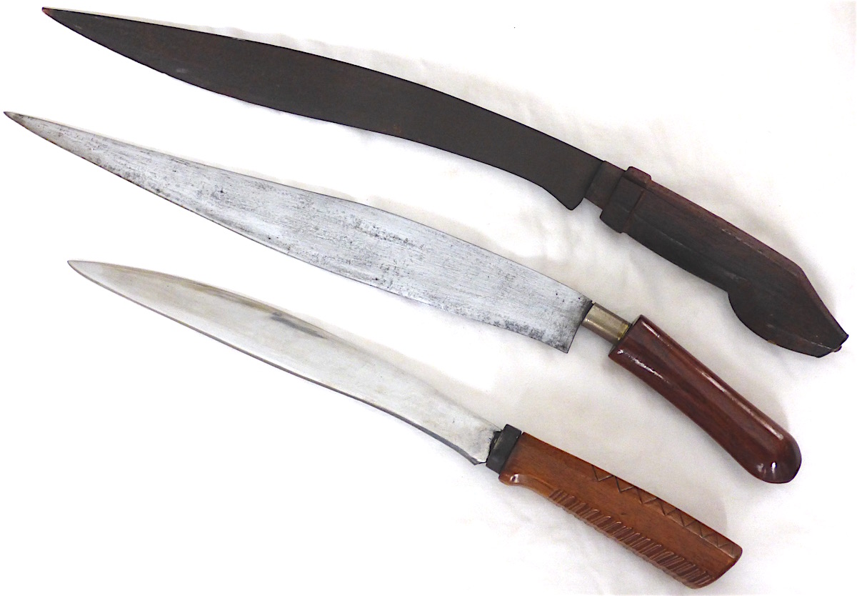

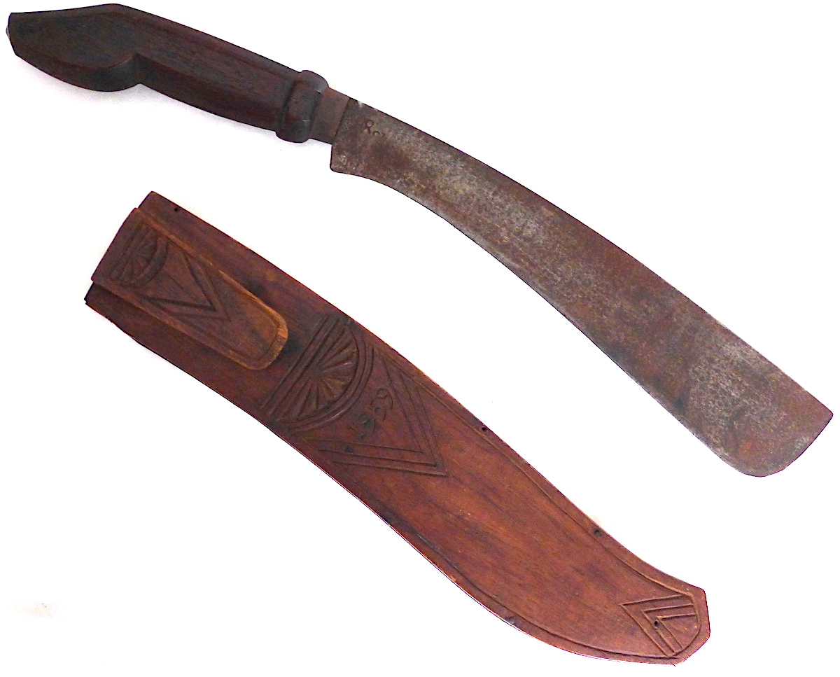

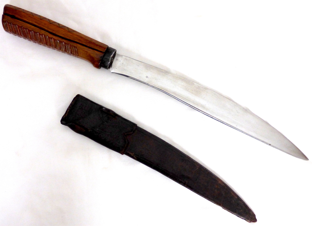

The "mystery knife" that started this thread is shown in the middle of three knives (see attached picture). Each of these knives shares some similarities:
  • The cutting edge is recurved
  • The spine of the blade is convex, curving down to an acute point
  • There is a short ferrule
Some differences:
  • The bottom two hilts have a blind tang construction and the top one has a full length tang construction
  • The ferrule of the center one is much smaller in diameter than the adjacent hilt, while the other two ferrules are slightly less in diameter than the adjacent hilt.

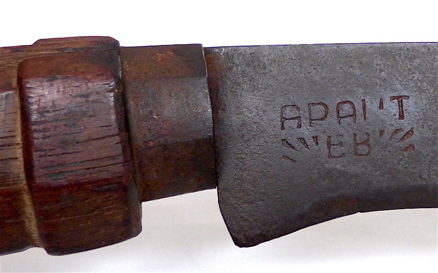

The top knife bears a stamped inscription indicating it is from APALIT. We have discussed these knives before, and the location of Apalit is shown on the map in the previous post here.
The middle knife is typical of the hundáng produced by the Pinatubo Negritos, as shown in Plate 9 of Fox's article. It came with a wooden sheath (see pics attached) similar to the sheath for a katána that is shown in Fox's Plate 9.
The bottom one is a recent acquisition. The blade has been polished to a mirror finish and has been professionally sharpened--this may well have been done by the U.S. seller of this item. It came with a leather sheath typical of Filipino manufacture, and the sheath shows some age (probably early 20th C.). I suspect this one is an upscale model of the top knife and may come from Apalit also.
I was prompted to put up these comparisons because of the similarities of the various knives. Leif (Rafngard) expressed the same thought about knives from Apalit. Given the relatively short distance between the eastern side of Mt. Pinatubo and Apalit, it's not unreasonable to ponder whether some diffusion of styles might exist. Indeed, Fox notes that the Negritos would get their work bolos from nearby markets, although he does not specifically identify Apalit as one of those markets.
The next to last picture attached to this post is of another Apalit bolo that resembles a talódo in the shape of the blade, again perhaps suggesting some crossover in styles between the Negritos and Pampangans. All conjecture, of course, but it is food for thought.
The last picture is another copy of Fox's Plate 9 for comparison.
Given the proximity of Clark AFB to the Negrito homeland and to knife making centers such as Apalit, it is perhaps not surprising that examples of the knives from these sources ended up as souvenirs for US servicemen, and have then found their way on to the U.S. market.
Ian.

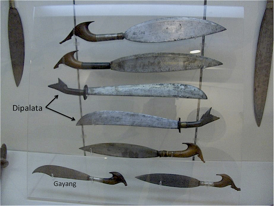

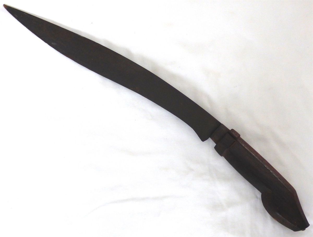

Two examples of the Pinatubo Negritos' dipalata photographed in a Spanish Museum. This picture comes from an old thread on the rare Moro gayang, one of which can be seen at the bottom of rack.

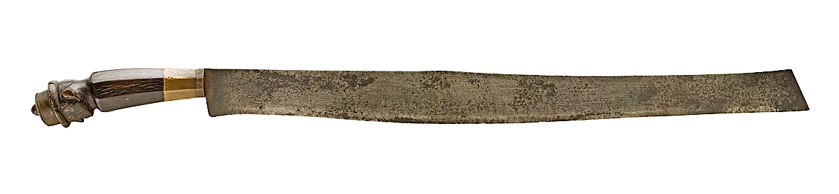

The shape of the blade on this knife is strongly reminiscent of the Pinatubo Negrito katana shown in Fox, Plate 9 above. This picture comes from the Philippine section (no. 212) in the History of Steel Exhibition at the Macao Museum of Art (see here). The museum described it as a Luzon tabak, probably from Batangas.
The knife has a brass ferrule and a horn handle the end of which is carved with a human head wearing a brass cap. This style of carving is typical of work from Ilocos sur, and therefore is likely to be Ilocano in origin. The links between edged weapons of the Negritos and Ilokano are issues for a separate discussion.

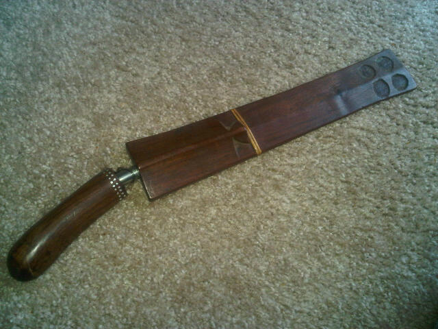

Default SIMILAR

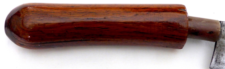

Came across this recently. It would appear to be the same.
O/A length is 14"
Blade is 8 1/4"
Not full tang.
collar is aluminium.
The letters on the blade look like ADG but they are very unclear.
Roy

Yes, definitely in the same group.
I am attaching a picture from the web of a chief of the Pinatubo Negrito who lived near the US Clark Air Force Base. He was reportedly the last surviving member of a group of Pinatubos who fought the Japanese during WWII--he was 19 at that time. The picture was taken in the 1970s by a US serviceman.
