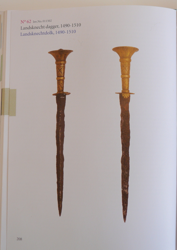

the dagger after conservation, the Philip the Handsome coin and the Rijksmuseum dagger, No62 in A&A of knight and Landsknechts.

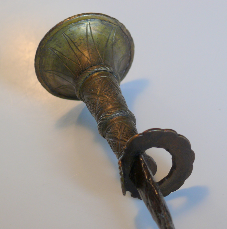

a brass tang washer with an interesting form.

The asymmetric shape of the washer clearly reflects the Late Gothic taste, as a forerunner of the upcoming Early Renaissance style.

The washer appears to be in the shape of a shield.

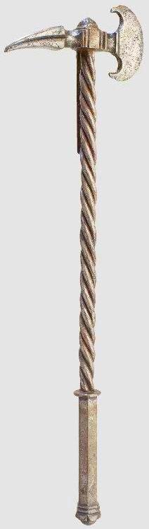

For comparison, attached please find images of a fine 1520's' horseman's axe, the haft twisted in the same early-Italian Renaissance fashion, and a contemporary North Italian arquebus barrel.
Thanks again, and best,

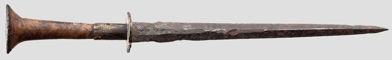

The dagger from Philadelphia is correctly dated around 1400, herewith also a gothic dagger Hermann Historica auction 64 lot 2209, around 1400 with an interesting symmetrical pommel cap of a similar shape as the washer of the Phily dagger.

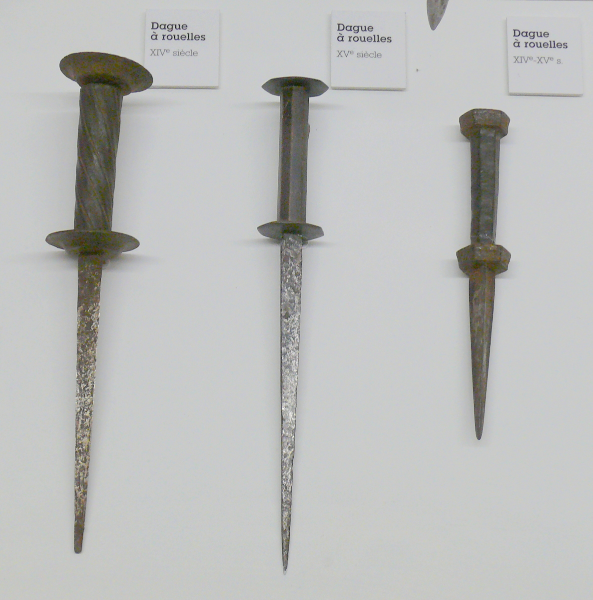

rondel daggers in castelnaud.
