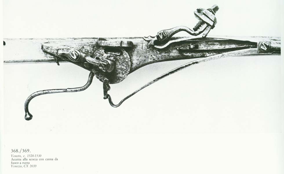

Default Typical Cinquedea Marks 'e' on ca. 1520-30 Tusco-Emilian Matchlock Barrels
The Gothic miniscule 'e' stands for Emilia, and almost certainly for Gardone, Val Trompia, Tusco-Emilia.
The small snap matchlock arquebus, made in Val Gardone, Tusco-Emilia, in ca. 1520-30, is in my collection (on top in the group of four) - see an earlier thread on this fine piece.
The wheel-lock arquebus of ca. 1540, employing a slightly earlier etched and gilt Tusco-Emilian matchlock barrel (ca. 1520-30), is preserved in the famous Vienna arsenal.
Michael
