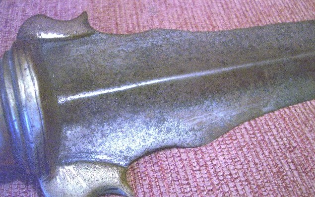

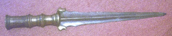

Hi,
please has anyone any infomation on this Pole arm head? The blade is 14" (36cms) long and approx. 2" (5cms) at its widest point. It is forged with sharp edges. The socket seems to be brass and is 6 1/2 " (16.5cms) long, the internal diameter is around 30 mm.
Quite likely cast around the base of the blade. I am informed by the seller that it is 17 C / 18 Century....certainly has age and evidence of 'many' sharpenings. The blade and socket appear much brighter than it actually is (flash).
Cannot ID origin, confirm age any help or comments would be appreciated, thankyou.

Hi Katana,
In Elgood’s book Hindu Arms and Ritual page 192 you can see pictures of lance/spear heads like the one you show – or almost like it. The socket is of brass and the blade of steel. So it could be south India or maybe Sri Lanka.
Old 22nd January 2007, 05:43 PM   #3
Posts: 10,872
Hi Katana,
Jens is 100% right, this appears to be a spear head from Sri Lanka.
In "Sinhala Weapons & Armour" by P.E.P. Deraniyagala (Journal of the Ceylon Branch of the Royal Asiatic Society", Part III, 1942, pp.117-118), similar is shown as a "...kuru Itale or kurukitale (elephant spear)" and apparantly the heads varied from 6" to as much as 48". These are described as having the median ridges raised into cutting edges which converge at the point of the spear. On the examples described there were apparantly straps downward to secure the head to the shaft (as seen on 19th century cavalry lances).
The brass, as Jens has noted also supports the southern India, Ceylon identification.
Your example is likely a ceremonial one from the 19th c. as the features are vestigial and the head lacks the securing straps that would be attached to the shaft. Apparantly the earlier forms actually had the median ridge expanded and sharpened and the downward projecting 'wings' at the base corresponded and were also sharpened.
Beautiful example! and stuff from Sri Lanka seems pretty hard to find these days.

Thanks Jens and Jim ,
interesting stuff..and very helpful (as usual).... ...Jim you mentioned the possibility that this could be ceremonial. I'm not so sure..... the blade is no longer 'symmetrical' because of repeated sharpening (more so on one side than the other) . Still reasonably sharp although there is no evidence of being 'honed' recently.
There is a hole in the socket where a 'rivet' or similar was possibly used to attach to the shaft.
The shaft, I presume would have been wood (teak ?) with a minimum diameter of approx. 30mm (1 1/5 ") but more likely was 41 mm (1 7/8") if 'level' with the 'bevelled' end of the socket. That would surely be a substantial 'heavyweight' shaft ?
The 'medial ridge' is 5/8" (15mm) 'thick' at the socket end which tapers (distally ?) to 3/16" (4.5 mm) just millimeters before the point.
Would these dimensions etc. still suggest ceremonial?
Has the 'inverted arrowhead motif' any significance ???
Ah ... one more thing....would 'elephant spear' mean a spear 'used' whilst on 'elephantback' or would it be used by a 'foot' soldier to 'take down' one of these magnificent animals.

Hi Katana,
If that has been sharpened then you're right, it was probably 'live'. It seemed ceremonial only in the sense that the features had devolved essentially to less dramatic form. Terms expressed as 'elephant sword' 'gun' etc. are always confusing. I cannot imagine trying to kill an elephant with one of these, although the ribbed four blade shape seems much like 'armor piercing' weapons. I'm not sure on the significance of the winglike shape, and perspective on those features we can only speculate. There would probably be some pretty good suggestions found in "Hindu Arms and Ritual", as Jens has mentioned.
Good observation on the shaft size also, and that might support use for anti-elephant warfare. Maybe this was sort of a proto-bazooka? In any case, I think your descriptions probably revise the ceremonial suggestion. I'd like to find out more on the use of these weapons associated with elephants, as well as the ancus, which is a most mysterious implement/weapon.

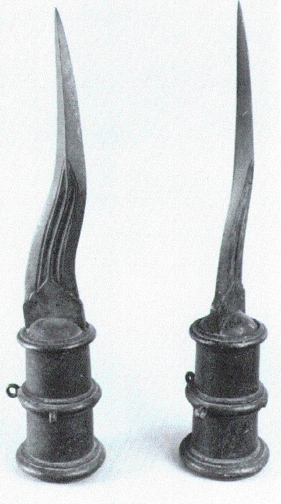

Pair of elephant tusk blades.
Unfortunately, I've long since lost the source for these two.
Sorry.

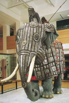

The tusk blades you show are the ones mentioned by Jim, and were part of Clives estate in Powis. They are now with the elephant armour at Leeds Armouries, although they are too big to stick on the end of the mounted elephant tusks (without skewering the occasional passing schoolchild)
Jim,
I have the Sothebys catalogue, and the pair from Mysore (also illustrated in the Mysore armoury catalogue) are quite disappointing. The Powis pair are huge, and very heavy, leaving no doubt they were made for use and not ceremonial.
On the spearhenad, I go along with Jens and Jims summary. It has the asthetics of South India, but could easily (even more liikely) be from Sri Lanka.

Joe, nice work showing those!! I was hoping someone out there had an illustration of these and I wanted to see what they looked like. These definitely look 'business like' and pretty intimidating. Thank you for posting these !
Hello B.I. its great to hear from you, and I had hoped you might have that Sothebys catalog and I rather suspected they might be as you note, disappointing as they are so late. I'm glad you are on board with the regional assessment as well on the spear, but am wondering , by the term 'elephant spear' would this be meant as to be used from the crews aboard the elephant to use from that height, or were these to kill elephants, possibly directed at underbelly? I personally wouldn't want to be even that close to an enraged elephant!

Hi Jim,
It's hard to say more on the spear, as there are no definitive and defining features. Maybe the decoration on the shaft?
The way the shaft envelopes the blade either side, is mimicking a South Indian Motif, of a 'Makara/Yali' head, symmetrically supporting the blade.
