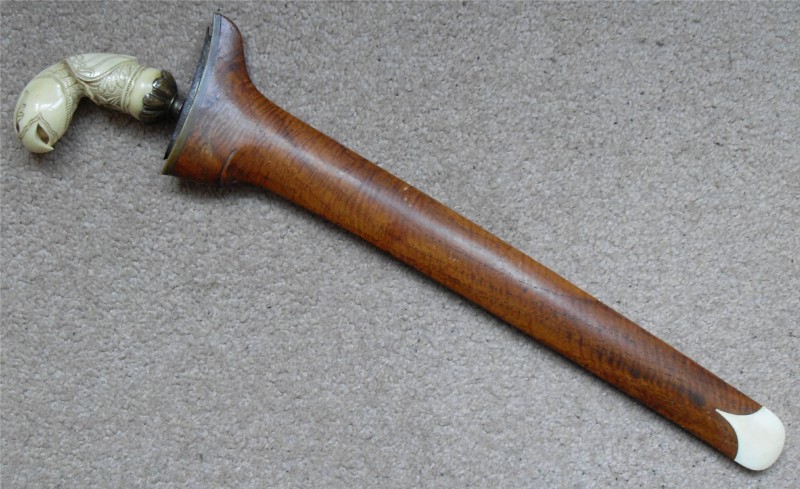

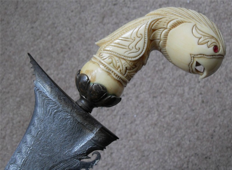

this one just ended on Ebay. It interested me, becouse I have never seen a Malay(?) sandang walikat sheet. Also the hilt form (Hulu Burung Serindit (?)) is not often seen.
The blade seems to be in very good condition (if it is old).

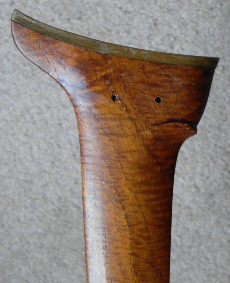

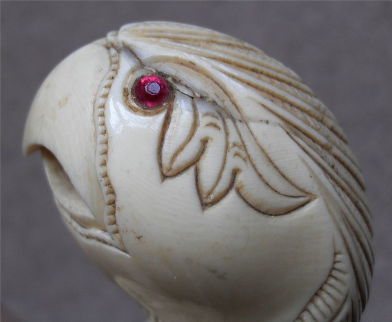

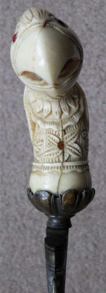

The hilt and sheath (Not so much patina?).

very good...i like a lot the hit, but also sarong and the blade seem nice (pamor tritik?)

I could be much more certain of my following comments were I to have this keris in my hand, however, here are my immediate impressions:-
1)--- blade is very recent Madura
2)--- hilt is recent Madura production
3)--- scabbard is an old one that has been reshaped to a sandang walikat form, and the piece of horn added to the top to allow perfect fitting of a blade that does not belong with this scabbard.
This appears to be a recent, high class and deliberate attempt to decieve.
Old 11th March 2010, 10:43 PM   #5
Posts: 6,441
Hi Alan, the clues that triggered your impressions ; would you care to elaborate for our edification ?
Old 12th March 2010, 05:24 AM   #6
Posts: 7,258

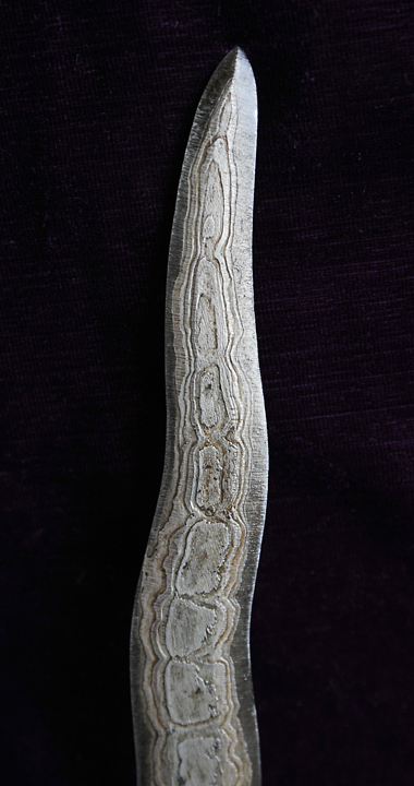

Blade:- if it looks like a duck, it is a duck, and I've seen thousands of this particular breed of duck. This is not an exaggeration.
Handle:- I've seen this hilt motif in new hilts from Madura, and it looks like Sumenep work, but I'm not nearly so certain of this as I am of the blade; it could probably come from anywhere where good quality carving is still done.
Scabbard:- I've seen the horn glued to the top of the wrongko to ensure good fit a few times, but never on anything old; the actual wood itself looks oldish, it may not have originally been a keris scabbard, but something else; the ivory buntut is perfect and obviously new, normally they're patinated and with a crack or two.
As always when looking at pics, I could be wrong --- but overall I don't think I am. I tend to automatically distrust anything I have not seen before, and I've never seen anything at all like this. With all the keris I have seen and handled, I should have, if it is a genuine type.

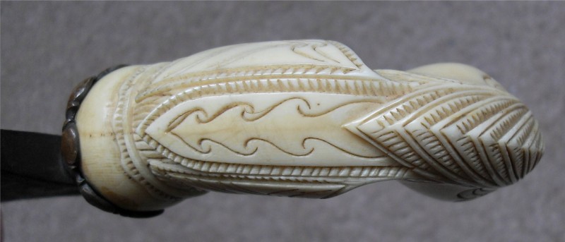

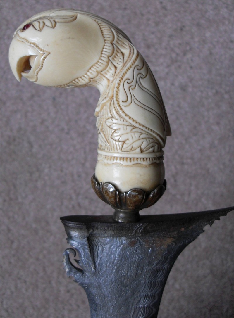

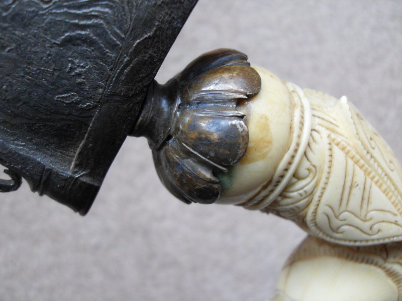

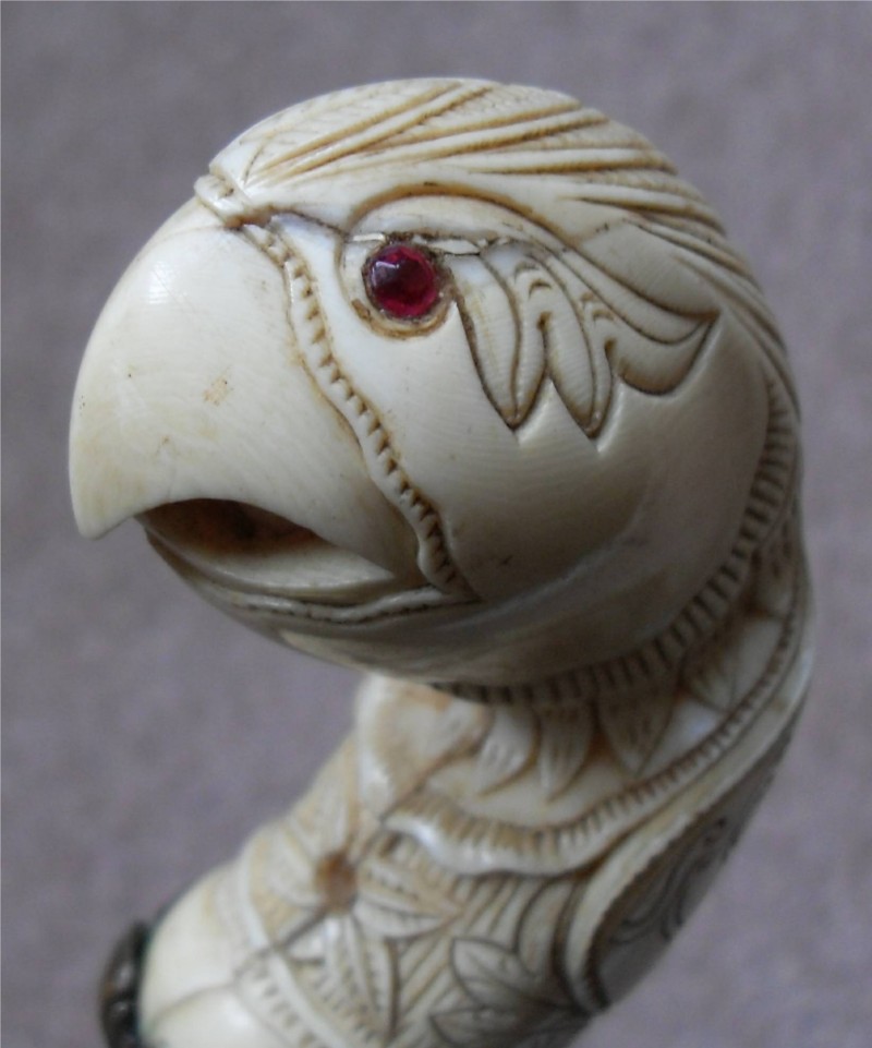

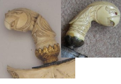

Three more pics of the Hulu.

I think that the rare hilt form and the rare sheat have been the reason that this keris reach such a high price. The hilt material seems to be from hippo ivory (see the attached picture, the black spots along a line are clearly to seen). This is also the reason why this hilt don't show to much patina since this material keep long time the white surface.
Another very nice parrot hit.
This is one i don't have in my collection...( in Indonesia is very difficult to find this Malay hit)

Hilt is the same. I just had difficulties to upload this picture, Sajen managed it.
An old thread about this form: http://www.vikingsword.com/vb/showth...ht=burung+hulu

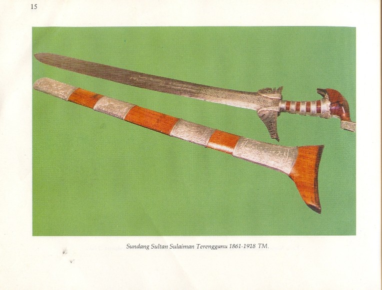

This one is depicted in David van duuren's "the Keris" and can be found on the website of the tropenmuseum under nr 3583.
+ picture comparing the two

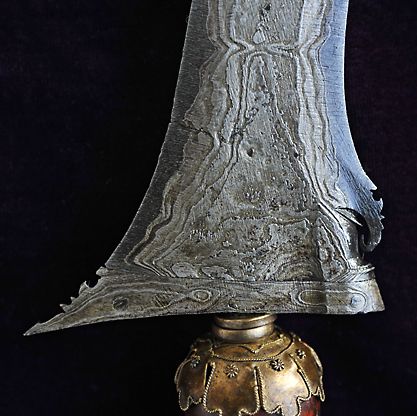

I really appreciate your input on this keris, because without it, I would not have taken the trouble to track down the original listing and the photos shown in it. The copied images that are published here are probably as good as copied images can be, but the originals in ebay are much more clear, and have given me an improved perspective.
In this keris there is one really outstanding feature, and that is the method in which the pamor has been worked, the topographic relief of the pamor, and the presentation of the blade.
This working method and treatment is so common in Madura blades as to be almost a copyrighted trade mark.
To produce pamor of this type, the maker needs very considerable experience in producing heavily surface manipulated pamor. He needs years of experience, and he needs to have produced many blades with exactly this same type of pamor as the one we see in this blade under discussion.
This blade has very well executed pamor. The man who made this blade had made many more of exactly the same pamor. This one was not his first, and it was not a one off.
This being the case, I believe it would be reasonable to expect that somewhere, at some time, over the last 50 odd years I would have seen a similar blade, or photograph of a blade, that was able to be attributed to a region other than Madura, but I have not. All blades of this type and quality that I have ever seen were indisputably produced in Madura, or by Madura craftsmen working in another area.
Admittedly, my on-the-ground experience is mostly in Jawa, Madura and Bali. I freely admit that my practical knowledge in keris from other areas is deficient. Because of this deficiency, I cannot argue against the possibility that this blade comes from the Peninsula, but from the available images I am absolutely immovable in my opinion that I am looking at a type of forge work, bench work, and surface preparation, with which I am extremely familiar, and that is Madura work.
If we wish to place it in the Peninsula, perhaps the first thing we should do is to try to place it within a period, and then to identify the makers working during that period who were capable of the production of this pamor. It is possible that this could be the production of a Madura maker working in another area. I stress "possible".
I do not have particularly detailed knowledge of Peninsula makers, but I have seen photographs of blades produced in the Peninsula during the last 50 years or so, and I have yet to see any work that even approaches the quality of this blade.

But whoever made this blade had been producing blades with similar pamor and of similar quality for a long time. So that takes us back to pre-1940.
I am under the impression that pre-1940 Peninsula blades were not given heavy treatment with sulphur and salt, but I believe that it is clear from the images that this blade is both recent --- note the clear file marks --- and heavily etched and stained to display topographic relief :- both traits that are the norm in Madura and Javanese blades, but I understand, extremely rare in Peninsula blades. In fact, respected people with much more knowledge than I have in the keris of the Peninsula have assured me that this practice is virtually unknown to the Peninsula keris.
So, if it was not produced in the Peninsula during the last 50 years, and it displays characteristics that are usually associated with keris produced in Madura and Jawa, but not usually associated with keris produced in the Peninsula in the period prior to 1940, then where do we think it might have been produced?
Either pre-1940 blades produced in the Peninsula were heavily etched to give topographic relief, and then stained with arsenic, a proposition that appears to be in conflict with the established wisdom, or this blade was produced in a place other than the Peninsula, and very likely at a date considerably later than 1940.

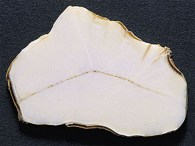

I believe the material in the hilt under discussion is also elephant ivory, as in the Ebay images, the underlying matrix typical of elephant ivory can be clearly seen; the black dotted line in this hilt is probably the nerve canal, I have elephant ivory hilts which display this same characteristic.

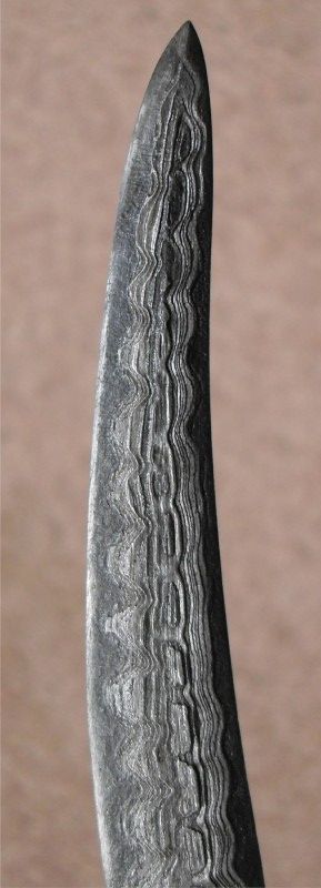

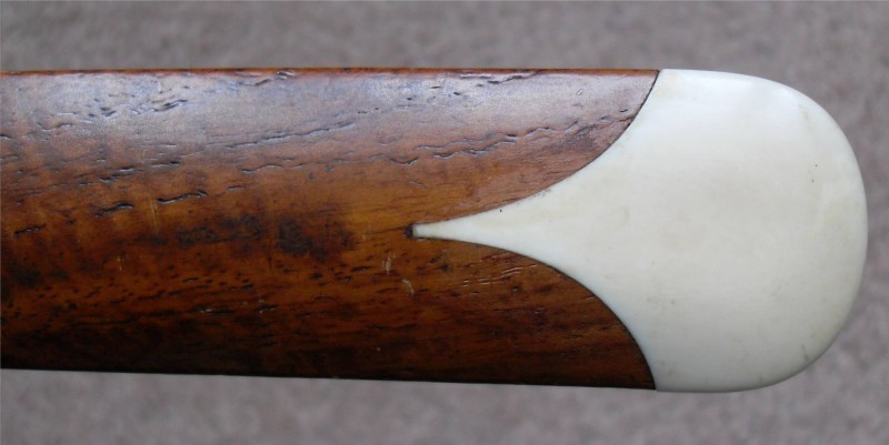

Here is a picture from a german site how to identify different sorts of ivory. The picture shows a cross-section through a hippo tooth.

The blade does look N. Malay Peninsula (in fact, Terengganu) to me. So does the pamor. There are a number of N. Malay Peninsula blades with such pamor. In fact, it is one of the few pamor types found on N. Malay Peninsula blades. Perhaps there was a transfer of technique/technology at some point in time from Madura/elsewhere to N. Malay Peninsula. If this blade were to be presented to keris collectors in the N. Malay Peninsula, I don't think it would be identified as an unusual keris.

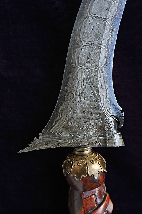

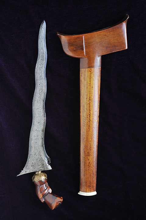

Well, you all probably know that i don't tend to post images of my blades on this forum all too often, but this question really is interesting to me and i feel the need to post this one to help us reach a better understanding on this subject. I have always assumed that this blade was from the peninsula. The man i got it from is an old collector who collected it many years back, i believe in the late 60s or early 70s. It indeed has topographical relief, though not as pronounced as this first example. I did not photograph it to excentuate the relief, but i think you can see it clearly in the photos.
So what do we all think the origin of this keris is? Peninsula or Madura?
Old 14th March 2010, 08:30 AM   #23
Posts: 7,258
Not at all like any Madura blade I've ever seen, David, also the cross section is Bugis.Pamor is not Madura in either construction or execution.
I do not know exactly where it is from, but in my experience, not Madura.

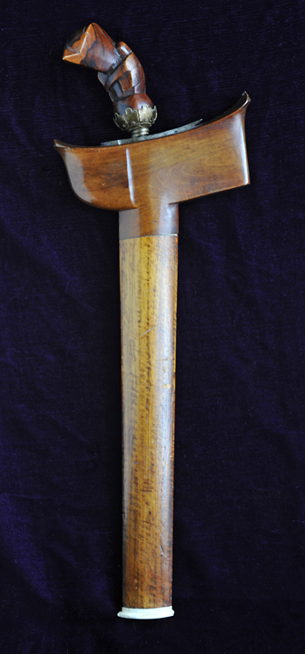

This has to be Terengganu. All parts of it. Almost a brother to one of my kerises, except that the blade is a sepokal.

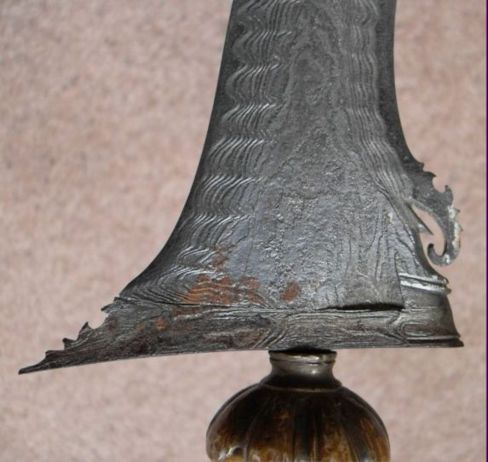

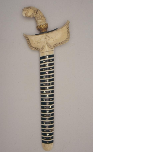

just for comparison.

Thank you Alan and Kai Wee for your responses. Terengganu is where i had thought this keris was from, but when Alan expressed that respected people on this subject had suggested to him that this kind of topographic relief pamor is virtually unknown from this area it raised a serious question with me about it's origin. Ultimately where it is from would not effect my liking for this keris, but it is an important piece of information that i would like to have correct about any keris i own if possible.

Has anybody seen this one alive? Is this a documentated sundang? If yes, what about the age of fittings? It seems to have a sheath mouth from other material.
The other one (excuse me please for using your picture, VVV) also.
