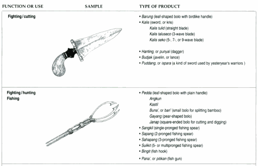

For the first installment below, the mystery blade is the puddang.
A friend told me that it refers to swords and blades generically, and I believe him.
On the other hand, could it also be possible that it refers to the pedang of Sulu's neighbors further down south?
Would anybody be kind enough to post pictures of a pedang here?
Thanks in advance!

PUDDANG: noun. A large, double-bladed sword (used by warriors of olden days). Kulang na in puddang bihaun ha Lupa Sug. Large double-bladed swords are scarce now in Jolo. verb. ag mag-; pat -un. To use such sword. Magpuddang in manga tau nakauna yadtu bang sila nagbunu. The people of olden times used large double-bladed swords when they fought. Cf. ispara, kalis, barung.
BARUNG: noun. A single-bladed weapon (having a heavy back and tapering in thickness to the point). (it has an elaborately carved handle, is worn at the waist and used only for fighting. The barung and the double-bladed sword (kalis) are the two favorite bladed weapons of the Tausugs.) v. ag mag-. To wear or use such weapon. Bang sila magbunu, magbarung sadja atawa magkalis. When they fight, they only use a single-bladed weapon or a kris. OV SYN. kalis
KALIS: noun. A kris (the famous two-edged sword of Sulu). Tiyakus niya in kalis niya. He sheathed his kris. OV SYN. barung, puddang
KAMPILAN: noun. A long, two-handed, bladed weapon (rarely seen or used in recent times).
possible related word? - KAMPIL: noun. a woven container (of coconut leaves used for keeping fruit or raw or cooked provisions).
UTAK: noun. A (working) bolo. Da kaw utak bang kaw pa uma. Take a bolo when you go to the field. Cf. Janap, lahut.
PUNYAL: noun. A dagger (smaller than a kitchen knife). In punyal asibi dayn sin laring. A dagger is smaller than a knife. Cf. utak, sangku
JANAP: noun. A (short working) bolo (having a blunt end which is sharpened to facilitate weeding or digging). Marayaw hipagsuwat in janap ini. This bolo is good for weeding. Cf. utak, lahut.
LAHUT: noun. a variety of Tausug knife with a sharp-pointed blade. Lahut in panghuyaan sin sapi'. Use the sharp-pointed knife to cut the beef. Cf. laring, utak, pisaw, janap
LARING: noun. A knife (as a kitchen knife or pen-knife). Wayruun laring hikapanghuya ta sin sayul ini. We have no knife to cut these vegetables with. Cf. lahut, utak, janap, buna', pisaw.
PISAW (gimb. pisawali): noun. A small knife (esp. used in preparing a betel nut chew). Butangan in pisaw ha mamaan. Put the knife inside the betel nut box. Cf. laring
BUNA: noun. A type of small working knife. Marayaw tuud hipaghinang in buna bang mahayt. It's very good to use the small working knife for working when it's sharp. OV SYN. laring, utak, janap, lahut, pisaw
ISPARA (Tagalog) noun. A sword (usu. refers to foreign swords). Cf. puddang
SANGKU: noun. A bayonet. Awn sangku sin manga sundalu yaun. Those soldiers have bayonets.
