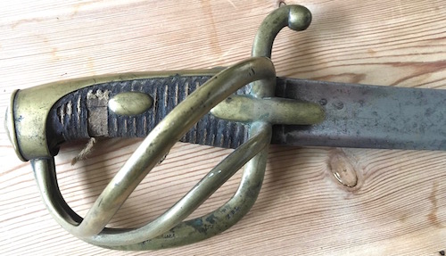

In this Robson reference, it seems these 'briquets' were in use by British artillery in the early 19th century, about the time of the presumed Storr production I have theorized, probably more at the turn of the century.
The type or character of the briquet in British use is illustrated in the painting by Denis Dighton (1813) COMPARING IT TO THE FRENCH BRIQUET OF 1801-03.
What I am wondering is if the 'Spanish pattern hanger' could be incorrectly termed as here my impression is that the briquet (of French form) is the sword described in these proceedings.
The Spanish pattern illustrated in the article linked has a hussar style cavalry hilt similar to the light dragoon sabers of 1780 (pattern) for British cavalry, noting again that the 'Spanish' association was simply for use in the Peninsula.
Or, were there two types? one of briquet form as my example, or the one in the article and multiple examples of its form suggested.

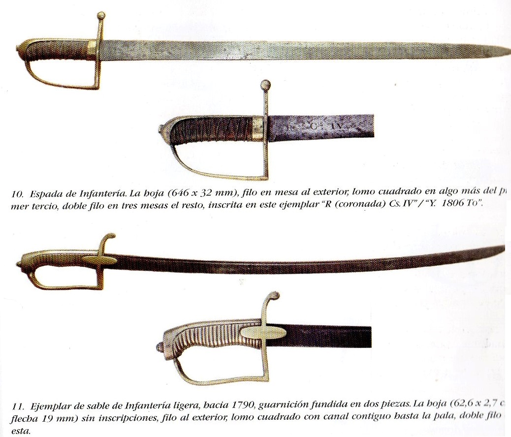

Thanks Jim,
I knew I had seen the illustrations you quoted, but I couldn't find them. Here they are and both show a straight bladed sword with a brass, straight stirrup guard and black grip, not a briquet.

Hi Bryce,
Thank you for these illustrations, which very much show the kind of 'Spanish pattern' you have described and in the article you linked.
Now my quandry is............why did Robson describe the 'briquet' as compared the the French ANIX and ANXI swords, which he was described as short and CURVED?
Further, why did highly reputable authors such as Blair and Wilkinson-Latham show illustrations (Blair's was in a panel of line illustrations); Wilkinson-Latham's was a photo...........while his caption notes there is a marking on the blade which he believes may be 'Trotter', who I think was a cutler of the late 18thc early 19th period.
While the 'Spanish pattern' evidence is profound, and there seems no doubt of course that the artillery men were using it, I am wondering if there is a case for some alternate situation in artillery ranks.

I guess after having this sword unresolved in identification with its curious initialed cartouche, and finally coming up with a good (and exciting) hypothesis, I am reluctant to let go yet
There have been numerous cases like this with my often unusual collection from decades ago (the briquet I got in 1966), one other was a M1796 British light cavalry saber. I know it was British (made by Thomas Bate).
It was well worn and darkly patinated, with a curious squared notch in the exact tip of the blade, not damage but a deliberate square.
Most baffling was the langet had the letters CsA 4 inscribed. Naturally I thought I had 'scored' a Confederate sword (they were known to use numbers of British swords).
However, every venue of research and contacts with authorities on Civil War arms insisted, these were NOT Confederate markings. Disappointed, I then came up with the convoluted idea that it might be Spanish colonial (Charles IV)....but no sound conclusion.
Then a revelation, it was suggested that perhaps the letters COULD be marks for the armory of Castel sant Angelo, in the Vatican! In the wars of unification in late 1860s, men came from throughout the Catholic realm including Great Britain to defend the Pope.
So while not conclusive, still compelling and I published it as such in the Swedish journal 'Varia' (2004). It had been nearly 30 years in research.
Such are my 'cold cases' and this one is clearly another. Obviously, the true story behind these and many old weapons can seldom be confidently resolved. But compelling resolution is at least of some use as long as options are all offered.

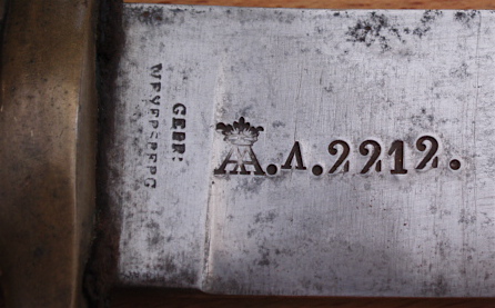

Looks like it will be hard to determine that Paul Storr, on his own senses, went on producing Briquets, unless factual evidence is found out there; not just by association of ideas.
Whether Thurkle made silver (and other metal) hilts, these seems (to me) that were 'one of a kind' examples, not a production in numbers. Then thinking of Storr, a silversmith Guru; to make a (one) sword you need an atelier (workshop); to cast a number of brass hilts for an army contract you need a factory... and a different attitude, i guess.
On the other hand, while joining two (or more) letters in a cartouche of a certain shape may give an idea of a determined silver smith mark, this is a recurrent procedure; their "trick" to distinguish one from the other, is basically the detail within the cartouche form. Even rectangles may be seen "by the dozen"; Storr himself registered a few different ones.

Fernando, thank you! That was exactly what I was looking for, examples of the 'touch mark' of the silversmiths. The rectangular cartouche enclosing the maker's initials just as I showed with the Thurkle example in my previous post was placed to illustrate the convention of doing this with silver smiths and in the time period late 18th into 19th and surely considerably beyond.
As you noted earlier, there is profoundly no way anyone could possibly be aware of all makers marks, touch marks, punzones etc. as there was not as much consistency as one would like to imagine. It has been said that as makers mark stamps wore out or broke, it was not necessarily the case that an exact copy would be the replacement.
In many articles on sword examples such anomalies as flaws in the punches or stamps were strong indicators of authenticity in examining individual swords, just as the case in authenticating mint marks on coins.
With the possibility of a silver smith such as Paul Storr handling a contract of brass hilts for government supply of munitions grade hangers seems heightened by the facts that he was a hilt maker, and he was indeed running a factory for his partner.
My idea has been, this is not a single sword made on a whim by a famed silver smith, but a contract of indeterminate number of munitions grade swords. The suggestions are that this type of hilt or in fact sword did not exist in British other ranks because of the confusing representation (as per Robson, 1996) of the so called Spanish pattern, the 'pioneer' pattern hangers shown in art of 1813,15 for artillery, seem to compellingly sate the case.

All the briquets shown so far have had D-guards.
Here's one they made earlier:
(1789)
Old 3rd October 2020, 09:32 PM   #44
Posts: 10,851
(1789)
Thanks Wayne, all of which briquets? Who they?
Is this British or French?
Interesting pommel capstan or fixture.

The Google source said French, I've read they used that style hilt up to the French Revolution. I used that photo as I couldn't find a photo of mine which apparently is a Spanish Grenadier version that looks just like it, but appears to have a slightly longer and straighter blade (and it's scabbard).
As these had to actually be carried, I also include a photo of the baldric attachment for the scabbards that have a staple rather than a mushroom post to secure them, just to round out the info of this thread.
I found the photo of mine! (below) the odd pommel bit seems to be an extension of the casting to cover an apparently longer tang without extending the grip area. half of it is a threaded cylindrical domed pommel 'keeper'with an end slotted section. It is a bit odd... I note the D-guard one in the baldric photo also has a flat white leather sword knot with a bit of red (tassle/slider?) showing. And the bayonet. Blue uniform? Is it US/UK? Looks a bit like it might be similar to the above artillery photo with the windmills. My scabbard is missing it's chape, has a brass staple on the other side of the throat piece. To complicate matters, the blade has an etched and bordered panel that says 'GRENADIER'. - the French for Grenadier is oddly, 'Grenadier'.

I just noticed your Briquet has had the quillion terminal removed. I have a French ANXI sabre with the same modification. Made in Klingenthal, poincons J.A. Kranz inspector 1812, F.L.Lobstein reviser 1804/21, J.G.Bick controller 1812/15. Might be something.
My Regards,
Norman.

The Briquet I have which has the Berne armoury marks was manufactured in Solingen by Gebruder Weyersberg and not sourced from France. I guess they were contracted by the Swiss from Solingen manufactories. I got in touch with the Bernisches Historisches Museum. Quirinus Reichen of the Military Dept supplied me with the details. It is the sword of an infantry orderly 1843 pattern used by Berne and several other Swiss Cantons. The pattern was in use by them for approx 20 years. I erroneously gave the date in a previous post as 1830.
My Regards,
Norman.
My Regards,
Norman.
