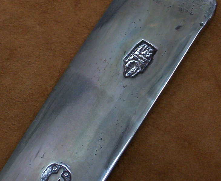

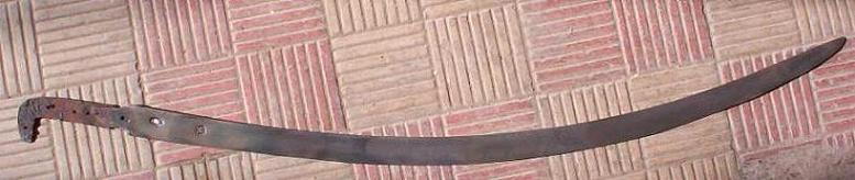

Default Help with the stamps please
I've seen the similar stamp (on the left side) in one of the books, but can not remember anymore. I think it's an armory mark. What is/are they?

Hi Alex,
Both marks seem to be very deep. Is the mark to the right a katar?

Jens, it is difficult to make that determination, but it looks like it is.

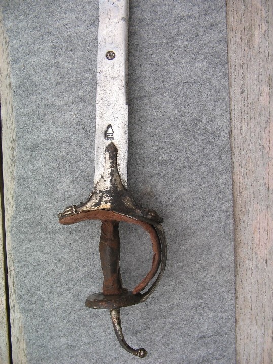

RSWORD
RSWORD's Avatar
Location: Greensboro, NC
Posts: 1,099
The one stamp definitely looks to be a katar and the other stamp I believe is a trident. Unfortunately, cannot say if these are armoury marks, religious in nature, or what.

... What does the whole sword look like? Do you have any close ups of the hilt?
Jens, I found this blade as a rusty piece of metal, without a hilt. It has been cleaned and polished and it appears to be of a low contrast pattern welded steel. I am inclined to say it is of an Indian origin, but it's just a distant quess.

Alex, I think you can drop the ’inclined to say’. This blade is Indian, and I am glad you got it, and restored it. The interesting part now will be the digging, to find out from where in India it origins – happy digging. Should I find anything, rest assured that I will let you know.
Can we see the blade, just to see the form and the tang?
Could you also give us a close up of the katar?

The mark on the left is a trident and this is seen on tulwar blades in the same location in the center, upper third of the blade usually. The later examples of this from 19th c. seem to have become more stylized and look more like a bird foot. I have seen early tulwar blades with this trident and in the upper forte near the hilt a cartouche usually stamped in Urdu script.

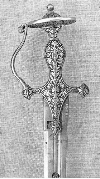

Jens, I think in Rawson there is a tulwar with the markings described but cannot recall what illustration it was. Also, in Egerton, it seems in the chapter concerning Gujerat, there is detail on a tribal group who have a great deal of traditional focus on the katar. It is said, if memory serves, that they swear oaths, legal matters etc. on the katar, and that any failure or 'breach of the contract' would compell the swearer, even unto suicide for such dishonor. I recall in research years ago that I had considered the possibility that such blades bearing the katar stamp may have had to do with this tribe. The reason I am suggesting this to you is in hopes you might find that reference in Egerton as I do not have access to it, and I would be interested in your opinion. Its horrible without the books !!
In most cases the tulwars these markings turn up on seem to be from Rajasthan regions, and I had also considered Sikh provenance but no convincing support for that has become known to me.

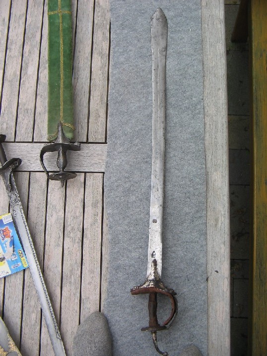

welcome to the Forum. Below I post more pictures of the blade. It is still in a sad shape, but it's much better than it was before:-)
I suspect this blade is a regular/standard tulwar blade, UNLESS the rare combination of two stamps makes it special:-)

Alex, thank you for the nice words, and thank you for the pictures, which adds to the size of the puzzle, as this blade had a shamshir hilt and not a tulwar hilt – just have a look at the form of the tang. Should I guess; then this is a shamshir made for a Hindu, due to the stamps, and this makes it a rare piece. To see one of the stamps is rare, but to see both stamps is even rarer. I asked a friend, who has seen more Indian blades than I will ever see. He did not know what the marks mean, but he said that he has seen the trisula about a dozen times, and the katar three to four times.

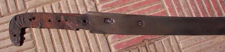

Jens, thanks again for your comments. I think the blade was originally of a tulwar. Later it has been re-maked into a shamshir. The metal shamshir hilt core it crudely welded to the blade, so I think it is not an original hilt core.
I have several spare Indian steel hilts, so I think I'll make it a tulwar again:-)
Old 26th June 2007, 03:25 PM   #24
Posts: 10,867
Interesting ! Especially to see a new tang crudely welded to the blade.

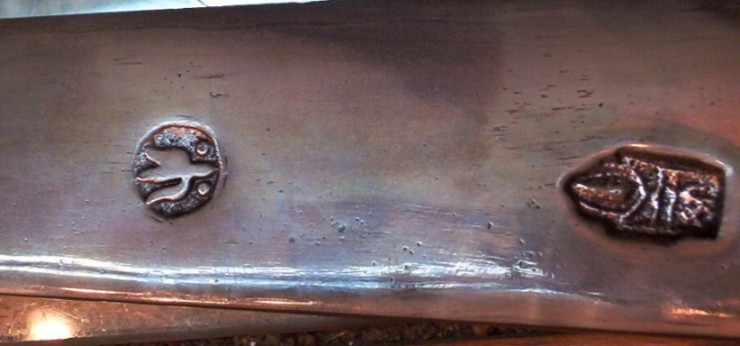

i got thes one sword from ashoka arts withthe two stamps.
i send you in the next post the pictures from the blade.
it is also an deep stamp from an katar ans an trident.. i think it is nearby the same like these from alex.

so what think you is it an khanda ore more an patissa sword? the blade is verry havy single edged with no ricasso. my opinion is that these sword is very unpracticable for fight in an battle. an khanda is light an quickly in an battle but thes sword is so havy an the people from these time wasn´t so big an strong like today. maybe it is an execution sword???
please tell me your opinion!!
