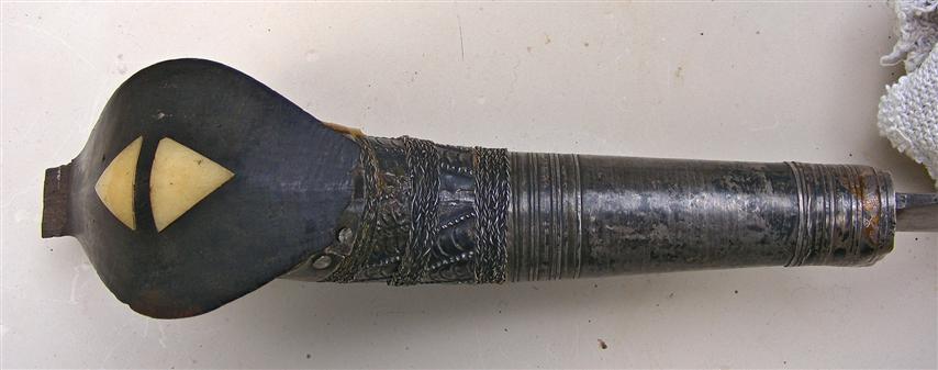

Just won this barong, I think that it is a junggayan datu barong with some badly damage. The silver/glue damage is in my opinion doable, the most mayor task will be the restauration of the beak of the pommel. Am I correct that the pommel is most probably from kamagong wood? And I am also correct that it is a datu barong? Not good to seen on the pictures from the seller but there are also ivory (?) inlays at the top from the pommel.
All comments and tips for the restauration are very welcome.

Yes this is datu class, and yes this is made of kamagong wood. However, it maybe ivory or maybe bone (parts look of bone, but not sure). Top tail seems broken off as well. And of course some of the chased silver is missing.
Lots of work but good luck!

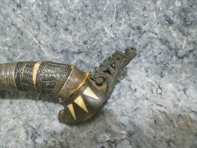

Thank you Jose. Good possible that there is also missing a small part of the top tail, not good to see on the seller pictures and I hope that not and the pommel is just not so elongated like your one (hope that you don't mind to post your picture again). I am not to sure that there is something from the chased silver is missing, it seems that the third silver band is just turned around, think you mean this place!?

The top band is half there and a later plain replacement is there.
The top tail piece, I would have to have a closer look.

yes, you are correct, the top band is a later replacement and badly glued in place.
Will post pictures soon as it has arrived at it's destination. It will be certainly a difficult restore project but worth a try IMHO.

But it looks restorable, use a fine medical scalpel to remove the glue .
Only restore if you are absolute sure that the piece will be better. Otherwise an original broken thing is worth more that a bad restored example.
The most difficult part is to remake the birds beak again in harmony with the lines/shape of the rest. My advice would be to make it roughly and that glue it and remodel it when its fastened to get the best result.

Have received some meaningful pictures from Robert, he have brought the silverbands in the correct position and now you can see that nothing is missing, only the upper silver band is a replacement. And Jose was correct, the top tail piece from the wood is missing. I think that the inlays are from bone and not from ivory. An other member of the forum will send me pieces of kamagong wood for the restauration, thank's again for this.
