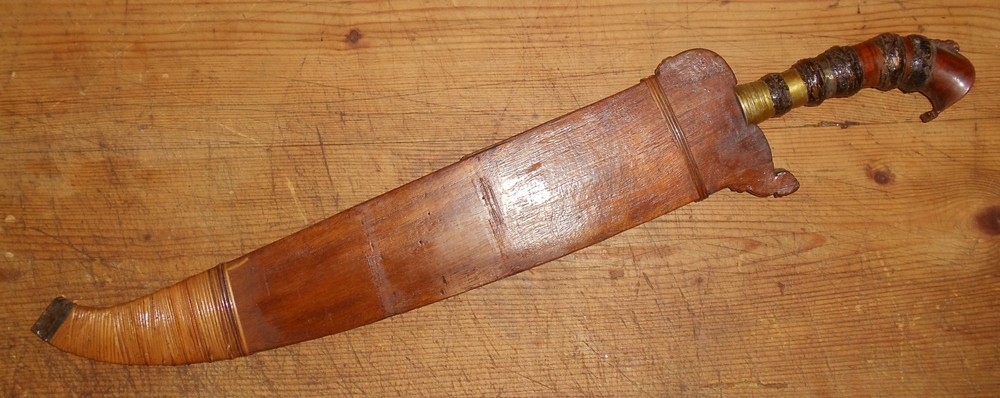

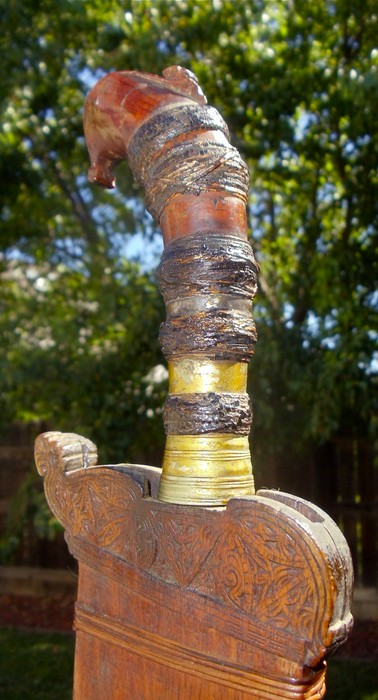

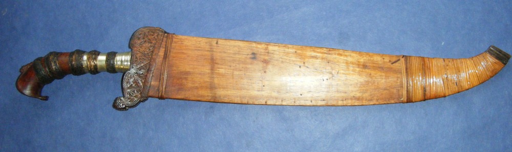

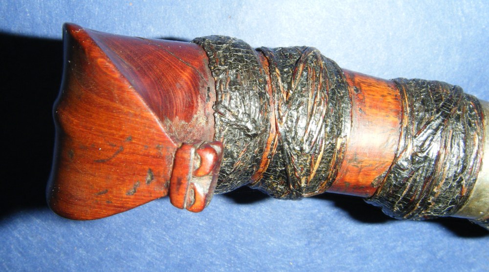

Have won this barong from epray recently: http://www.ebay.com/itm/120961143777...84.m1439.l2648
Any information is very welcome, age, area and so on. And have someone good informations how I can remove the shellac coating from the barong without destroy patina? Haven't received it yet.
Thank you in advance,

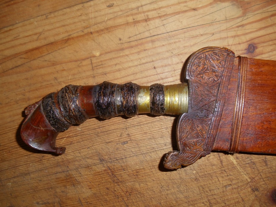

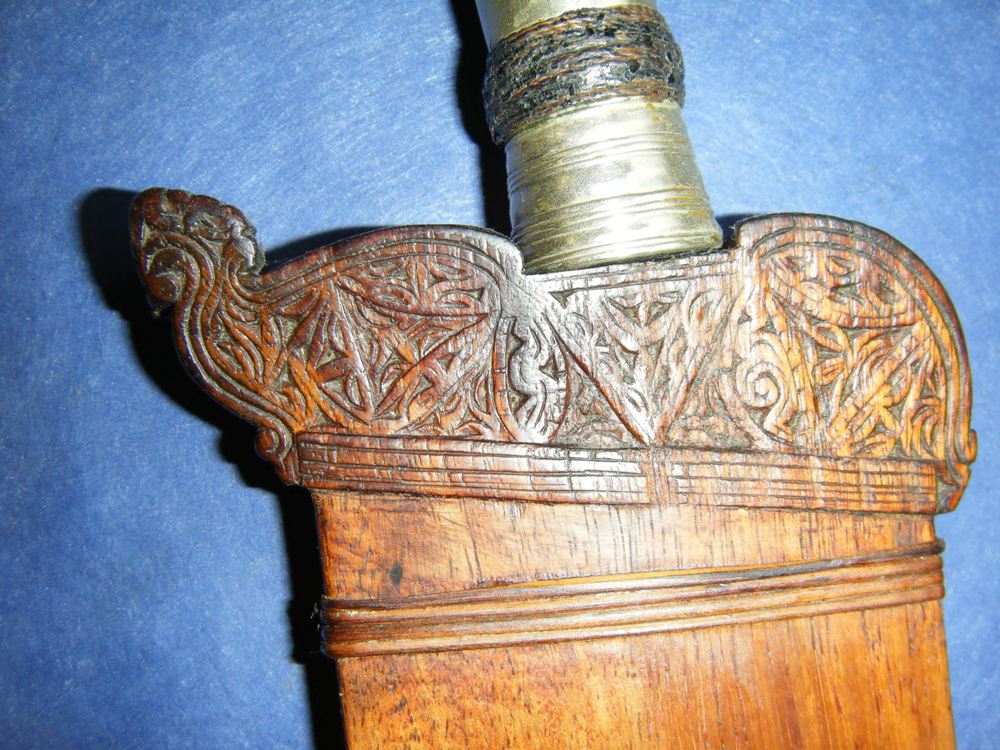

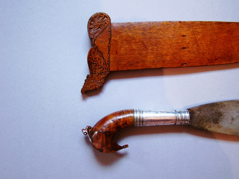

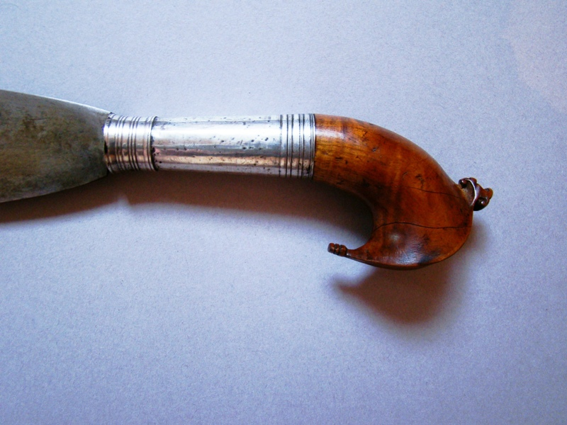

Very nice older barong. My guess it is from Samal. The carvings on the pommel are similar to mine and mine is Samal.

nice warrior's barung, detlef! are the wraps leather, or twine?
Hello Lew,
thank you for the hint of origin. Indeed similar carvings!
Thank's, don't know but think it's twine. Haven't received it yet.

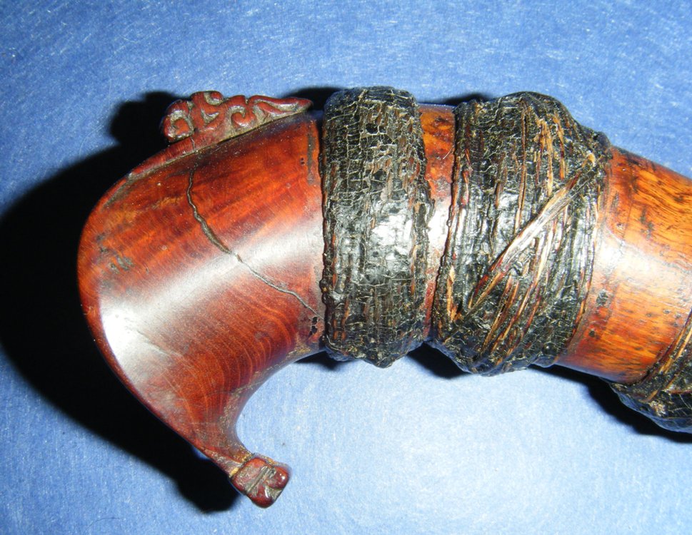

Hi Sajen, yep nice one. Saw it but isnt my stuff. I bet the handle is 'twine' covered with black paste (resin; authentic).
To remove the shellack I would use paintremover; a tin of fluid acid that only reacts on the chemical lack but not with the organic material! Doesnt cost much and is bit acid to the skin (!). Apply richly to the handle >no worries< and wait (sometimes it take a while before working) and perhaps best is to whipe it off carefully with tissue in combi with an extra soft toothbrush for the holes etc. Or wash it quickly off with hot water (n toothbrush) and dry immediately after with tissue. Water will probably take more patine off than the 'dry tissue-whipe' method.

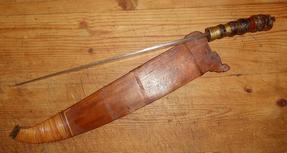

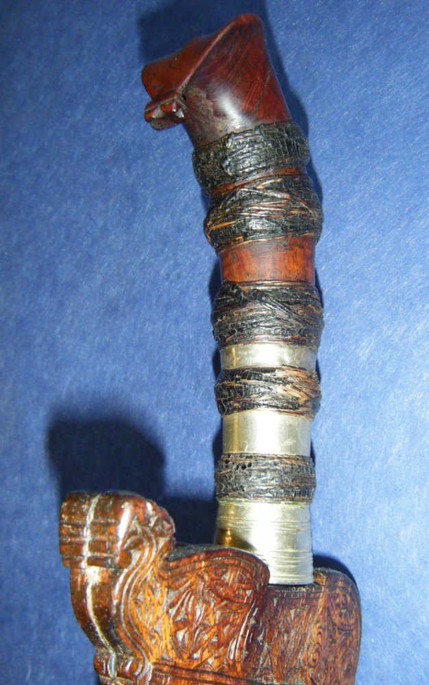

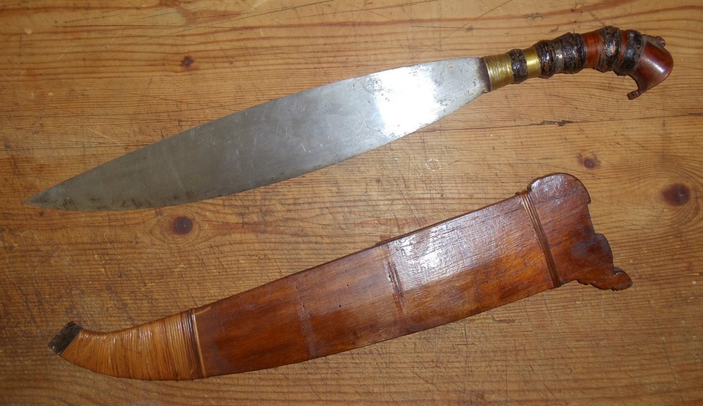

Old 11th March 2018, 07:08 PM   #18

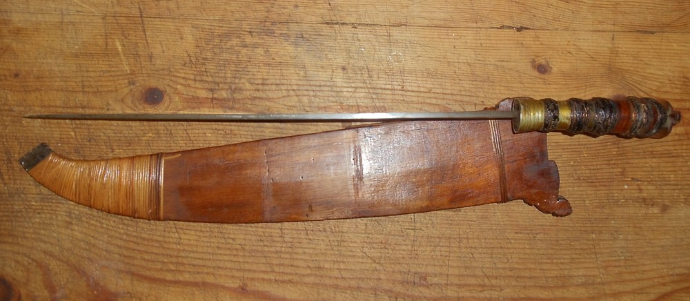

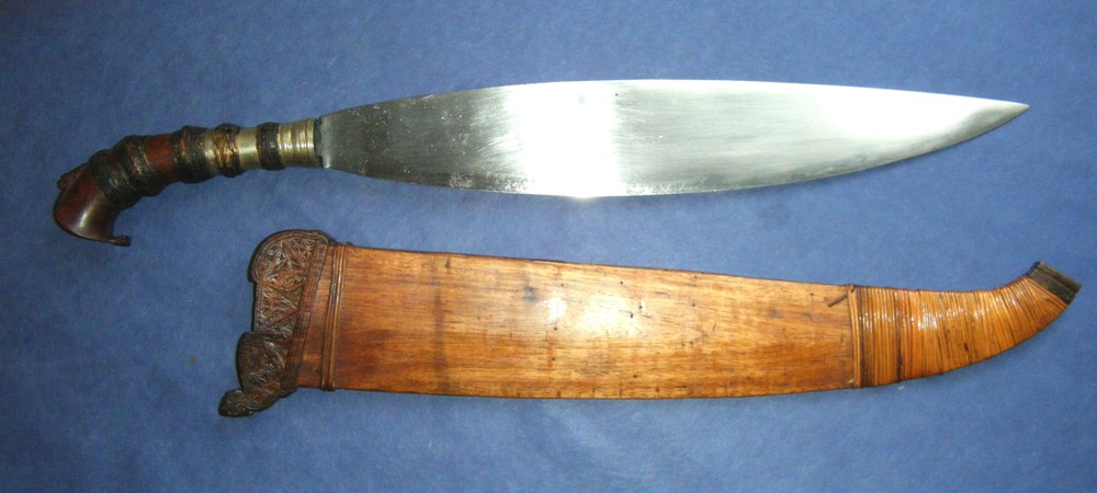

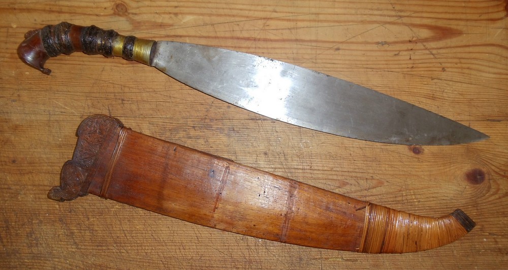

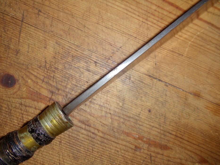

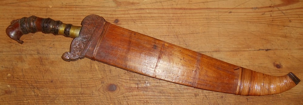

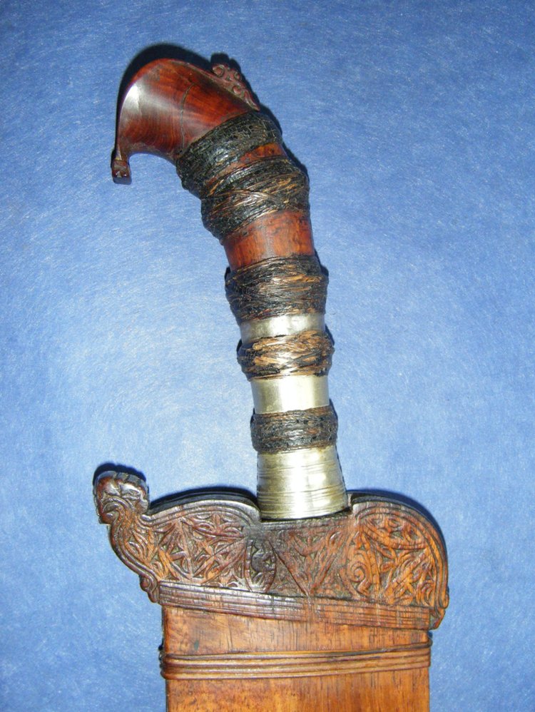

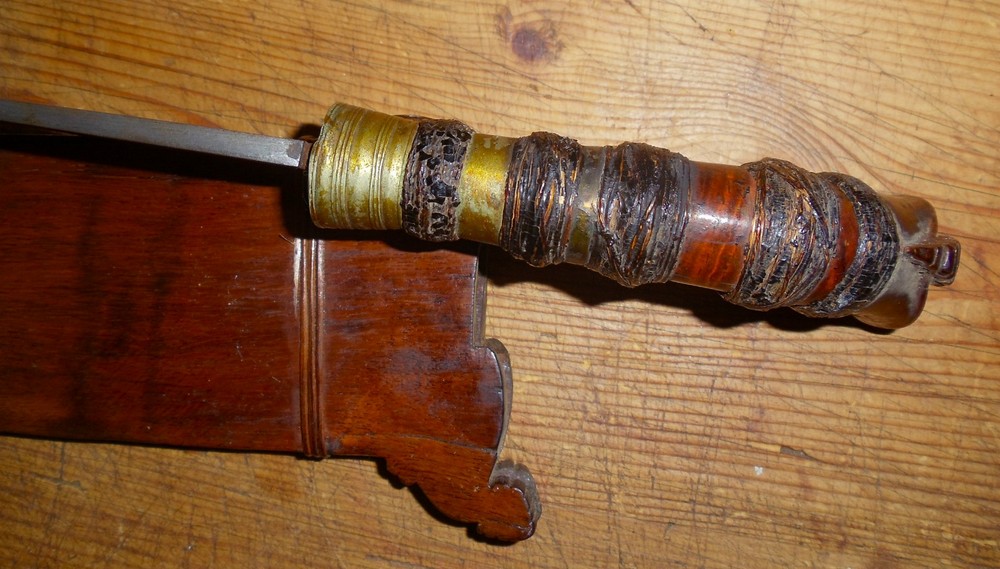

I've now can post first pictures of my restore work!
I was able to remove most of the coating with acetone, no other solution want to work. I've fixed carefully the opened scabbard and started to polish the blade, one side is nearly finished with 180 grit and show already a hardened edge. The handle ferrule is worked from white brass. Here some pictures.

Hello Detlef,
Nice barung - I'm looking forward to the etch!
Just to confirm: I guess you did not tried Wouter's suggestion for paint remover?

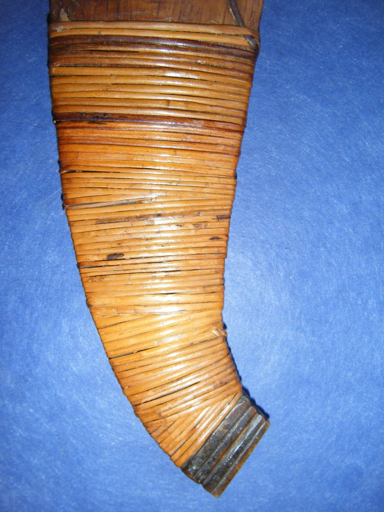

BTW, the scabbard tip is made from horn?
Old 12th March 2018, 07:55 PM   #24
Hello Kai,
thank you! No, I don't try paint remover! And yes, scabbard tip is from horn.
