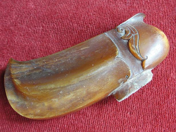

Unfortunately I was not able to purchase this one.
But after a few weeks I sort of grew over the dissapointment and now want to share the pictures to enjoy ,for reference and discussion
It was offered as a restoration project.
Funny enough a lot of buyers suggested to the seller that the pendok could not be the original as it should have been more decorated/embellished
Note the wrangka's decoration on floral motif on both sides.

Posts: 7,417
Wow - that's a horn wranga. Is this a type of rhino horn?

ukiran and top-sarong seem very very nice

thank's for sharing. very nice sampir. I think from "white buffalo" horn. Can we see the blade as well?

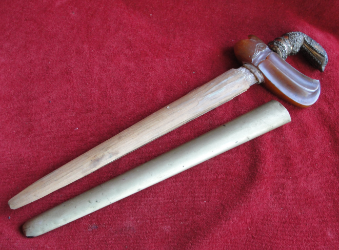

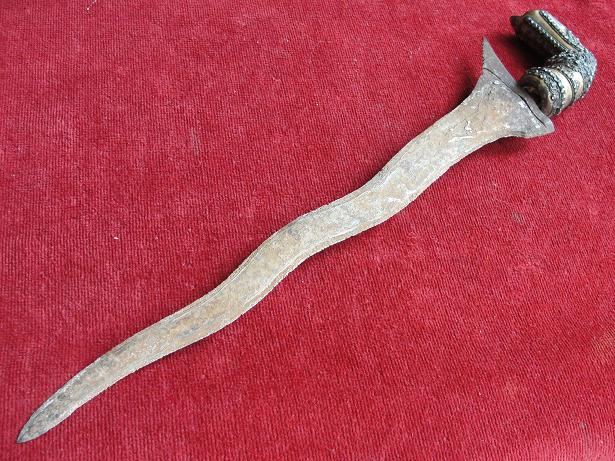

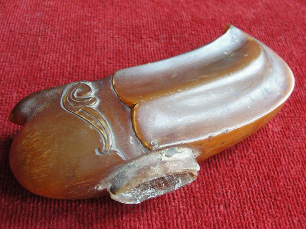

I think the wrangka is Buffalohorn.
Not as special as rhino, but still quite a large peice of buffalohorn.
It must have accounted for certain status.

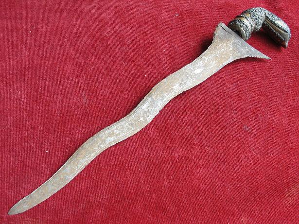

Here some more pictures.
The blade is not cleaned and not photographed in a good way.
But it gives an impression.

Hello Willem,
The sheath crosspiece made from carved horn is very nice indeed but besides the hilt, what makes it a Banjarmasin kris?
Best regards
Jean

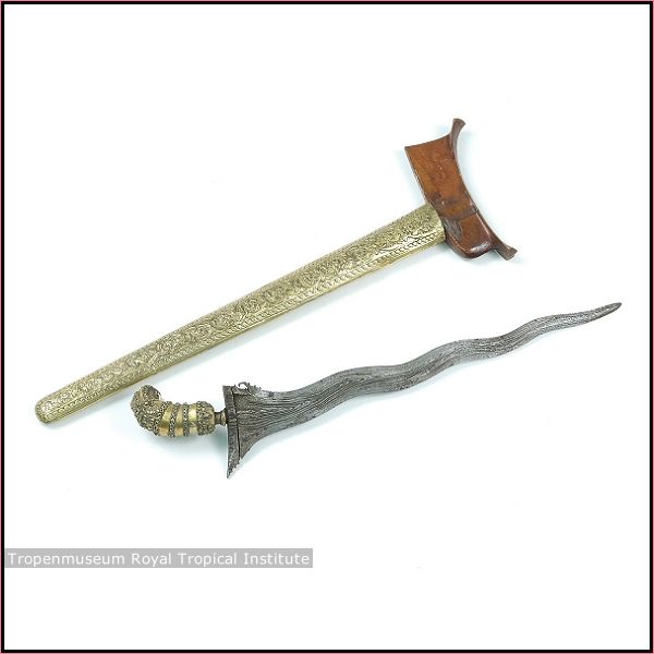

Willem, I mean in other regions.
Somewhere I have read that the Banjar hilts were quite popular and that's why they were imported to other regions (I can't remember in which keris book I have read this at the moment. But I will get back to you when I find it unless some of the other collectors find it before me) .
Now and then you see the Banjar nunggak semi version for instance on Javanese keris. Both more recent combinations, like at "HH" , but I have also seen them on keris in old collections and museums.
In Tropen there is a keris collected in Lampung with a similar Banjar hilt as yours (below). But the rest of the keris doesn't look like neither a traditional Banjar nor Lampung combination so it's hard to know it's story...
Michael
Last edited by VVV; 27th June 2011 at 02:23 PM. Reason: added comment and Tropen example

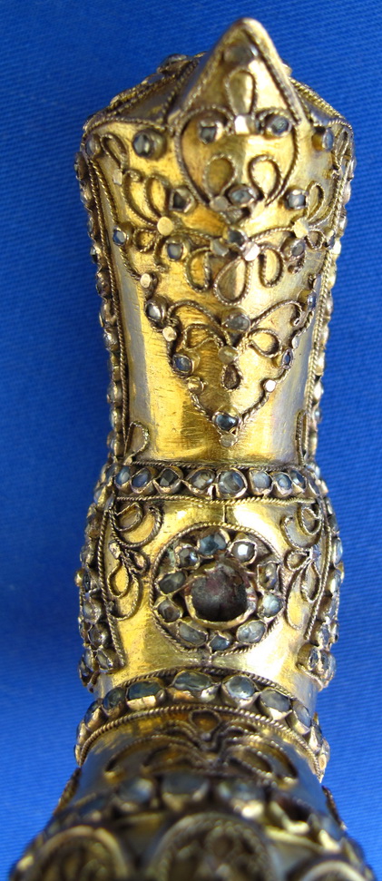

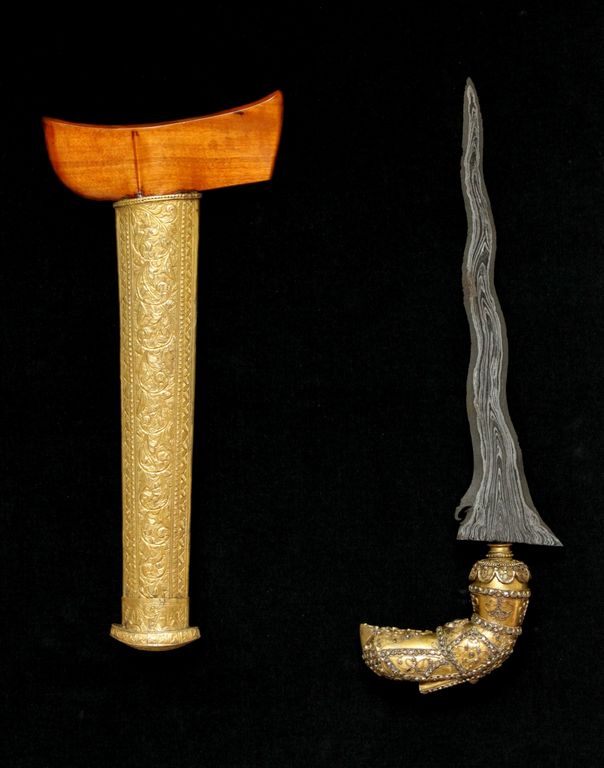

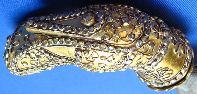

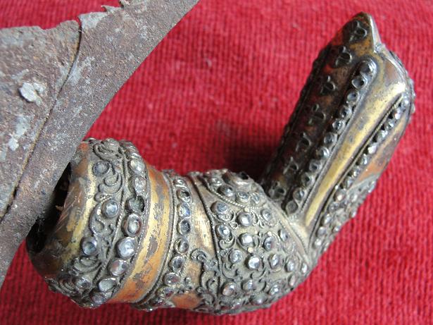

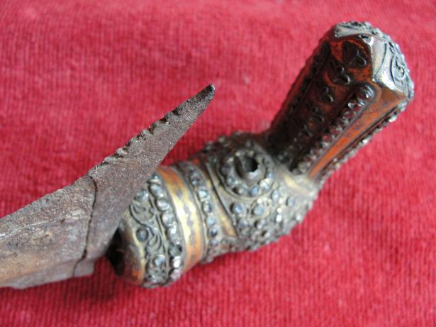

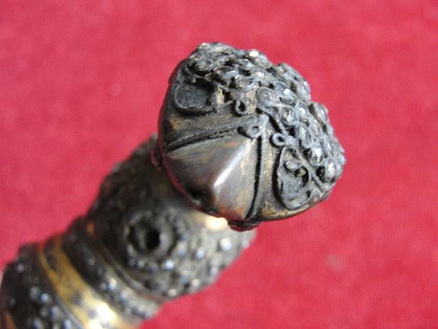

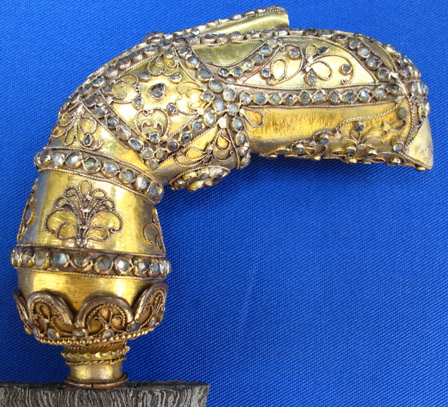

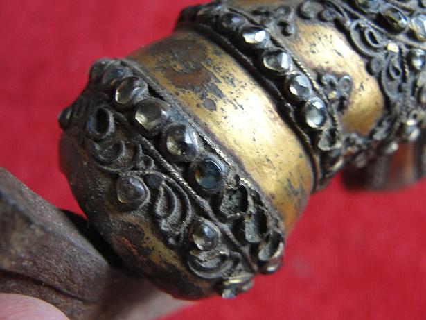

Dear Willem,

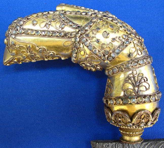

Attached are additional pictures of my hilt. I believe that it is original but in exceptional condition so may be not very old, the missing stones visible on the pictures were replaced.
Best regards
Jean
Best regards
Jean
Interesting hilt.
The technique / workmanship looks very authenthic to me.
Could it be that it was re-gilded ? Do you have any provenance ?
Willem
Old 27th June 2011, 08:34 PM   #15
Jean
Join Date: Jun 2009
Posts: 1,740
Hello Willem,
The filigree decoration looks more elaborate than on some other (older?) pieces. The selut seems matching, I saw the pictures of a similar one belonging to a famous German collector recently. I don't know if the piece was recently gilded or not but would not think so because of the stones. Regarding the origin of the kris, it was found and refurbished by my partner in Solo.
Best regards
Jean
Old 27th June 2011, 09:44 PM   #16
Posts: 7,417
Are these thin gold or gilt silver/brass? They look like gilt brass to me...
Old 27th June 2011, 11:30 PM   #17
asomotif
asomotif's Avatar
Join Date: Nov 2006
Posts: 2,238
Yep, normally they are gilt brass. Is that a bad thing
Old 28th June 2011, 02:38 AM   #18
Posts: 7,417
Nope just curious - gold would be royal and more expensive.
