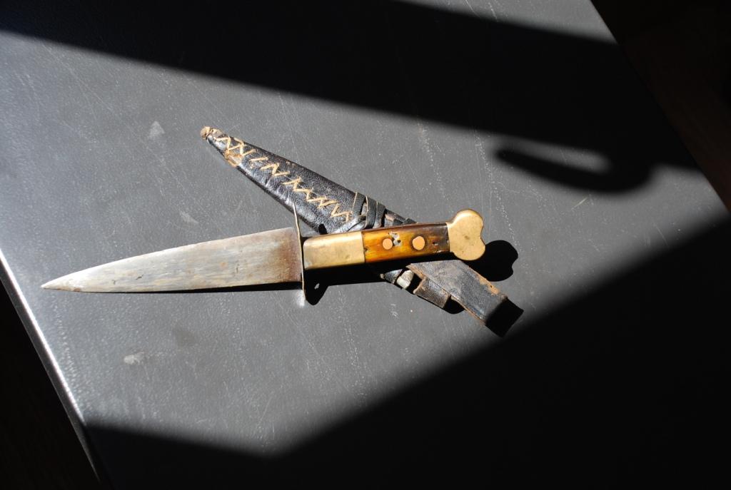

Actually, I have to admit: the main reason I am starting this thread is to try to see if there is some information on these unknown (to me at least) weapons. I have been able to gather pictures of a few specimens, unfortunatelly none of which are in my collection. The first spcimen is a short sword, or an oversized kama, for which I have some provenance. It belongs to a very good friend of mine, who collects historical edged weapons and firearms, and according to him it is his family's relic, as the earliest of his predecessors he can trace back to acquired it from a Turk he killed with an axe. This is believed to have happened in the 17th or early 18th century. While this of course can never be conclusively proven (I have no reason to doubt his story, as long as it was passed to him correctly), here is a picture of the weapon among some other blades and scabbards that I hope do not distract too much:
The scales on the handle are made of horn, and to some extent resemble those on kindjals from the Caucasus, however the blade has a central rib rather than a fuller and overall this does not look like anything from the Caucasus I have personally seen.

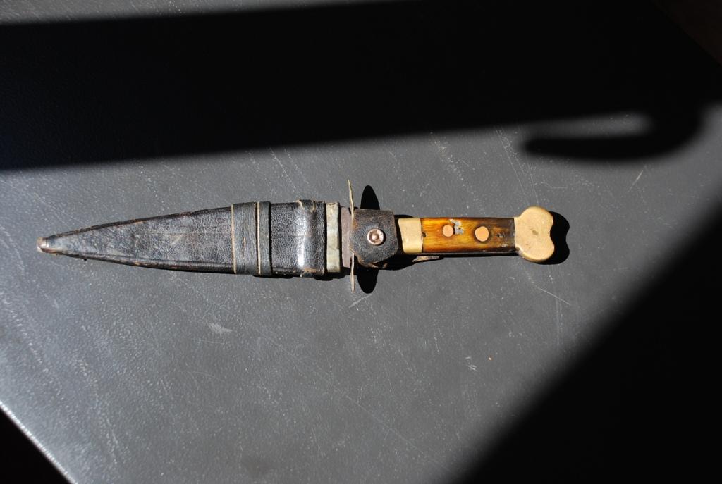

The second item is a kama-like weapon, in the collection of another fellow collector in Bulgaria. He has no idea of what it could be, and he only vaguely believes there is a similar weapon in a museum in the town of Samokov, which is a very small town hidden in the Rila mountains that was a metallurgy center during the 16th, 17th, and 18th century, and lost its significance in the 19th century. Unfortunately, as of right now I do not have a picture, and the last time I was in Samokov happened to be more than 10 years ago, a little before my interest in edged weapons formed, so I do not remember anything. Here it is:
Again, double edged, horn scales hilt, and this time there are two decorative fullers (I do not know if I should even call them fullers) close to the edges, and a most extraordinary guard. It is hard to estimate age with any certainty.

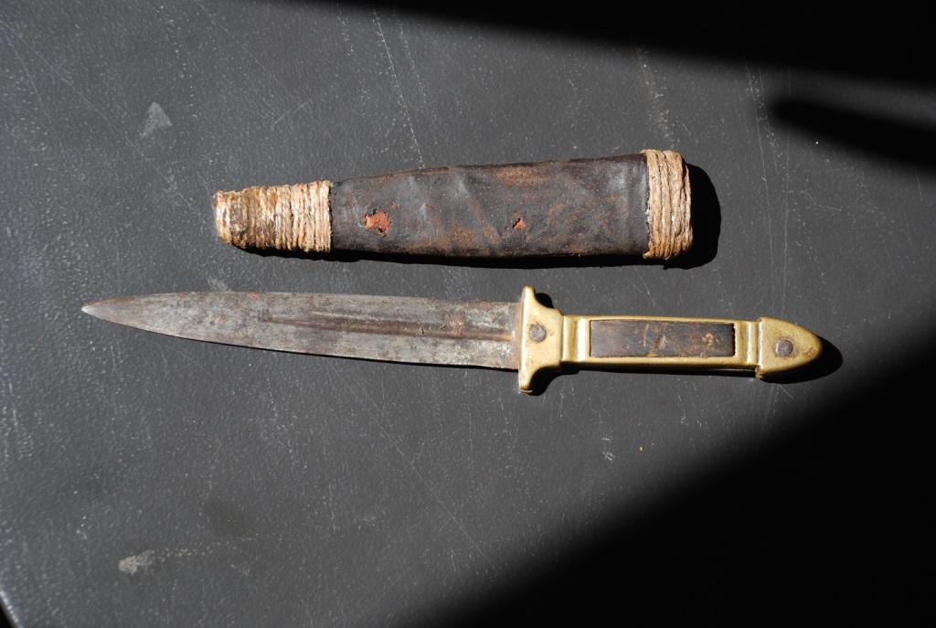

The dagger shown in the last photo Which you describe as a typical Bulgarian Kama is interesting. We came across a similar dagger which we could not identify and placed it more to the middle east, east Turkey or Syria, mainly because of the brass frame and the decoration style on the grip. See below:
The Bulgarian attribution is a refreshing information. Do you have more details as to its origin: Written material? Museums? Etc.

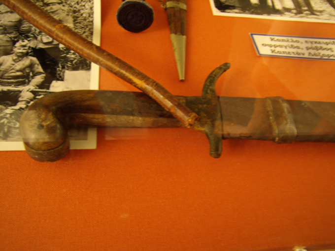

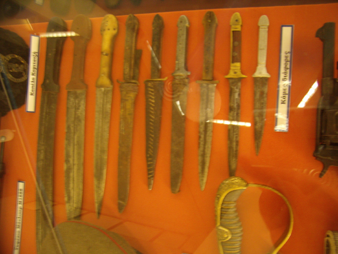

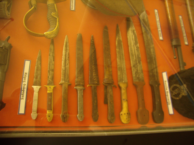

Yes, actually the last photo from my previous post was taken in the Bulgarian National Museum of Military History by my father (the person you can see in the reflection on the glass cover). Here is the whole photo of this dagger together with a few other kindjals, the little sign next to it you can barely see reads "Kama, Balkan Type" in Bulgarian:

I do not have any written material, since, well, there has been very little material on Bulgarian edged weapons from that period, just one book called "Weaponry of the Past" by Nikola Daskalov and Viara Kovacheva, Sofia Press 1989, in English, but unfortunately it is mostly on firarms and has just a few examples of edged weapons, among which none exactly like this particular one.
But yes, this particular brass frame is Bulgarian, I am absolutely sure about it. The circles decoration is not untypical of the Balkans at all, I have seen it on Bulgarian, Greek and Bosnian pieces.

My ignorant opinion would be - one of the kamas (last photo) shown are actually much closer to turkish kindjals than to circassian ones (many red dots - coralls? on the hilt). The top kindjal is also more southern then circassian, and may be even more of a georgian/armenian type. In light of this I would think that probably kindjals came to Bolgaria with turks and turkish trade rather than with circassians alone. That explains the range of sizes and styles we see - some are more like turkish, some are like georgian, some can be circassian.

Rivkin, you are right: kindjals came to Bulgaria before the Circassians with trade, and also let us not forget that some came not via the Ottomans, but via the Russians in the Russo-Turkish wars. However, the number of kindjals in Bulgaria certainly increased after Circassians were relocated to the Balkans.
I absolutely agree with your observations on the kindjals in the last photo I posted: there is a big variety among them and my guess is that this was the purpose of the display: the curators wanted to show together as many different knidjal types as possible. To be honest with you, the top one that looks Armenian as you point out (or Persian?), the one with the central fuller and the koftgiri on blade, is not one you would find easily in Bulgaria. The vast majority of what I have seen owned by collectors, offered for sale or in museums are kindjals with an off-centered fuller and very little in terms of decoration, and the already mentioned smaller kamas with a hilt encased in brass that are typical Bulgarian.

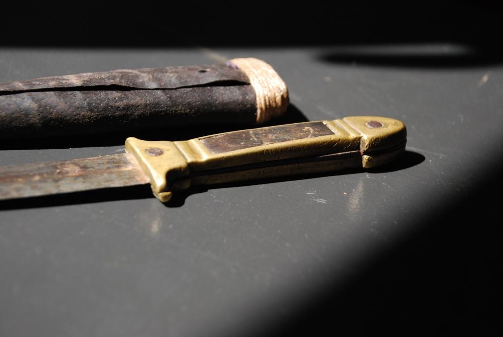

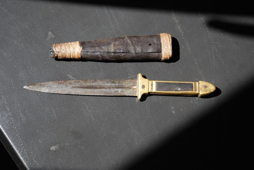

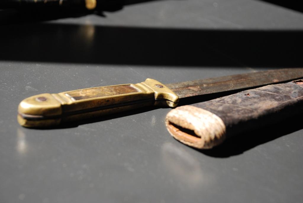

I highly doubt it is Russian. Here is another example, which belongs to a different friend of mine, and which he inherited from his grandfather:
I do not know if this type of kamas are Balkan or Bulgarian, but they are relatively late, I would say from the end of the 19th century and quite abundant in Bulgaria. How a few of them could end up near Izmir I do not know: trade, wars, and that can be not only the Russo-Turkish wars, but also the Balkan War, and in WWI there were Turkish troops passing trhough Bulgaria as allies too. Let us not forget that unfortunately there have been many Turkish immigrants to Turkey from Bulgaria throughout the years, from 1878 to the 1980s. Izmir has always been a big city and an important port in the area and certainly the area around it would have attracted people seeking jobs and dwellings.
