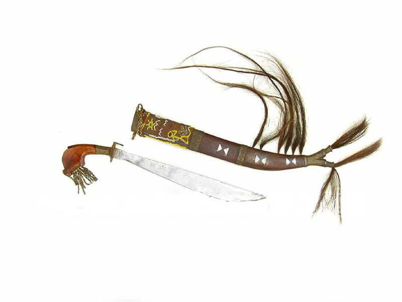

Old 12th February 2005, 08:33 PM   #7
Posts: 4,738
Default An old Bagobo sword

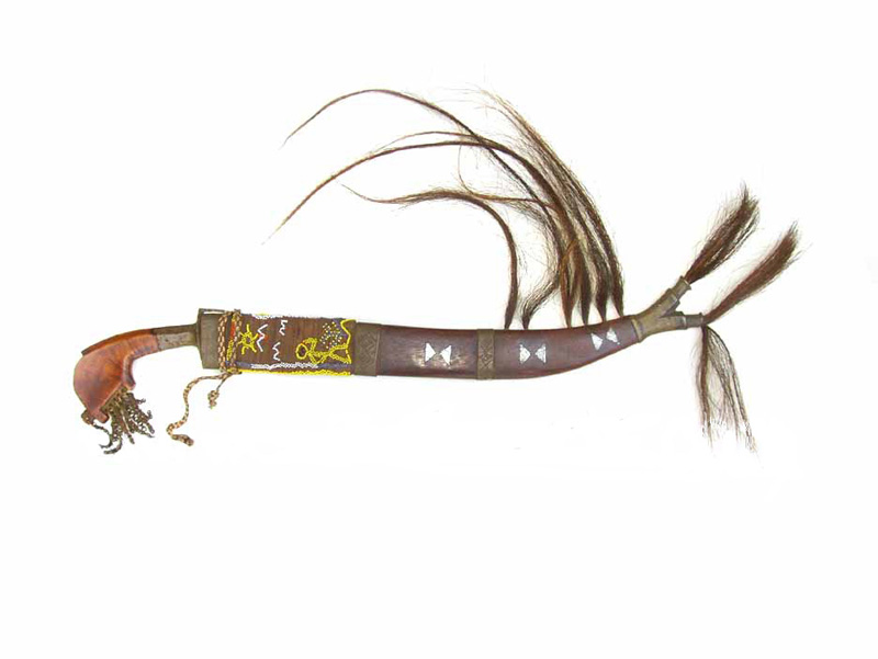

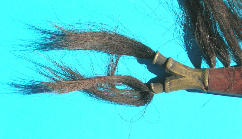

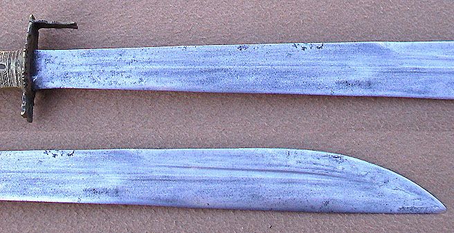

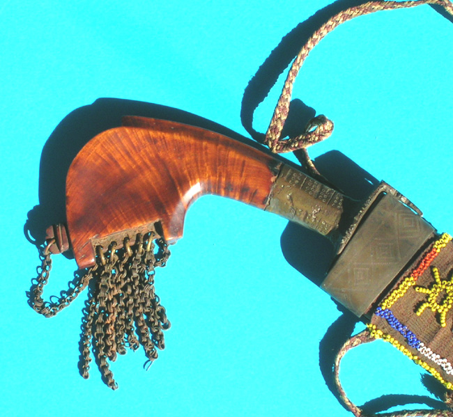

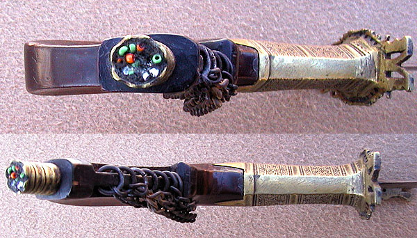

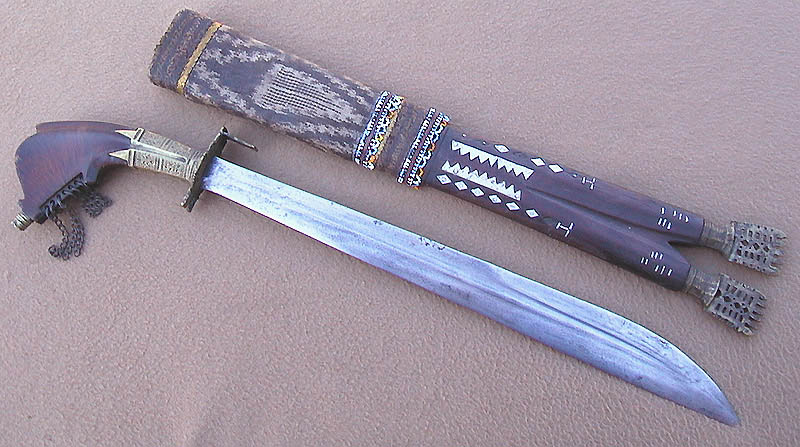

This one is at least 100 years old and is the best quality Bagobo sword I have handled. Note the precision with which the brass ferrule/guard has been fitted to the wood pommel; the decoration of the brass "nub" at the end of the hilt with the presence of small beads within the "nub" (a favorite Bagobo decoration); the excellent quality blade with fullers and a partly sharpened back edge; and the elaborately decorated scabbard with metal inserts, bifurcated toe, abaca textile wrap (worn smooth from handling), and bead decorations. The scabbard closely resembles examples shown in Krieger's plates, and the hilt is very similar to that of a Bagobo datu's sword shown in Dean Worcester's National Geographic (1913) article on Non-Christian Peoples of the Philippines Islands.
Old 13th February 2005, 01:24 PM   #8
Posts: 7,407
W W! Beautiful puppy. Thanks Ian. I am looking for a similar piece. Not seen one since the last 2 on ebay. But this one is a great example. Good pictures.
Old 13th February 2005, 02:42 PM   #9
mmontoro
mmontoro's Avatar
Posts: 91
Very nice, Ian. Great blade and scabbard. Is the false edge very sharp? I haven't seen an example whose blade wasn't the usual kampilan or deep-bellied bolo type.
mmontoro is offline   Reply With Quote
Old 13th February 2005, 08:50 PM   #10
Posts: 4,738
Manny:
The partly sharpened back edge is indeed very sharp (as sharp as the primary edge). I think this is basically a variation on the kampilan blade -- definitely forward-weighted and designed for the same chopping action, although the sharpened back edge and tip would be effective for stabbing too.
Ian.

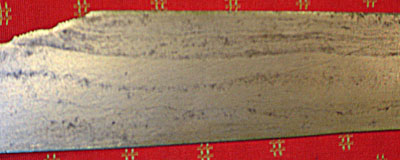

I had the pleasure of getting to handle this sword last night. It's new owner happens to be Battara. There are a few interesting features to the piece which definitely suggests it is not a second half of the 20th century, at least definitely not the blade. Jose had etched the blade and it turned out to be 2 panel twist core damascus with a high carbon edge. I think this is a very rare feature on non-Moro swords from the Philippines. I think that was a pleasant surprise. He had the hilt off of the sword and the tang has a nice blackish patina that would suggest the blade is most probably a 19th century blade. The hilt was a very nice burled wood and the brass ferrule/guard does actually fit the hilt tightly. (they were loose when he received the piece.) We are of the opinion that the hilt, while it may be newer than the blade, is not recent. I think he ended up with a great piece given the twist core blade and lovely hilt. Money well spent.

saw battara's sword (bagobo) in person yesterday and indeed it has the twist core blade! beautiful piece.

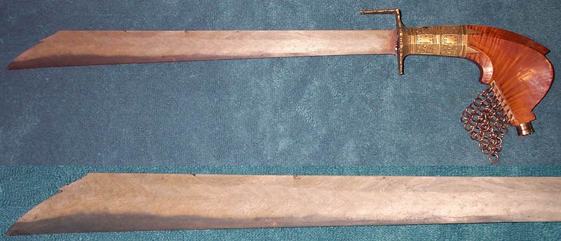

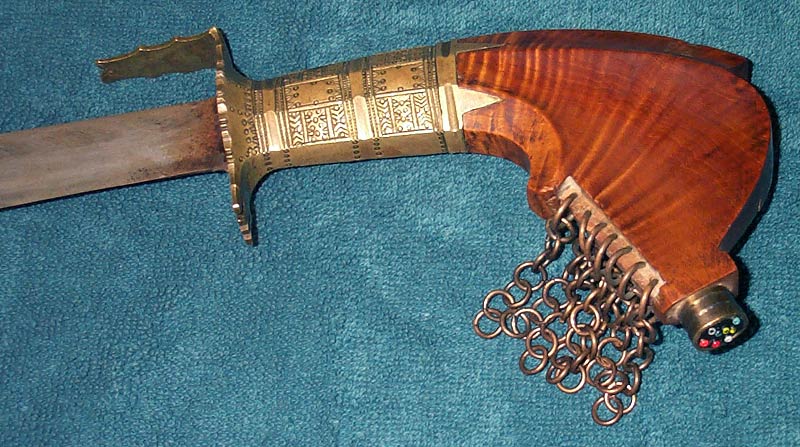

As promised, here are pictures of the bagobo sword after I restored it. I made the chain, the brass end cap (with beads) and etched the blade showing twist core. (sent to Lee for resizing).
Enjoy.

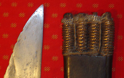

Old 25th March 2005, 11:58 AM   #20
wilked aka Khun Deng
wilked aka Khun Deng's Avatar
Location: Oahu, Hawaii
Posts: 166
Default Another bagobo

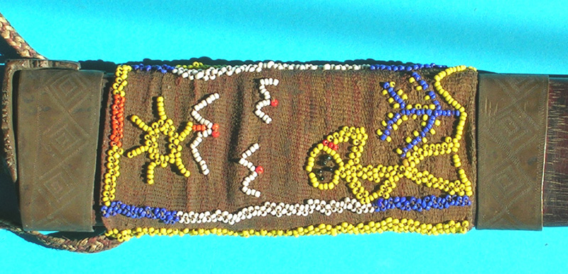

Beautiful Batara, Sorry I've been gone so long. I did get one day off to go sword shopping and here's what I picked up. Scabbards been repaired and the brass is really worn (handle is incredibly small). I especially liked the decoration added to the butt of the scabbard, don't know if you can make it out in the pictures, but it gave me a laugh when I was cleaning it and figured out what it was.
wilked aka Khun Deng is offline   Reply With Quote
Old 25th March 2005, 05:52 PM   #21
Posts: 7,407
Can't tell from the pictures. What is it? Nice piece - don't you just love lamination?
Old 25th March 2005, 06:06 PM   #22
Posts: 4,738
Hi dan:
Good to have you back. That's a very nice example of the small kampilan probably prduced by the Tagakaolo (aka Kaolu) near Davao City in Mindanao. The Kaolu live adjacent to the Bagobo, and not surprisingly share weapons that are very similar in appearance. This could be a Bagobo sword, but the hilt is more consistent with the Kaolu, and there is no beadwork on the scabbard which is almost invariably present on Bagobo swords.
In the past, and perhaps on the old Forum, I would have called your example Bagobo, but I was informed of the distinction between Bagobo and Kaolu swords about two years ago. Many dealers still call these "Bagobo" because the Bagobo are a better known tribe (and their craftwork is considered better quality).
Ian.
Old 26th March 2005, 04:14 AM   #23
Posts: 166
Thanks for the corection Ian.
The decoration wrapped around the four posts are brass wire and ... a zipper!

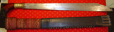

Hi all,
I wish know Your opinion about my one (not so beautyful like Yours). Above all I would like to know about its age and its quality.
Thank You for any help
