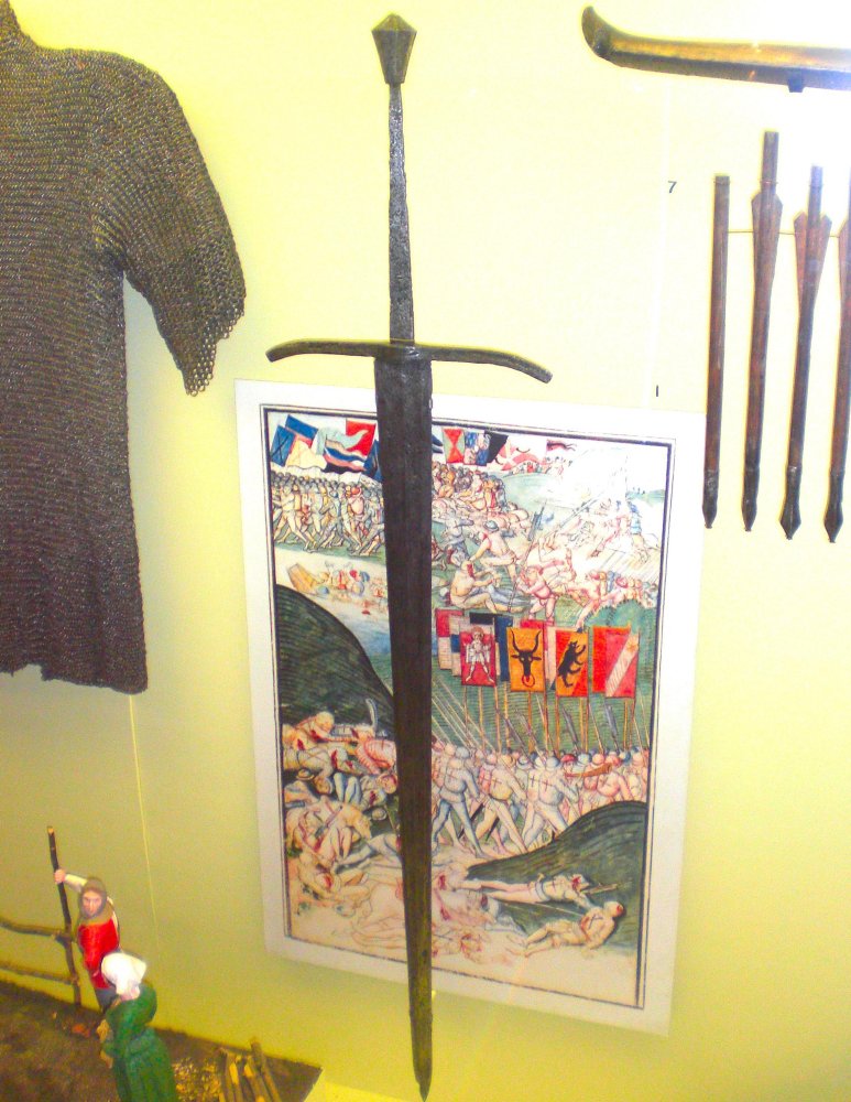

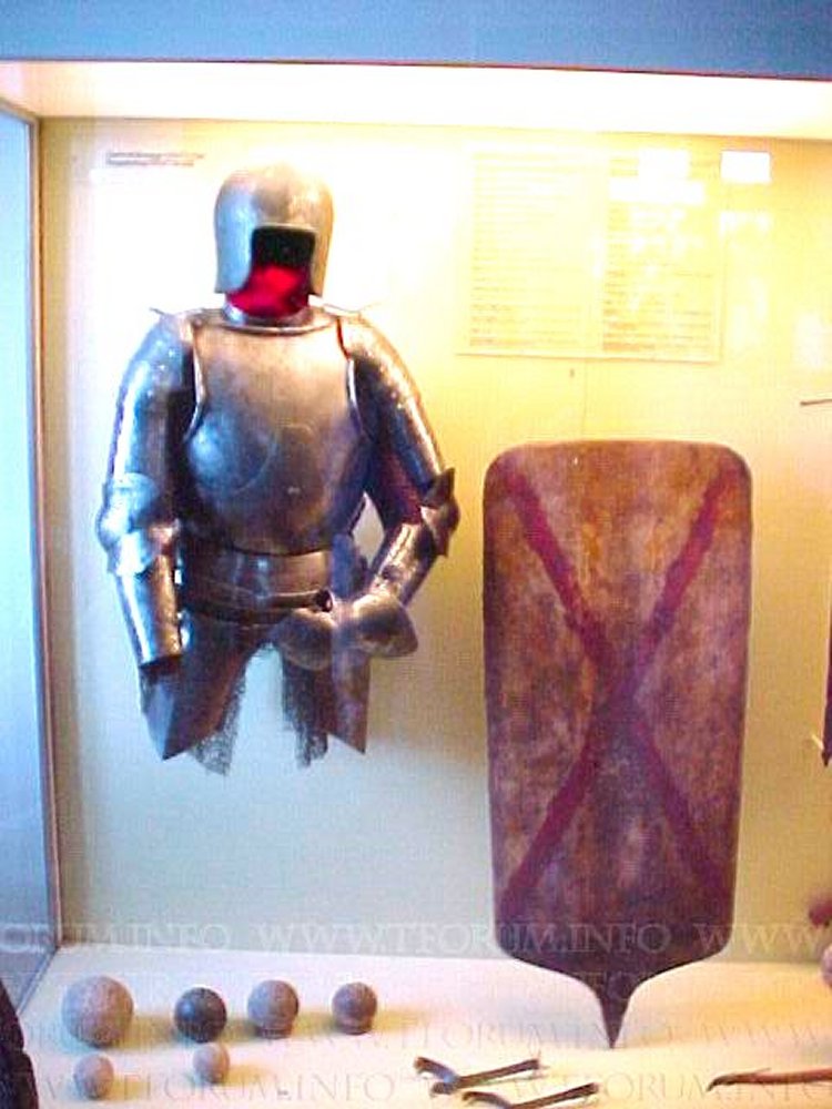

Some impressions, some of them photographed by the author.
Image no. 8 of course shows a very important two hand sword of Sempach type, ca. 1470.
m

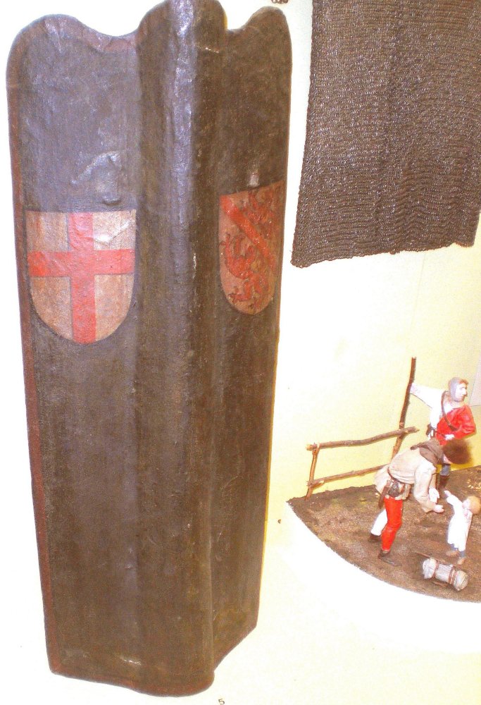

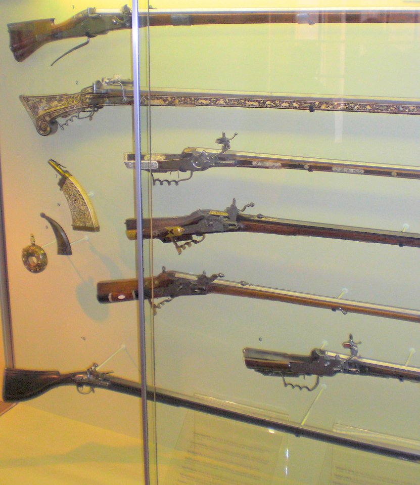

Posts: 4,310
A tiller stocked haquebut, wrought iron, Nuremberg, made for Switzerland, ca. 1450, with sinkhole shaped touchhole on the top flat (almost identical items preserved in the Schweizerisches Landesmuseum Zürich).
A good Late Gothic crossbow with composite horn bow, ca. 1460-70.
A finely painted crossbow man's or handgunner's pavise. ca. 1480.
Below a group of newly hafted pikes and earspoon spears, a good Nuremberg bronze haquebut of ca. 1460-70, retaining an old stock, possiby the original.
A detached chamber for a breech loading cannon, ca. 1450-60, and two late 15th c. handgun barrels (sorry, no details available).
Following various firearms, on top a good and early Suhl/Thuringia/Germany made military matchlock musket, the lockplate shaped like that of a wheellock and pretending a higher technical quality than a simple matchlock, the beechwood stock slightly carved in the characteristic Suhl manner, ca. 1610-15.
m
