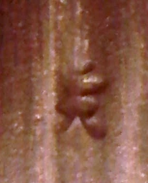

Old 3rd July 2010, 04:02 AM   #5
Gavin Nugent
Gavin Nugent's Avatar
Posts: 2,818
Default an image
Gents,
An image of the marking found on an early straight balded Tulwar.
Gav
Old 4th July 2010, 07:10 PM   #6
Posts: 10,867
Thank you for posting this Gav!
The marking shown here was also regarded by Sir James Mann as the 'twig' marking, and known to occur in various configurations and numbers on European blades. Its appearance bracketed within the 'eyelash' marks suggests that the blade is indeed European ('firangi). Native applied copies of the markings seldom included these kinds of marks between them as far as I know. Naturally I'd like to hear of exceptions, if readers might respond.
