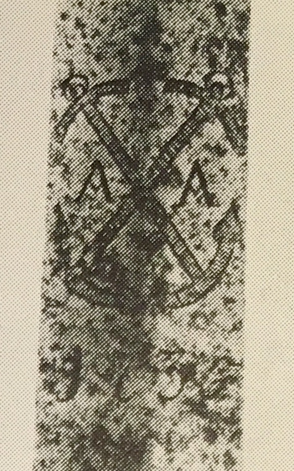

Amsterdam VOC 1685 and two ex Visser collection

Thanks Jasper,
The 1685 is by far the earliest year I have seen on these.
It seems the most predominant is the majuscule A with the drop down V center bar, and it seems the most structured letter. The character and strength of the VOC seems to vary from thinly scribed to heavy with sometimes somewhat irregular lines. .
Naturally this is Amsterdam, by far the major center and chamber, and I always wonder why the usual city stamp marks used on other blades does not occur. Is this because the company was outside the auspices of the usual guild or local controls ?
Also,the other chamber letters seem typically irregular, and not with the structured character of the Amsterdam A. I have understood the R for Rotterdam is situated below the VOC device rather than over as in the other letter markings.
I had heard also of a 'Z' marking for Zeeland, anything to that?
Great examples!!! Thank you, I am very envious of these amazing examples!

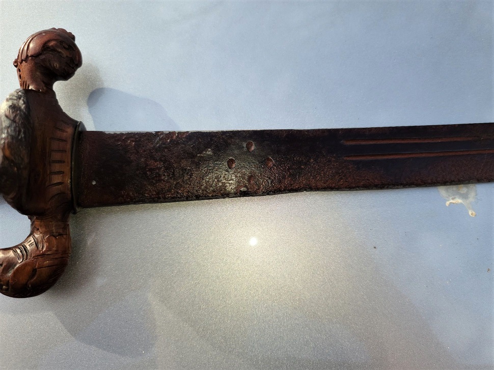

Dutch naval cutlasses in my collection.
1. Admiralty of Amsterdam
2. VOC Hoorn dated 1731
3. VOC Amsterdam dated 1761 post #1
I will later post some more pictures
best,
Jasper
Quite similar pieces are dated to the early 17th century (e.g. http://www.vikingsword.com/vb/showthread.php?t=22245 see #8)
Was this style / model in use for such a long time?
Best regards
Andreas
