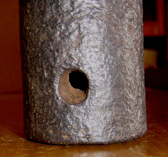

The exterior diameter is 7 cms., the length 18 cms. The bore is about 4cms. at the muzzle and about 3,3 cms. at the bottom. It weighs 3,4 kgs.
The tube interior is sleeved.

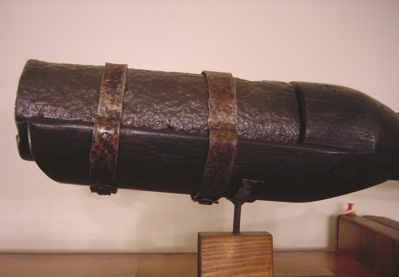

At the stage that i was (nearly) sure this is indeed a hand cannon, i had a stock (pole, haft ?) made, to pretend how the thing would be "on the field".

Good question. Given the bore to tube wall thickness, I (who have taken a chance or two ) would be pretty darn hesitant to fire that thing with a good charge of powder. Then again, I think that it would have been shot with shot rather than a single massive projectile.
OTOH, noisemakers typically have a little lip to hold a priming charge when they are upright.

Thank you so much Ed, for the excelent observations. I must say i am very pleased with your precious input.
Yes, the absence of a lip on the fire hole also drove me to realize this piece wasn't a signal mortar or some sort of upright thunder mug ... together with the fact that it doesn't widen at the basis.
So a shooter (hand canon) it will be, given that no compelling evidence proves otherwise .

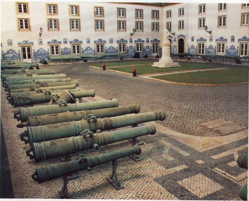

Old 17th September 2008, 12:48 AM   #7
Well, you had them for all tastes
Old 17th September 2008, 12:59 AM   #8

That the Artillery Museum?
Yes. Eventually it was called Artillery Museum till 1926 ... now called Military
Museu.

Your barrel is definitely datable to ca. 1380-1400 and may well be of Portuguese origin. The stock and bands are modern reconstructions but convey a good impression of what the piece might have looked like more than 600 years ago.
Several barrels of similiar shape and dimensions were dug out from the battleground of Aljubarrota; the battle took place in 1385.
The attached image is from Prestige de l'armurerie potugaise. La part de Liege. Musee d'Arms de Liege, exposition catalog 1991, p.42.
Unfortunately, this photo shows two originally separate small barrels, one round and made from wound band iron (the older) and the other (the later one) octagonal, obviously foolishly hammered into each other for some reason at some later time. So just concentrate on the left barrel, the round one, and you will see the close relationship to your piece.
I also enclose two images of a very similar barrel from Aljubarrota in my collection; it is of almost identical statistics as yours. It is made of wound band iron and fire-welded, just as those found in Aljubarrota, and may be as early as ca. 1360. There is a maker's mark, an arrow head, deeply struck in front of the touch hole which indicates that this workshop was traditionally associated with manufacturing heads for crossbow bolts and arrows. The catalog text given below also mentions a mark in front of the touch hole.
