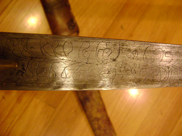

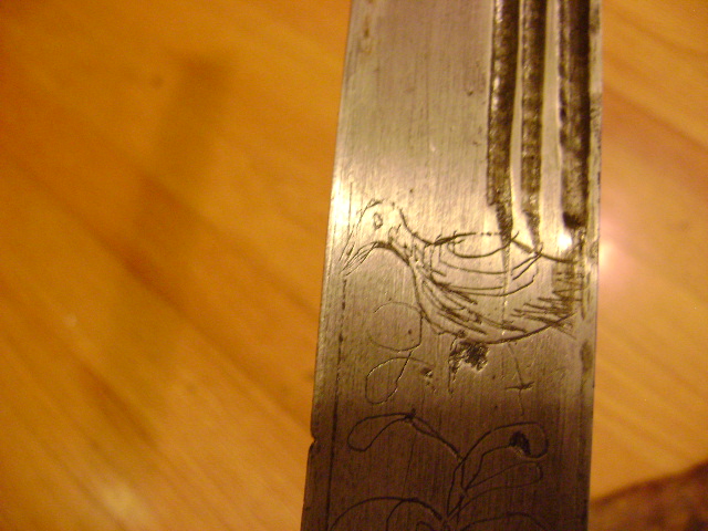

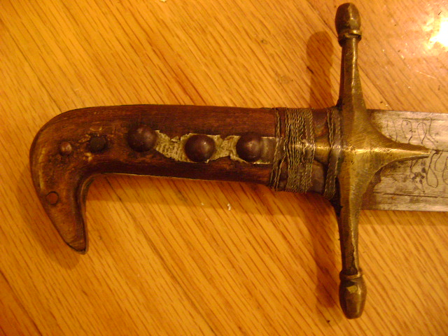

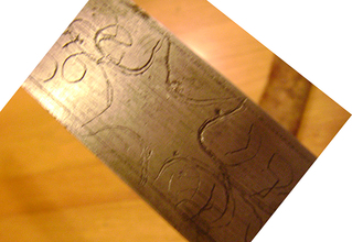

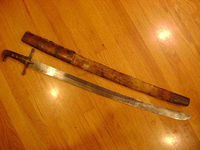

Sometime ago, I saw a saber on e-bay that was advertised as Yemeni Nimcha. Since I am a complete sucker for those little and unsophisticated things, I looked and saw several features that were... welll... bizarre... To make the long story short, I got it. Not for a song, but for much less than a price of a dinner for 4 in a good steakhouse :-)
So, it came.
First thing that struck me was that the blade was of even width throughout, unlike Yemeni things that usually get wider toward the tip. Second, the simple incised decorations were vaguely familiar, but I could not place them other than to notice some european flavor. Also, they showed the Star of David ( well, that's my background; had I been a Muslim, I would have called it Seal of Suleiman:-)). And, even stranger, it had a very realistic picture of a bird. Well, AFAIK, no religious Muslim ( and there were unlikely many atheists or heathens in old Yemen:-)) would have put one on his sword!
And, third, the pommel was of the most unusual shape: not a Badawi one, leaning down, not a Persian one with the 90 degrees angle, and not a "Saudi" one, tilting upward. Instead, it looked like a rounded triangle.
Please see pics now.
Old 17th December 2012, 12:35 AM   #2
Then, I went to the books.
And, in a Hungarian book by Kovacs S. Tibor ( Hungarians are strange peiople: they put their first name last. Anywhere else in the world the author would have been known as Tibor S. Kovacs, G-d bless him:-)) "Huszarfegyverek a 15-17, szazadban" ( Hussar Weapons of 15-17th century), I found a very similar one, with the same pommel, dated to the 17th century, and even a 1560 gravure of Gyorgy Thury, " the Hungarian El Cid" carrying a very similar one!
So, even if I did not get a Yemeni nimcha, I might have landed a significantly more intriguing find.
I am very happy, but want to exercise a healthy degree of caution and ask you for your opinions. Where did I go wrong ( hopefully, you will not find a flaw:-))?

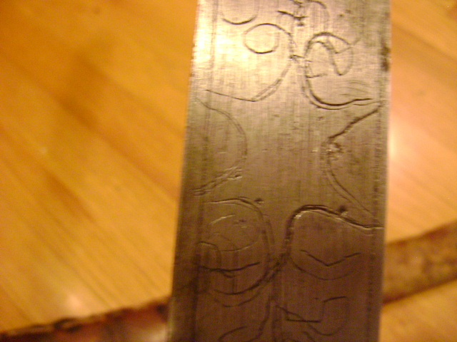

those drawings on the blade look like mere scribbles, possibly by the owner. they dont look professionally incised.
TribalBlades is offline   Reply With Quote

Interesting sword, No idea on the hilt...
Sometimes Syrians put slighty better renderd Doves on the blades, sharks to on occasion.
Doves & sharks is that the light & dark sides of weapons?

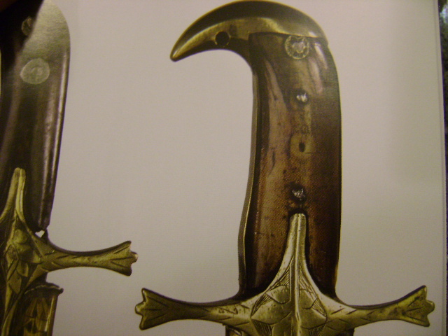

The hilt looks identical to the ones coming out of Iraq. I have several come my way with wootz blades. The pattern seems that Iraqi's would have diff styles but rarely (if ever) cover the pommel.

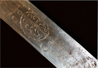

Attached is a pic of the so-called Transylvanian Knot, a magical/talismanic mark on Hungarian blades XVI-XVIII centuries. There were several variants, see lower right and left.
Would love to see Syrian/Iraqi examples.

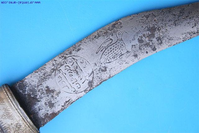

Heres a poor dove on a Shibrya, {not mine.} {Dated 1942.} {photo at bottom, of all others....
& A shark {or tuna? } that is...
Top one in this photo.
Dated 1940.
Seem to recall seeing one on this forum on A Yemini Jambiya as well?

All of these came from Iraq. There was others aswell, one with a hilt very similar to yours but with a majari blade. It is sold now though.
The blade inscription is very poorly done, I expect someone tried to imitate majari blades :P

What was always a mystery was what in the world were the strange words with those distinct 'z's , a maker, a motto?
Eventually in a transaction with another dealer I traded this away and quite clearly for 'a song' compared to what it cost me and now, even more clearly, it was more intrinsically valuable than I thought. He had minimized the wording and devices as 'jibberish' and insignificant, completely indecipherable.
This moment in reading this I realize those blade markings are exactly what you describe as the 'Transylanian knot', and something extremely important to me with my fascination in blade markings.
With the sword you have posted, the markings are clearly 'field' type ersatz markings applied to a refurbished sword in any number of circumstances in the long working lives of these Arabian sabres. It would appear to me that the stylized beaked birdhead hilt is compellingly like this early Hungarian form, and quite possibly an example of early components with added crossguard to the original blade, maybe even the hilt. I would be inclined to think that the hilt form, although shown as 17th century probably remained traditionally used well through the 18th c. in Hungary and environs. It certainly presents tempting associations worthy of further research.
I'd like to know more on this 'Transylvanian knot' for my own purposes on blade markings, and what sort of talismanic use etc. I know it doesnt necessarily apply to this blade overall, but the link to the sabre I owned years ago seems in accord with this example.

The Shibriya from Artzi Yarom's collection bears the engraved picture of a bird-like creature. This is eerily reminescent of the Transylvanian Knot motif.
The TK motif was very popular on Caucasian, more precisely old Circassian blades. They were mostly imitation and re-interpretations of the decorations seen on the imported Hungarian blades. Examples of real and Circassian-interpreted renditions are seen in the book of Astvatsaturyan on Caucasian weapons.
Circassians were forcibly exiled by the Russians in the 1860s. They went to the Ottoman Empire and were resettled in the Turkey proper, but mainly at the remote areas of the Ottoman Empire: Balkans, Syria, as well as what is now Israel and Jordan. The future capital of Jordan, Amman, was in fact a Shapsugh town, and there are Circassian villages in Israel - Rehaniya and Kfar Kama.
They still carry their old weapons and manufacture new ones with their ancient Circassian motives. The shibriya in Spiral's pic, - the one with niello, - has classic Circassian decorative motives, too: sparse geometric figures of bull horns.
I am wondering whether the shibriya shown here is one of those examples, and the "bird" is a remnant of the old Transylvanian Knot: Hungary to the Caucasus, to Israel, - a long and tortuous trek...

A colleague from the Russian Forum kindly provided a picture of an old Transylvanian blade ( Hungarian hunting sword) with their magical signs. He suggested that the Seal of Suleiman on my blade is apparently a primitively-drawn motif of the " white magic" symbol.
Old 23rd December 2012, 12:02 PM   #25
Posts: 10,862
Hi Ariel,
Thank you for posting these additional images, and that information. I was just reading another post by Vaho on his article on the Khevsurian 'dashna' and just now realized how closely some of these 'white magic' geometrics and images might be found in that context as well.
It seems in Askhabov ("Chechen Arms") some of these curious 'looped' corner devices are seen on some of the blades and I wonder if these could derive from the Hungarian blades which entered Caucasian areas.
In looking at this sabre in your original post it is tempting to note how closely the blades and sabres in Arabian context are to some of the Khevsurian sabres in thier rugged nature and the clearly established Hungarian denominator in blades, as well as perhaps some hilt features.
It is sometimes hard to imagine the complexity of trade and cultural diffusion between areas not typically thought of as directly connected.
All the best,
