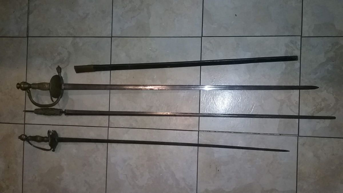

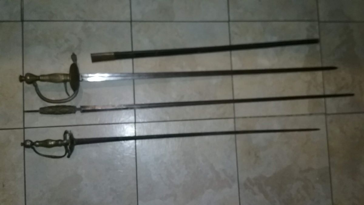

I still don't see any markings on the unmounted blade. There may be some faint etchings under the oxidation, but I don't think so.
I've attached some side-by-side pics of the blade next to other items for comparison. The bottom is a small sword with rococo-style hilt that this forum estimated to be from around 1760, or so. The top is larger than a small sword that the forum estimated to be from early 1800s.
The tiles are each 12"x12", so the unmounted blade measures about 3 feet, 4 inches long. Another inch, or two might be presumed to have existed before the tip broke. That said, there is no unsharpened riccaso, so I suspect that limits the type of hilts that would have once been mounted. The tang meets the shoulder of the blade, and then it is sharpened almost directly past that juncture.

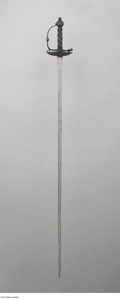

the blade is indeed to long for a small sword, it could very well be from a transitional rapier circa 1640 like the one in the picture from the Wallace Collection.
This type has no real ricasso like your's , I have a similar one in my collection its also a lot longer than a small sword. How wide is the blade at the widest point ? my blade is 2,2 cm wide and 104 long .

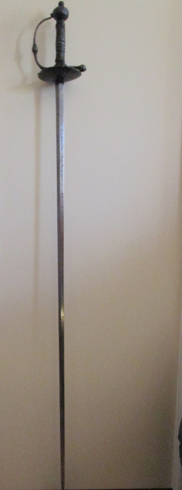

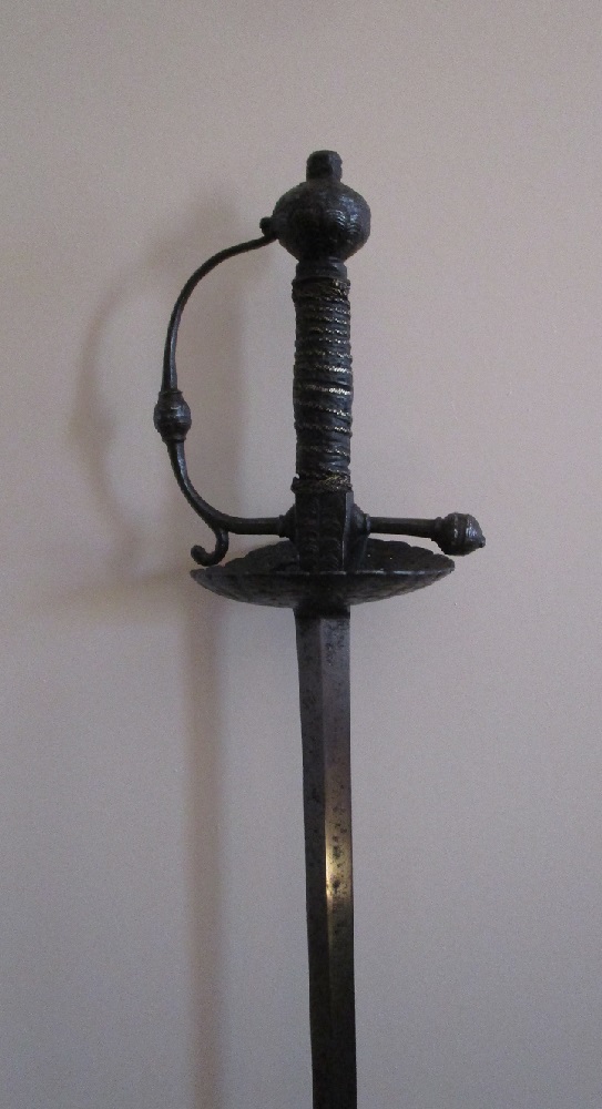

So, upon taking a closer look, the grip appears to be wrapped, not in cord, but in a woven textile material that has been dipped in something like pitch(?). I'm attaching close-ups where you can clearly see the woven pattern. Is this at all typical of a period replacement?
I hope everyone is staying safe during their COVID lockdown. The question I asked in post #16 seems to have been lost as we moved on to discuss the name on the ricasso. Any insights into this treatment of the grip? I seem to see similar grip covering on other examples from the period and would love to know what it is, and if it might have been part of this weapon's functional life.

thanks for the reminder and the clear close up picture.
It is hard to say if this textile is a replacement during working life.
Some gripwire's had textile underneath but these are of very fine woven textile nothing like this.

Just adding this link to a thread which discusses a similar textile covering on the grip of a khanda.
http://www.vikingsword.com/vb/showth...574#post280574
Not sure if this suggests the Pappenheim may have spent some time in South Asia, or if wrapping the grip in a textile impregnated with pitch was a fairly widespread (albeit not common) practice. I know the grip on the Pappenheim was originally wrapped in wire, and this example retains a single Turks Head. Yet I remain intrigued by this surviving material.
