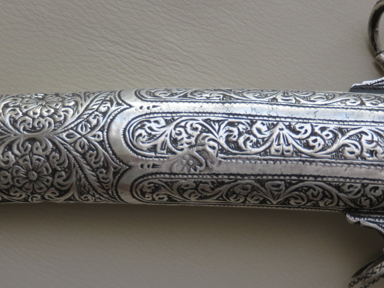

Hi All,
I am new to the forum. Just bought my first Koummya and first piece in my collection! I believe it is a real deal and not a tourist piece. That is what i would like to confirm here please. The blade is 9" Hilt is 6" Scabbard is 11" I cannot see any hall markings on the scabbard, nor can i see any marking/ stamps on the blade.... However there are some numbers possibly dates? I have been trawling through the archive forums and can see that there is real wealth of knowledge on here and a great bunch of people. Look forward to your comments. |

Hi and welcome to this forum. My knowledge of koummiyas is limited, so you will have to wait for the real experts. However, it is clear that this is a very high quality work. Too good to be a tourist item. The silver engraving is esthetically very nice and of high quality. The blade is good. Lack of marks is not a problem because in most cases, engraving on the blade would mean Europeanblade or post 1900 blade, probably for tourists.
There are two questions that will determine if this is a very good piece or an excellent and rare piece. First, the material of the hilt. It appears to be rhinoceros horn, but the color is much darker that in most koummyia. A close-up photo could help, but only microscopic examination could provide definitive answer. Rhino horn was used only in the very best pieces. Second, there a number on the scabbard which could be a date. The number is 1144, where the first 1 is stylized. 1144 is 1731/2. I have never seen a koummiya from the 1700', so I doubt this, but if correct, it would make your koummiya a truely outstanding piece. Anyway, this particular type has been imitated and reproduced by the thousands, so you must have a keen eye, a lot of luck, or both to choose this particular one. |

It's an excellent koummiya, probably from the end of 19th c. With a silver proof mark (the numbers). Never worn, of course. Despite a good blade, this dagger was never used. Good catch Kubur |

The numerals on the scabbard are a dating peculiar to Morocco.
They reflect a hijri date, but expressed in European digits: 133[0] 1330 = 1911/12 |

As already noted, the Koumiya of the topic starter has a silver mark.
It is a silver mark from Marrakech from the 1918. Since the scabbard is oval, the visible mark is incomplete, the date should be 1337 with Arabic writing. Several towns in Morocco has used each its own silver marks which changed over the time. In the reference book I have used (Bijoux du Maroc by Marie-Rose Rabate) there are several pages with the Moroccan silver marks. |

I would really like to accept your answer and see this thread conclude with real explanation, but I don't see on the koummiya what you mean. I don't see a 7 anywhere or where it could be hidden, the number could either read 133 in "normal" numerals or equally as 441 in Arabic numerals (if you turn it 180 degrees). There seem to be some letters (three dots could belong to a Thaa), but they are stylized and I can't read them, or possibly, they are abstract symbols. If you say it is a Marakesh mark, then I believe it, but what about the year? In the silver marks I know, there is no year in the mark, but some code denoting the year, like a letter or letter-number combination (also in many European marks). |

It is very interesting what you said about the hallmark being from Marrakesh, i have uploaded a closeup pic from the back of the scabbard. There is clearly written in arabic "Kesh" and stylized Mara i think. It makes sense. Would you be willing to attach a pic of the page from your book please? |

It looks like the back of scabbard has the lower part of the silver stamp!
The silver marks are in the second volume of the series: Bijoux du Maroc Du Haut Atlas a la Mediterranee, and this book is difficult to find and it is very expensive. The smart priced one is a second edition of the first volume Bijoux du Maroc Du Haut Atlas à la vallée du Draa. My first edition of this book has no silver marks in it. Here is the picture: Last edited by Tatyana Dianova; 10th June 2017 at 08:51 PM. |
