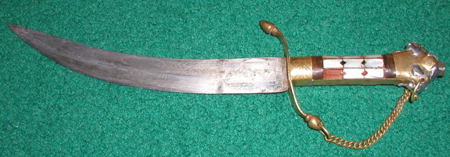

Attached are several pictures of what I believe to be a 'Turkish' dagger that I picked up very cheaply at a local coin shop. I believe it's origin may be Ottoman Turkish, World War I era. Extensive repair ( crude ) work can be readily seen on it's handle. The handle sports 'mother-of-pearl' and wood inlay. It has some sort of acid etched inscription on the blade which 'almost' appears to be the English word 'Victory', however at the base of the letter 'V', the two lines forming the 'V' do not meet to truly form that letter. There was no sheath that accompanied it. If anyone can provide any information based on this limited information, it would be truly appreciated. A better image of the inscription can be provided if requested to help in it's possible identification.
Thank you all in advance for any help that you may be able to provide !
Warmest regards to all !
Mark.... Wapwallopen, Pennsylvania, USA
Aurangzeb is offline   Reply With Quote

I do not think it is Turkish. It looks more Indian to me, and I believe daggers such as this one were made in India in the first half of the twentieth century for westerners fascinated with everything oriental.
I am sure someone will add more information, though.

Hi TVV!
I whould have never thought in a million years it was from India! With the metal chain on the hilt I whould have thought it was middle eastern/turkish.Considering I have seen many Iranian/Turkish cavalry swords with sutch metal chains on them.That is what led me to believe it was Turkish.Keep in mind the Metal blobs on it are my own repair work.Is this a relative of the jambiya or not.The one book I read said it might be Mexican.
Thanks for the help so far!

Default Definitely Indian
Well made Indian knife from end of the 19th C. or early 20th C. Made for European trade, as mentioned. The mosaic mother of pearl on the hilt is characteristic, as well as the brass guard and ferrule. I have its cousin that I will be posting shortly in the Swap Section.
Often these have the words "Victory" etched on one side of the blade and "Pure Steel" on the other.
Ian.

Posts: 184
From what I have seen I believe that these are called kirpan and made by the Sikh in India.I have never seen one that I thought was older than the late 1800s but supposedly these are more modern versions of a traditional form.{feel welcomed to correct me if I am wrong}

Hi all!
Now that we have established that it is Indian,whould this have had a sheath,if so what whould it have looked like?Never herd of this type of weapon,odd it only has "victory" written on both sides.

Mark:
Take a look at my post in the Swap Forum today. There is an almost identical knife with its sheath.

Hi Ian!
Oh My! It is like they chould be twin daggers!Nice price you are selling it for,I bought mine very cheap!I might even sell it for that musch.
Thanks everyone again for all the help!!!
P.S.-I am about to contact a freind who is a great wood worker and have him make part of the sheath and do the brass fittings myself.

Posts: 371
I freely have to admit to having egg on my face over this one (and Justin's too, for that matter ) as I have one nearly identical to Ian's swap item, complete with scabbard only with a simple bone hilt and was told years ago that these were called "kirpans", used by the Sikhs of India.
On the other hand, I've had several with nearly identical hilts that had fullered, damascus blades and, occasionally, reinforced, armor piercing tips and were told that THESE were the ones made for export or take-homes by colonialists, leaving me as confused as embaressed.
In truth, these two are the first that I've seen with the combination of the chain guard and the inlaid MOP hilts.
My next question, I guess, is to ask is anyone else has heard of a "Kirpan" and if there is any validity to the claim that it is a style of knife associated with the Sikhs?
My second question is, pertaining to the blades on these three, doesn't it seem strange that the words "Victory" and "Pure Steel" would be found on knives of the late 1800's/early 1900's?
Perhaps it's just me and exposure to too many Philippine knives circa 1945, but this time period just seems much more appropriate and logical than the earlier designation.
Mike

Posts: 6,442
Hi Mike , I believe kirpan is a generic name for a sword . Nowadays they are small but back in the day the Sikhs had to fight to keep their territories and defend themselves from both Hindus , Muslims and other agressors .

Posts: 371
Thanks Rick....I had been told that the chain-hilted dagger/knife with the curved blade was the "modern" (for the past 150 years or so) symbolic incarnation of the sword as the Sikhs had become more civilized and carried by them much in the same context that a rosary might be carried by a Catholic or prayer beads by many muslim or Tibetan sects.
Which brings me back to my original question....are Aurangzeb's and Ian's knives/daggers versions of a kirpan, made the same as the kards with that same hilt that is more commonly/usually seen and that lacks the chain and guard altogether (I've had approximately a half-dozen over the past 7 or 8 years)?
Mike

Hi conogre!
Althogh I am no expert I whould say that they are.I have seen the type of knife you are talking about and to me the resemblence is to similer to be quincidence.O course this is only a novices view so I might not be correct!
P.S.-Was that you I was bidding against recently on 'Ebay' for a arab knife?

Location: Houston, TX, USA
Posts: 1,254
There seems to be some confusion occuring between this, a Sikh kirpan of fairly usual style, and another type of blade, obviously made in the same area, which is a version of a salwar yataghan or pesh kabz with generally smallish blades and a deep groove near the spine, rather than a "T" spine. It is these which are always spoken of as for the foreign (mostly English?) market. The kirpan is for Sikhs, and each Sikh man must wear one at least symbolically (not sure about the women). Its sale to foreigners is incidental. Interestingly, the word "victory" which we are used to as a wwII reference, may be a reference to victory in spiritual struggle in this context.
