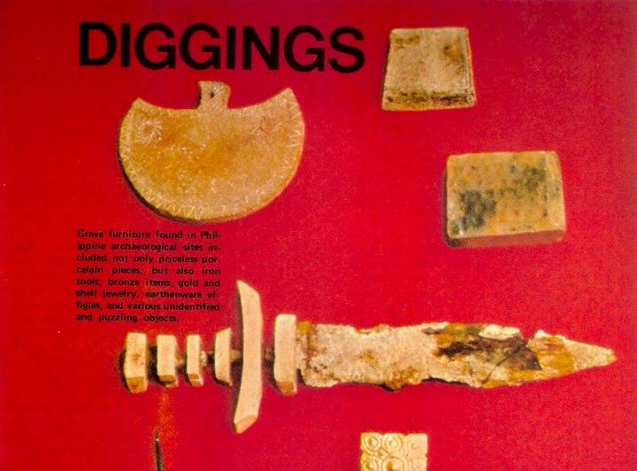

In vol. 2 of Reader's Digest's Kasaysayan: Story of the Filipino People, there's a pic (below) of a precolonial (pre-16th century) kris.
Later on, I found out that the artifact was excavated in the 1920s by an American archeologist [Carl Guthe, from the Univ. of Michigan], in the town of Loon in Bohol Island in the Visayan region of the Philippines.
This Visayan kris was estimated to be coming from the 10th to 15th century. The kris is still with the University of Michigan (Ann Arbor), at its University Museum of Archaeology and Anthropology.
More details are to follow.

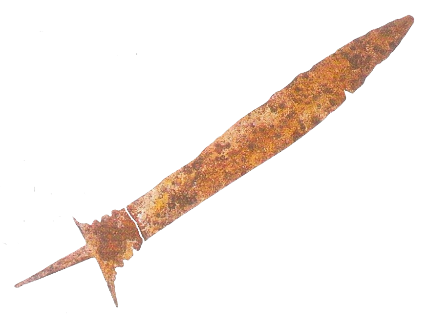

Here's a close-up of the said Visayan kris ...

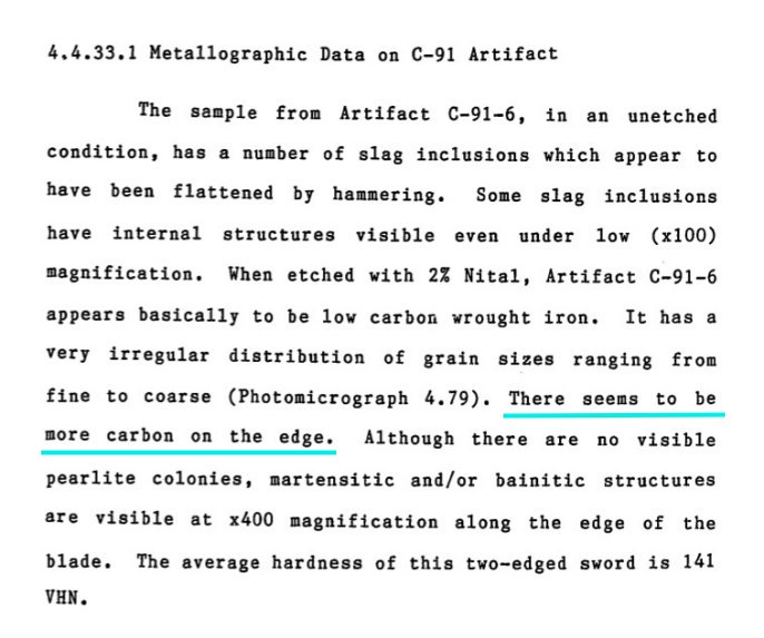

The details surrounding the Visayan kris can be found in a Univ. of Penn. PhD dissertation of a well-known Filipino archeologist, Dr. Eusebio "Bong" Dizon, from the Philippine's national museum.
The dissertation can be bought online from the university. The illustration below comes from the said paper.
Based on the graphical scale, the blade length is 36 cm (14.2"), blade thickness near the guard is 0.8 cm (5/16"), and tang length is 8 cm (3.2").
Please note also that the tang has a square/rectangular cross-section, as is the characteristic of Philippine krises.

The textual description of the Visayan kris:

For the technically-inclined:
Old 17th May 2011, 09:07 AM   #6
migueldiaz
migueldiaz's Avatar
Join Date: Oct 2008
Location: Manila, Phils.
Posts: 1,042
Incidentally, the dissertation covered 75 pieces from the Guthe-Michigan collection, plus another 10 artifacts from the Phil. national museum.
As to the basis of the age of the artifacts, I've just leafed through the paper (it's about 500 pages long). The 10th to 15th century dating can be found in the excerpt below.
I suppose they also used the associated Chinese ceramics excavated together with the metal artifacts. These Chinese ceramics provide a pretty accurate metric, and are used all the time ("Nacho" is an expert on this also).

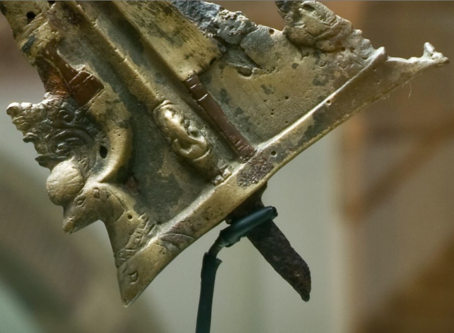

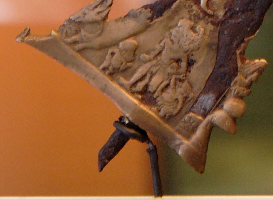

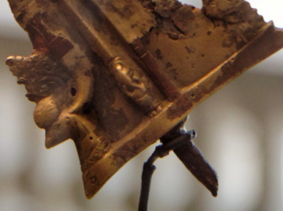

Here's the continuation. Below are pics of Philippine gold hilts from the 10th to the 13th century. A little later, I'll post the comments of the southeast Asia expert from the Metropolitan Museum (NY) on these artifacts.
Kindly note that one of the hilts show the bird beak/ elephant trunk motif.

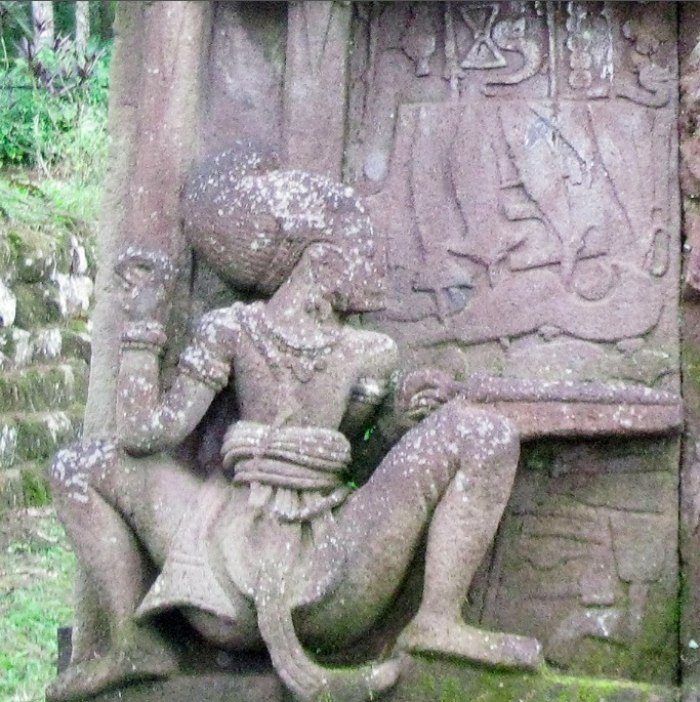

Back to Javanese weapons from the 10th to the 15th century, here are some pics from Candi Panataran and from Candi Prambanan, for comparison with the subject kris.

Old 19th May 2011, 02:49 AM   #30
migueldiaz
migueldiaz's Avatar
Join Date: Oct 2008
Posts: 1,042
That Knaud keris sure is interesting, to say the least. There are many pics on the Net and two are below. They came from here: knaud_1, knaud_2, knaud_3, knaud_4, knaud_5, and knaud_6. Thanks.
