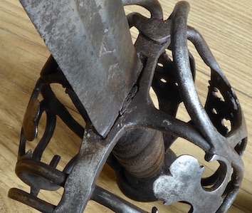

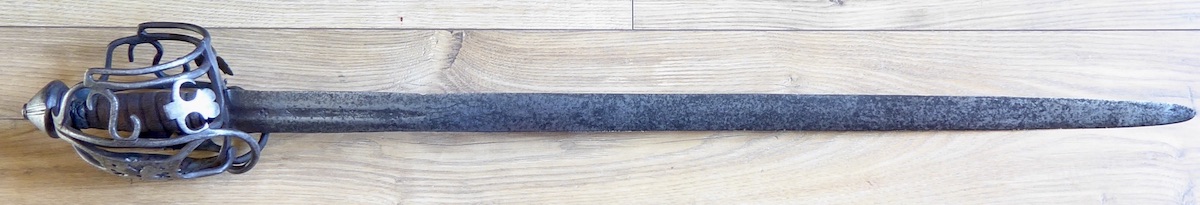

Hi,
A new acquisition. It came to me in a pretty poor state but I think I've managed to salvage something worthwhile from the rust. I'll let the photos do the talking meantime.
Norman.

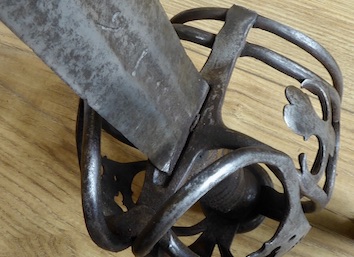

Hi,
This is the condition in which the sword came to me.
Norman.
Old 26th February 2023, 08:33 PM   #3
Great work, Norman .

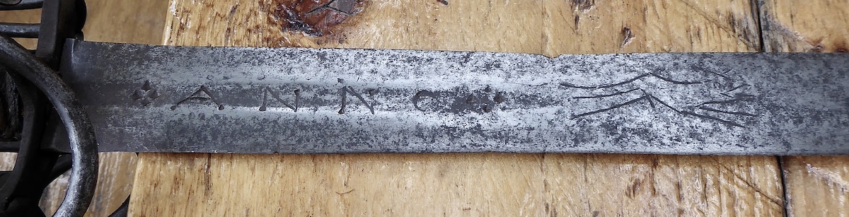

Wow! How on earth did you manage that?? It looks fantastic!
I guess it dates back to 1693 because it says ANNO on the blade on one side. Also, is that the running fox of Shotley Bridge on the blade?

Wow Norman! theres a beauty of a Glasgow!!!
Nice job of getting it cleaned with patina still intact.
While the date is likely proper for the sword and its hilting it is not necessarily the date of the blade.
It is likely an earlier Solingen blade, but the slipper (cutler) probably added these spurious markings for obvious reasons. The ' Passau ' wolf (notably used by Solingen)was of course well known to these cutlers, and this is a fairly ubiquitous rendition of the usual form. These were often seen of course on Solingen blades with numbers presumed to be dates on either side (16....wolf...56)however the wolf on Solingen blades was typically upside down to the numbers.
It is unusual also to see ANNO (in) on one side while a date (or perhaps number combination on the other.
These were hilted during the long Jacobite troubles period beginning c. 1689 and going on into the 18th c. with the '15 and '45 the most well known events. The 'magic' of these well known inscriptions and markings of Solingen were not lost on these cutlers, so their addition of them to extant blades in those times would have been well placed.

An exemplary description of the dates and wolves Jim (as usual).
I have a Hounslow Hangar with a latten version of that wolf and it is - as you point out - reversed.
The inscription is ANNO 1553 and for a long time I was frustrated in finding a connection between a 1630s sword-blade and an event in 1553 (which was the tragic 9 day reign of 16 year old Queen Anne before being executed).
Your suggestion that the numbers were probably talismanic hit the mark.
I agree, this broadsword blade was probably Hounslow made and re-hilted during the Jacobite rebellions with the numbers added then.
There is much contention regarding the importing of Solingen blades into the Hounslow industry versus the use of the Passau Wolf by those Germans working there and I don't think we will ever reach a satisfactory decision.

As you note, there will never really be a consensus on the overall circumstances involving the German makers in Hounslow early in the 17th c., later in the century Shotley Bridge. Your research over these past years have brought forth the most compelling overview of sword production in England involving these.
It would seem that with both of these production centers and the German smiths featured in them, there was potential for both actual blades produced as well as an undetermined number of imported blades to enhance the production volume. As there were numerous shops and makers, there were various options present, so it would be hard to say one thing or another adamantly.
On this blade (OP) it appears clearly that the date, and the wolf were spuriously added, but this only enhances the possibilities of the sword and its assembly, which would have been in the turbulent times of the latter 17thc.and in these regions of Scotland and northern England. We have learned that the Border Reivers account for many of the interesting sword types in these times and the innovative skills of their armorers in making them.
It would not be unreasonable to consider one of these 'sword slippers' using a blade from Solingen and copying the convention of anno/ numbers and wolf in legitimizing the weapon with imbued character.
The use of numbers, while in some cases might indeed represent a date, many are commemorative as suggesting key dates aligned with important events to the existing climate of the time, or indeed represent talismanic numbers. The word ANNO simply means in 'the year of'. ...so would seem to signify a defined year, but whether made then, or recalling another date, who knows.
With your sword and the 1553, there was no doubt it was talismanic as the blade was obviously not of that period. Oner of the most common number combinations has been 1414 or sometimes 1441, but there are various other combinations (Wagner, 1967).

This is the Hounslow cutlass I have, and the running wolf, while in latten, as is Keiths, as often seen in some Solingen blades, its configuration seems contrary to those of Solingen.It also stands alone, without date, numbers etc.
In " Arms and Armor in Tudor & Stuart London", M. Holmes, 1957, p.30, "...as has been said, Hounslow swords are generally single edged cavalry weapons for cut and thrust work, or curved cutlasses for use at sea. The backs of these latter are often serrated'
* a footnote from another reference from 1686 has mention of sawing with a backsword by a shipmaster, indicating these were still in use by this date. This example is likely of the late 1630s in line with the number of other examples aligned with this.
On p.33, it is noted, "...a cutlass with a serrated back dated 1634 marked with the fox, a symbol occasionally found on Hounslow work".
It has often been suggested that the German makers of Hounslow and later Shotley took to using the running wolf in a sense to spite their former allegiance to the Solingen guilds. I think that is on the contrary, and that the convention of the wolf image remained a talismanic imbuement from the earlier days of the famed 'Passau wolf' where such markings were indeed intended in this manner, and were deemed among other amuletic devices known as 'Passau art'. This was of course picked up by Solingen where in addition to the image suggested quality in addition to its more occult placement prior in Passau.
This practice was surely adopted later elsewhere, such as Shotley Bridge where it is believed the wolf became a bushy tail fox, which carried into later Birmingham manufacture with Samuel Harvey well into the 18th c.

Johannes Wundes appears to have been the principle user of this particular rendering of the Passau Wolf.
He put this image on blades he supplied to Passau merchants who were selling to Passau mercenaries of Arch-Duke Leopold V. (see image)
The Munsten family also used this same style of wolf, so these blades may have come from Solingen or might have been made by Peter Munsten (the younger) while working at Hounslow.
Olligh, of Shotley Bridge fame, did not use the Passau Wolf as has been assumed on many occasions. Those blades marked SHOTLE(Y) BRIDG(E) with a Passau Wolf were smuggled-in by Hermann Mohll at the start of the enterprise. Once Olligh attained independence he went back to using the Bushy Tailed Fox.
It is probably impossible to determine where blades came from purely by the presence of the wolf.
However, I think Norman's sword-blade came with the wolf and the date was added when it was re-hilted. The presence of the wolf is what made the blade desirable and worthy of a re-hilting.
