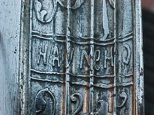

Gentelmen,
I submit to you what is if I am not mistaken a mutation of a Russian cavalry officer saber M.1817
I would like to know anything you could tell me about the blade. I am totally ignorant on the subject of Georgian weapons. I cannot decypher the initials of the original owner as well as one of the the inscriptions.
Where in the Caucassus has this blade been made?
Please notice the "gurda" mark as well as the maker's name.
On the pommel a Polish "Jastrzebiec" family coat of arms and owner's initials. Note that the initials are in Latin and not Cirilic what could testify to where the man's loyalties laid...

And again bice object. You've got suprisingly good collection of Polish weapons, and I'm glad about it... and jealous .
I won't confirm the model of this sabre, because I'm far away from my resources for a few days. What is quite suprise, is the mark on the blade, I mean those sickles, which are usualy and most often seen on the 17th century sabres.
"K.Z" - did you try identify the owner of this sabre. It's not easy, but maybe I will dig some genealogy resources, who knows what can you find out there

I am quibbling about the "gurda" mark.
The blade is of Russian manufacture, and even has a name etched on it , something like " Neizvil" , in Cylrillic, but I just cannot see it clearly. Please note that the "gurda" was placed on top of the already existing fullers. It must be a later addition to the blade.

Hi Ariel,
The name seems to be "S. Neishvili" if I read it correctly, a Georgian name and since a gurda mark with strings of dots is typical for Georgian manufactured blades it made me think of Georgian production.
Any record if such a maker?
I have nor encountered a similar example yet but I assume production of private contract blades for well to do Russian officers must have been commonplace and a large part of the economy of the day.
