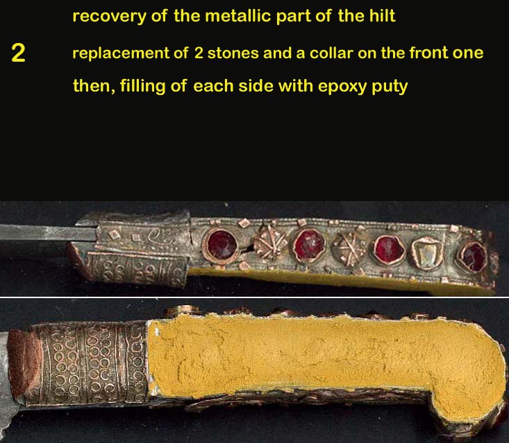

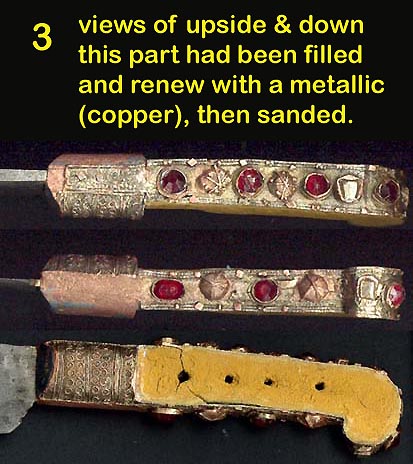

Unfortunately, old blades we find are not museum items, but genuine and interesting for their blade...with hilts a bit destroyed or more.
We are not restoration specialized craftmen. We just try to give a bit of live to the hilts....
See the attached pics.
For the nimcha (horn) and the flyssah (bone), i used a synthetic mastic that i first coloured in the mass with powder.
For the yathatan, i followed a description of repair by Adni (Oriental-Arms) see archives.
I remade the ears with hard wood (quite difficult because of the spatial volume or shape), 2 pieces of ivory on each side, metallic central strip readorned and gilded (gold leaf).
Heavy duty, my lords.
Louis-Pierre
